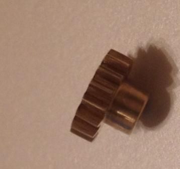

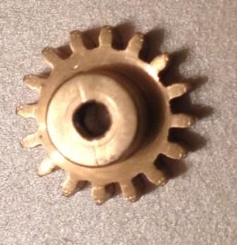

      A gear I made by machine and hand profiling, not the best pictures. But what do ya think.

          If its as small as the grain in the paper suggests, very good, although the teeth may be a little thin.

            Posted by Stub Mandrel on 24/09/2012 20:44:07:
            It is quite small 10mm total depth shank is 8mm and the gear is a fraction over 17mm, I didn't have the correct gear cutter at the timeso i had to improvise!(slitting saw and various files) It's only for the steering on a large scale vintage boat. I tried running it with the damaged gear whilst it was in the lathe it all seems ok and at reasonably high speed. I think this will be 360 degree turn and back at most so can't see a problem. I've now picked up more gear cutters so will make another, but I was just wondering what people thought as it was my first attempted at gear cutting

              Here we go again! Another post half covered by Ad's. Sorry about that rant Jon, the gear looks good
              for a hand cut job. I once cut a 2 1/2" ratchet wheel 60 teeth, with a piercing saw and file.
              I cut such things on my mill nowadays.

                I'v only cut a couple of gears, both with a fly cutter ground on the bench grinder, to as near as I could get to a similar gear, they worked OK, and proberbly no better or worse than yours, I'd say for what its to be used for, quite adiquate. Ian S C

                  For a hand shaped gear, that's a very good result.
                  In theory you could generate the teeth using multiple passes of a slitting saw… many, many passes!

                    Or it could be done with an end mill/ slot drill. Ian S C
