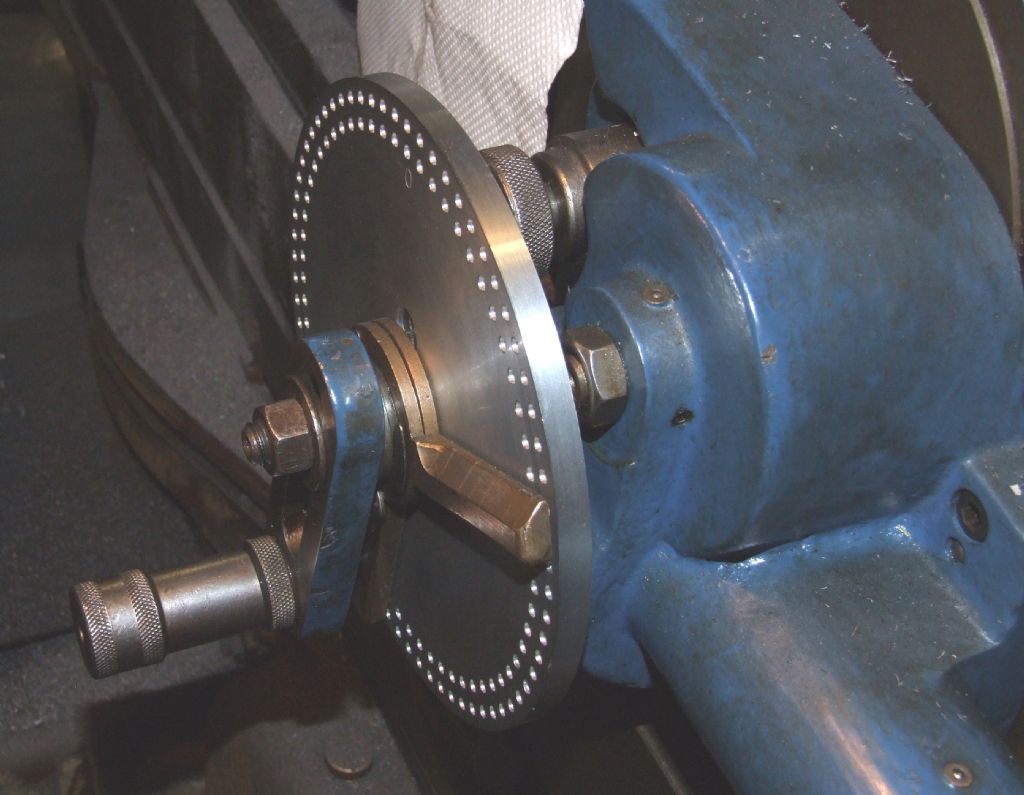

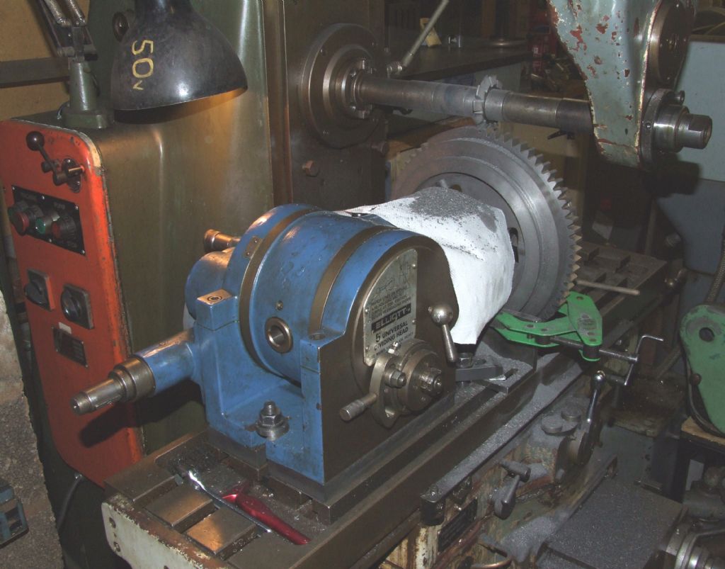

                  No need for a spreadsheet; the basic premise is correct. Although I could have used differential indexing I chose to make my own division plate when I needed 63 and 69 tooth gears for my traction engine. Here's the division plate:
                  Dividing Plate
                  The holes were done using the bolt circle function on the DRO, but that's a convenience, not a necessity. The division plate in place:
                  Division Plate
                  And gear cutting in progress:
                  6DP Main Gear
                  It is correct that any errors in individual holes are reduced by the worm ratio of the dividing head. Overall the errors are not cumulative. Let's assume a worm ratio of 40:1. For one turn of the work the dividing plate handle needs to make 40 turns. So the holes on the division plate representing the number of teeth on the gear will be spread over a linear length equal to the circumference of the division plate times 40. But the gear teeth will only be spread over a length of the gear circumference, usually a much smaller distance. So any errors in the position of the holes are reduced.
                  The errors are not cumulative. After 40 turns the detent on the division plate handle will be back in the same hole that it started so, in theory, no error overall. Any errors in the other holes may wander about but will cancel out over the whole cycle.

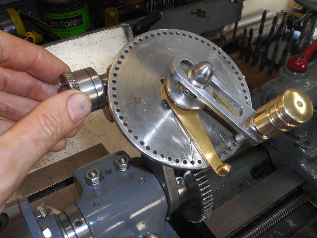

                                    Another alternative might be to make yourself the "micro-adjustment" accessory from GH Thomas's Versatile Dividing Head. Using his basic design it could be adapted to fit any existing dividing head. In essence it consists of a small 60-tooth gear attached to the back of the indexing plate, driven by a suitable worm with a graduated handwheel (100 divisions).
                                    So you turn the conventional handle the required number of turns, plus number of holes in the index plate, then use the micro-attachment to advance the indexing plate by a fraction of a hole, which takes the main handle with it and rotates the main spindle by that tiny extra amount.
                                    Using a 60-hole circle on the index plate plus the micro attachment, you can make any division within one thousandth of a degree.
                                    Details in GHT's book "Workshop Techniques".
                                    Some pics below of the VDH micro-attachment in action making the full set of three index plates for itself, generated from scratch using the single 60-hole circle that was itself direct indexed from the main 60T gear on the main spindle.
                                    Edited By Hopper on 21/12/2018 06:36:19
                                    Edited By Hopper on 21/12/2018 06:41:48
