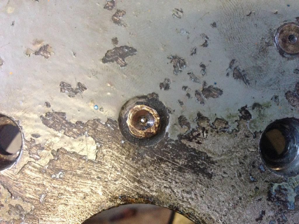

                            Hi guys, can anyone inform me how to oil them small brass oil access points with a small sprung loaded ball in the centre, they drive me nuts trying to get oil into them with a oil can😡 Are there proper oil cans for them🤔
                            Regards Rob.

                                    Bazyle
                                      @bazyle
                                      Do you mean like a grease nipple?
                                      #272266
                                      Robonthemoor
                                        @robonthemoor
                                        Posted by Bazyle on 16/12/2016 19:32:13:
                                        No, not like a grease nipples. 1/4" Round brass indented with a very small sprung loaded ball in the centre. Some work by putting the oil can nozzle into the centre & pump, others the oil will not go in, I assume they pull out to clean them, or put the airline down to clear the path.

                                            Posted by Robonthemoor on 13/12/2016 16:48:42:
                                            Regards Rob.
                                            I use an oil can with a pump and nozzle.
                                            Mostly pushing the ball in with the nozzle and working the pump handle injects a shot of oil just as you would expect. But some of my oilers act like a clack valve when pressure is applied. These oilers work OK when the nozzle is angled slightly so that oil can get round the ball.
                                            I don't think you're meant to squirt loads of oil through them; they're for frequent small doses.

                                                David Standing 1
                                                  @davidstanding1
                                                  Posted by Robonthemoor on 16/12/2016 13:26:47:
                                                  No not that type. The brass dome endented type with a spring loaded ball in the centre
                                                  Please post a picture of one of the oil nipples in question smiley.

                                                  Robonthemoor
                                                    @robonthemoor
                                                    This type, I find them very annoying😡Oil nipple
