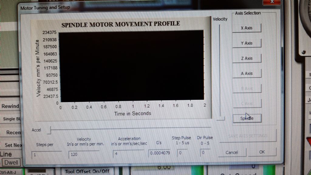

                Hi Sarah I just realised that I gave you the Z axis motor info not the spindle motor info duh!
                So here is my spindle motor info for my KX1
                Steps per = 1
                Velocity = 120
                Acceleration = 4
                G's = 0.0004079
                Steps pulse = 0
                Dir pulse = 0
                Same caveats apply, they work okay on my machine and I am useless on computer stuff!

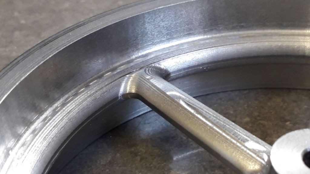

                              Hi Nick. yes I'm getting to like it, still won't be getting rid of the manual machines but the CNC does open up the options available and enable some projects that may not have seen the light of day be brought forwards.
                              For the current engine that I'm working on I wanted a flywheel with quite a wide but thin rim and oval spokes tapering in width and thickness .
                              I have often used cast flywheels from other models but could not find anything to suit. Fabrication was an option but by the time I had sourced some thick wall tube, a disc to cut the spokes from and added something to beef up the hub area it worked out cheaper to go for the solid option so I ordered a 30mm length of 130mm diameter EN3 steel.
                              I decided to rough it out on the lathe and manual mill leaving material on all surfaces.
                              i did a dummy clearing program to mimic what I had done on the manual machines so that the CNC would not try and remove the metal again and then a clearing program was run starting at the height of the "disc" with a 1mm stepdown that left a finish like this
                              Then a finishing ramp with 0.2mm stepdown to give the draft angle to the inside of the rim and hub and then carry on down further to shape the spokes with a 6mm dia R1 tool
                              It then just needed a bit of fettling with the Dremel to blend the 0.2mm steps and I also added the bits to make it look like a 2 part flywheel.
                              A couple of coats of filler/primer and it's ready for colour.
                              Looks like I won't be needing many castings in the future.

                                  That looks great Jason – lovely job. Did you have any issue with the milling cutter going blunt part way through? Andy
                                  #464894
                                  Anonymous
                                    Looking good. thumbs up
                                    I might make one change. Using a 6mm ballnose cutter instead of a radius tip cutter would have given a better finish for a given stepdown, especially on the more vertical surfaces. Ideally one would vary the stepdown according to the slope of the work. Does Fusion360 have a command for scallop height rather than stepdown?
                                    Andrew
                                    #464909

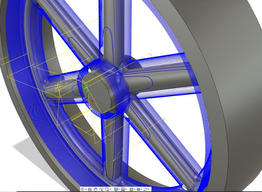

                                      That's interesting Andrew as it was the more horizontal surfaces that showed the 0.2mm stepdown most with the finish getting better the more vertical the surface became, this image should come up larger if clicked and shows that near the tops of the spokes the step was most obvious
                                      One consequence of using the RAMP path is that the tool just drops 0.2 mm over the "loop" be that once around the inside of the rim or once around each triangular cutout without any other options. You can see below how the tool made very few passes (blue line is path of tool) over the top edge of the spoke resulting in that long triangle that can be seen in the photo above.. I could have divided the job up into say three heights and set a finer stepdown for that area at the top of the spokes and maybe more than 0.2mm for the first inside of the rim as that is almost vertical (3deg draft angle)
                                      Had I used the contour option where the tool moves around at one height then steps down then that has the facility to "detect shallow areas" and gives the option to set a different stepdown for those, as far as I can see there is not "distance between cuts". The pic below shows the greater number of passes over the shallow tops of the spokes when detection is enabled and set at 0.05mm stepdown. Only downside is it takes a lot longer to run and certainly longer than it took to Dremel the surface. Add to that the need to adjust feed for the slow moving middle of the ball nose cutter and it would be even longer I suppose if it was to be a bare metal surface then that would be the way to go but as it is supposed to be a painted "casting" then a bit of irregular hand finishing suits more.

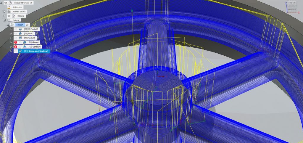

                                          In Fusion 360, Steep & Shallow toolpath strategy seems to give good results for this kind of job.
                                          Martin.

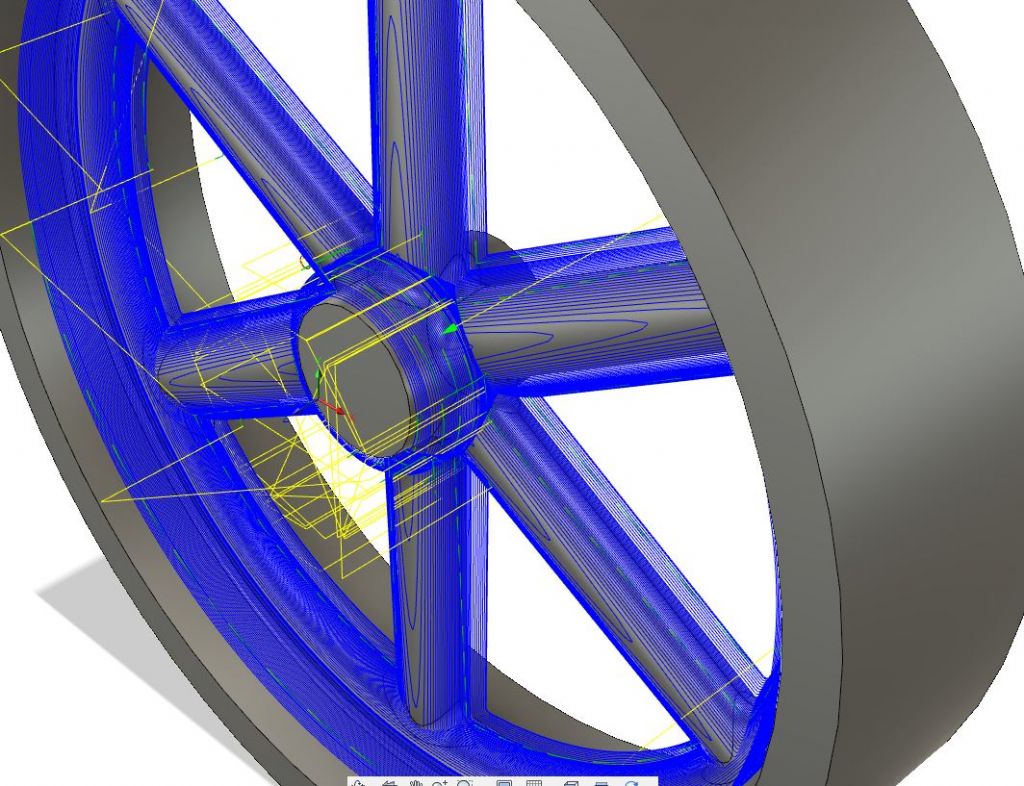

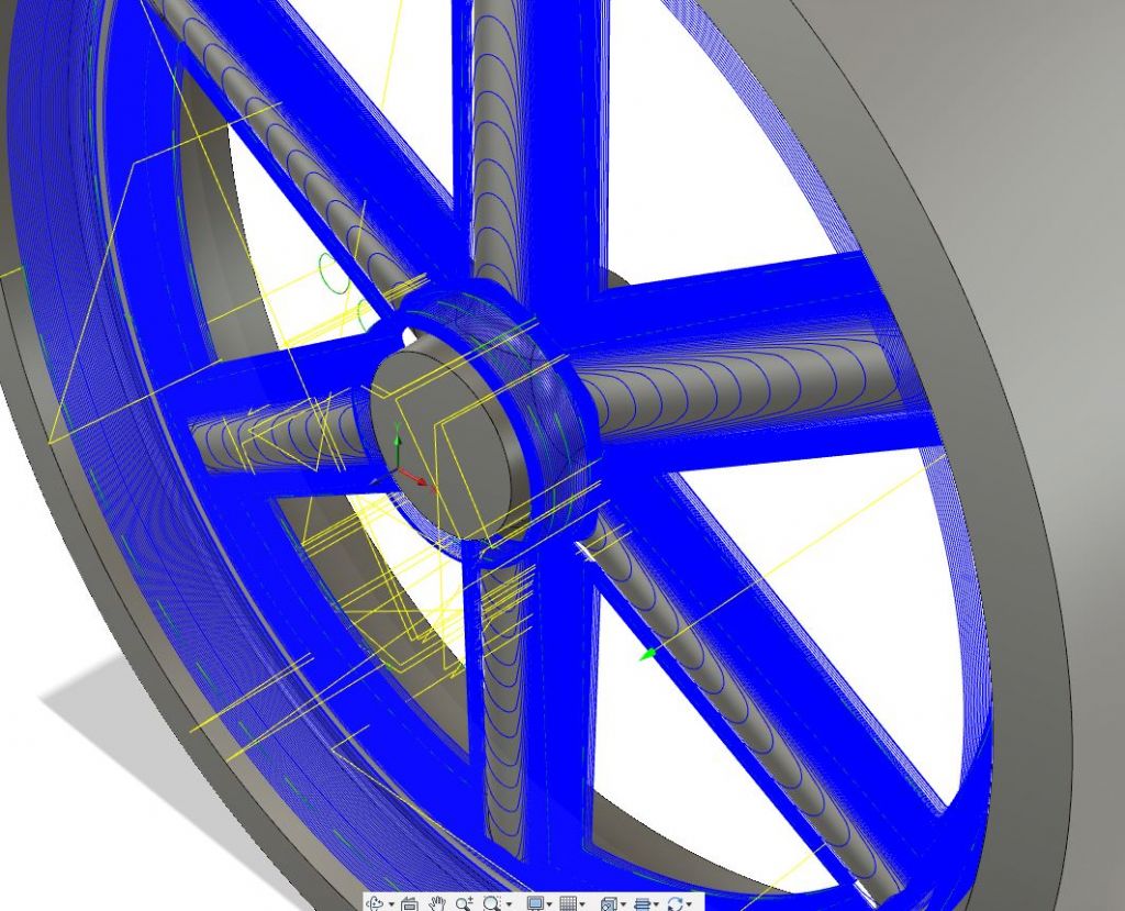

                                            Yes looking again there is the option to set a max stepover, pic below shows the effect of setting that at the same value as the stepdown which gives the path shown below which is somewhere between the two examples I posted above.
                                            Fusion does have so many features that it takes a while to find them all, not helped by only using the CAM for a couple of items per month, with more use I'm sure I will become more familiar with it and not choose the Ramp option for parts like this well certainly not the spokes as it was ideal for the inner edge of the rim.
                                            Muzzer who now posts on MEM also mentioned about using a 3D model of the roughed out part as the stock which would have been useful as I could have set the six holes as entry points as it was I just used a steep ramp angle and large dia to save time as the tool ramped down into the metal it thought was there.

                                                    Well I think I may be getting somewhere now, Fusion suggests that the contour and ramp options which I was using are best suited to vertical or near vertical surfaces which probably explains why my horizontal ones were not ideal. I have found another option that they call "steep & shallow" which allows you to set stepover on horizontal surfaces and stepdown on vertical as well as "scallop" that Andrew mentioned.
                                                    Quickly entered in the same tool and 0.2mm values the results give a different tool path which sees the tool running along the length of the spokes much like Barrie said he would use and the simulator shows that leaving a much better finish, time is a bit longer but I could likely up the distance on the near vertical faces to compensate and would also gain a bit of time back with less Dremel work. I'll be trying this on the next suitable part. Pic of the revised toolpath.
