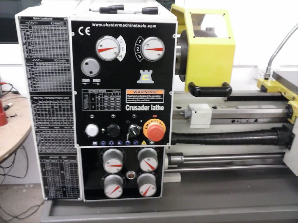

      So having battled the thing into the shed, cleaned it, got it on the stands on high tensile bolts for adjustment, levelled it patiently within the scope of quality ordinary levels – it won't run.
      Now either Im doign soemthign stupid – which is entirely possible – or I have a fault that isn't easy to trace.
      This is a chester crusader delux with all the add-ons. I did wire in the coolant pump last night and when I couldnt get the chuck to run I switched that on just to see… whereupon the shed consumer unit prompty tripped.
      For the moment I've disconnected that and checked that my wiring was to the right colour codes and sheathed the ends in insulating tape.
      As I see it the lathe has a safety cutout on the end belt guard. A cutout on the chuck guard. And a cutout built into the emergency switch. So assuming I have it right the order of operation is check the guards are in use, Power on at mains.. when a white power light on the panel comes on. rotate the emergency switch so it pops out and then the thing should run assuming speed and gear selections are meshed when the red handled lever goes from neutral to forward or reverse spindle? There's also a jogging button that doesn't work.

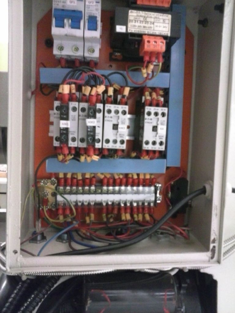

      I have pulled the panel off the electrical board at the back.. and then stared in dismay at the neat mass or wires in there. there are two trip switches..one double and one single neither of which had tripped. With the thing under power I've run a simple tester that picks up voltage in wires (the sort of thing used for checking walls) and there is no pwer going to motor or through either end guard switch or chuck guard switch. I'm loath to pull all the levers and uttons off the front to access the ack of those switches without having called chester first – and of course they're closed over xmas.
      Hopefully (long shot) I'm missing something obvious??. I do get power to the lamp and DRO and obviously that coolant pump.
      my best guess since neither main lever nor jog work is that it's the emergency switch or it's wiring. Does that make sense?

          Not sure if it is similar, but in My Warco GH lathe there are 2 fuses off the 24v transformer, one for the lamp and the other feeds the control/interlock circuit. Check that the fuse is ok.
          If you take an insulated probe you should be able to push in the contactors for fwd rev to prove you can get power to the motor,.
          Check for 24v at the jog switch, if this is not present you have a control circuit problem.
          post a pic of the control panel and if it's there the wiring diagram off the inside of the control box, will help advising further.

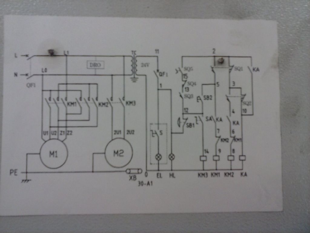

              After closing the covers guards etc did you check tha the interlock switches actually closed. I've seen one instance where the changegear cover switch was a sort of cam affair that needed a tweak.
              Do you have a circuit diagram? If you can find the equiavlent machine on Grizzly their wiring diagram will be in colour.

                Page 82 starts the wiring it's the G0750 but with a few trivial changes like puting the switches left to right instead of right to left.

                  Does sound like problem with interlock circuit. If your using detector for picking up voltage in cables in walls, I'm pretty certain that would only detect AC. Interlock circuit should be 24vdc. You won't detect any voltage in motor wiring until motors actually turning.
                  Usually you can hear a click as each interlock switch physically closes. Try moving closing each of interlocked guards In turn and listening for noise as switch closes. If one doesn't make any noise it might not be moving switch enough to trigger it.

                          What happens is the 3 or 4 safety switches daisy chain around the machine. Usually on this type of machine with the panel on the back the chuck guard is usually first, then it goes to change wheel switch, e-stop and then brake switch.
                          Not always in that order but you can usually spot where the circuit starts and where it comes back in. If those two terminals are bridged it takes the whole safety circuit out of the equation.
                          I am not saying bypass this to run this way but if it's taken out and it then runs you know where the problems lies and it's even possible to isolate each switch in turn to find the culprit.
                          Whatever happens on machine wiring it is a logical process. No good just diving in and then diving somewhere else.

                              Ok your control circuit is 24v AC. Wall type tester probably wouldn't pick up that low an AC voltage, which you've confirmed by trying it on the wires to the power lamp when it's on. I'm guessing the interlock switches are the ones label SQ1-5 on the diagram. Are there any labels on the actual interlock switches?.

                                NICE workshop. Well the circuit diagram is more like the real thing and quite straight forward with the control circuits on 24v ac. Having gone back to your original post a bit concerned that you popped the circuit breaker in the first instance. It looks like there are 5 safety switches which are SQ1>5 on the diagram and all need to be closed in order that relay KA closes and allows the contactors KM1 or KM2 for forward or reverse. KM3 looks like the pump contactor. Have you tried it again without the pump being connected?

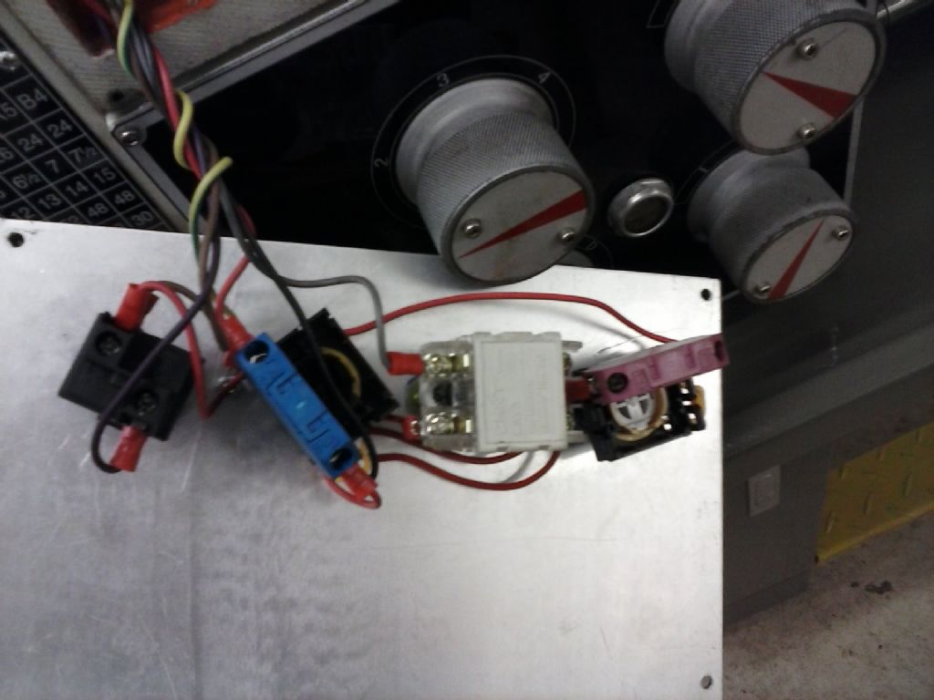

                                    None of the accessible interlock switches (brake, gear cover, emergency stop) have any SQ-type labels.
                                    I disconnected the power wires to the pump and wrapped in insulation this am and operating the pump switch now does nothing (or trip anything).
                                    Yes it is brand new..just installed so the thought of taking it all down for a return to shop is pretty daunting. Chester should be back at work 2nd Jan and obviouslyy i'll call them. I would be quite happy to drive back and be shown in person how to bypass each item….
                                    It was the main RCD for the shed units that tripped, not just the one 13amp circuit but not the internal trips on the lathe.
                                    Without a way of measuring across the interlocks I'm stuck – even if I thought I knew what i was doing.

                                        The online version of the manual has a different circuit diagram……………
                                        The main circuit breaker trip is quite possibly just it not liking the inductive load which is not an uncommon problem. You might anyway try wiring the coolant pump to a normal plug to try it out. And make sure your lights are on a seperate circuit.

                                              Success!
                                              Well some anyway. I do worry at problems and it occurred to em that fiddling with the thing under power when i didn;t know what i was doing was unnecessary. A simple battery and buzzer checked the front panel swtches and the main cover interlocks. then i realised that John Bogstandard had it right first time. I'd failed to appreciate which way the brake switch really worked and that explains the original finding of a chinese fag-butt in there (to close it so it ran). A bit of a bend to the brake lever mesh with that switch and it operates as it should.
                                              So I now have a spindle that goes around. Getting the gearbox and feedscrew to work was another fiddle… hopefully just 'cos its new but I had to manually rotate the gear cogs to get the levers to mesh and feedscrew to finally run.

                                                The learning curve will go on. I've run it through all the speeds and gears.. and I'm seeing a colour change to the oil in the sight glasses.. so that'll get changed when it's had a decent run
                                                I've figured out the leadscrew and feedscrew but the leadscrew reverse lever seems to engage a gear but the leadscrew (threading) doesn't run backwards. Any clue? Something I'm not doing?
                                                The other thing i can't find is how to zero the feed dials. Not particularly an issue with the DRO unless it dies.
