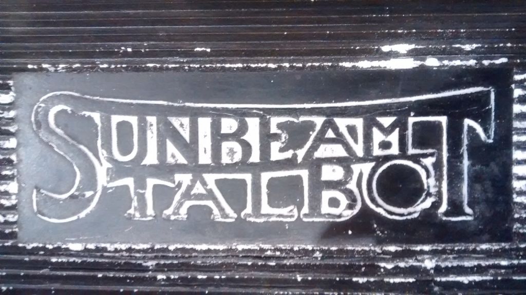

      I need to reproduce a motorcycle part dating from 1910. This incorporates the makers details in a fancy script. I have searched MS Word and Photoshop for fonts but nothing matches. Is there anywhere I can search for more fonts?
      If this fails I think it should be technically possible to reproduce the script by 3D scanning then converting it somehow to some sort of CNC process – can anyone give me an outline of how this can be done?

          Charles: can you post an example of the script – a photo would be great – then we might be able to find a suitable font. Also it would be handy to know how the lettering is to be applied to the component. For instance, is it etched into the surface? Would Letraset dry-transfer lettering be of any help, if only to provide an example of what you want? You can see their fonts catalogue in PDF format at www.letraset.com/pdf/LETCAT_FONTEK.pdf

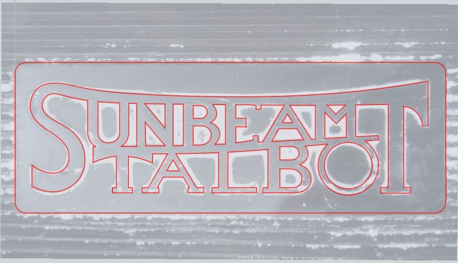

                            Many thanks to all those who contributed to this thread. The component is the top of a Brown and Barlow carburetter control lever dating from 1910. Obviously a photo would reveal all but I am new to the forum and have not yet mastered getting a photo onto this thread. Obviously some of the contributors to this thread are knowledgeable about old motorcycles so may know this type. This script/type whatever is very close to "Edwardian script" that is popular for formal invitations etc. but rather less "florid", not a highly stylised logo like the Triumph logo.
                            It seems my best bet is to get someone to prepare me a CNC drawing from the (very good) flat-bed scan that I have. Is anyone interested in doing this for me at commercial rates? The script is on a flat surface.

                                Chas, this is something I do probably weekly. If you click on my name it brings an option up to send me a personal message and we can go from there
