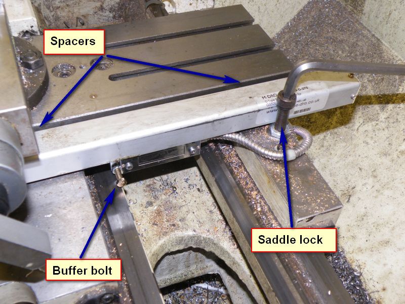

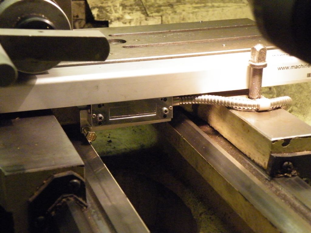

          I fitted a 2 axis DRO to my Warco 1327 lathe (same as a BH900) last year, and found it surprisingly easy.
          I fitted the cross slide scale to the right of the carriage so that it didn't interfere with the headstock end. It does obscure the carriage lock a bit, but it's easy enough to extend the screw and fit a bar to it.

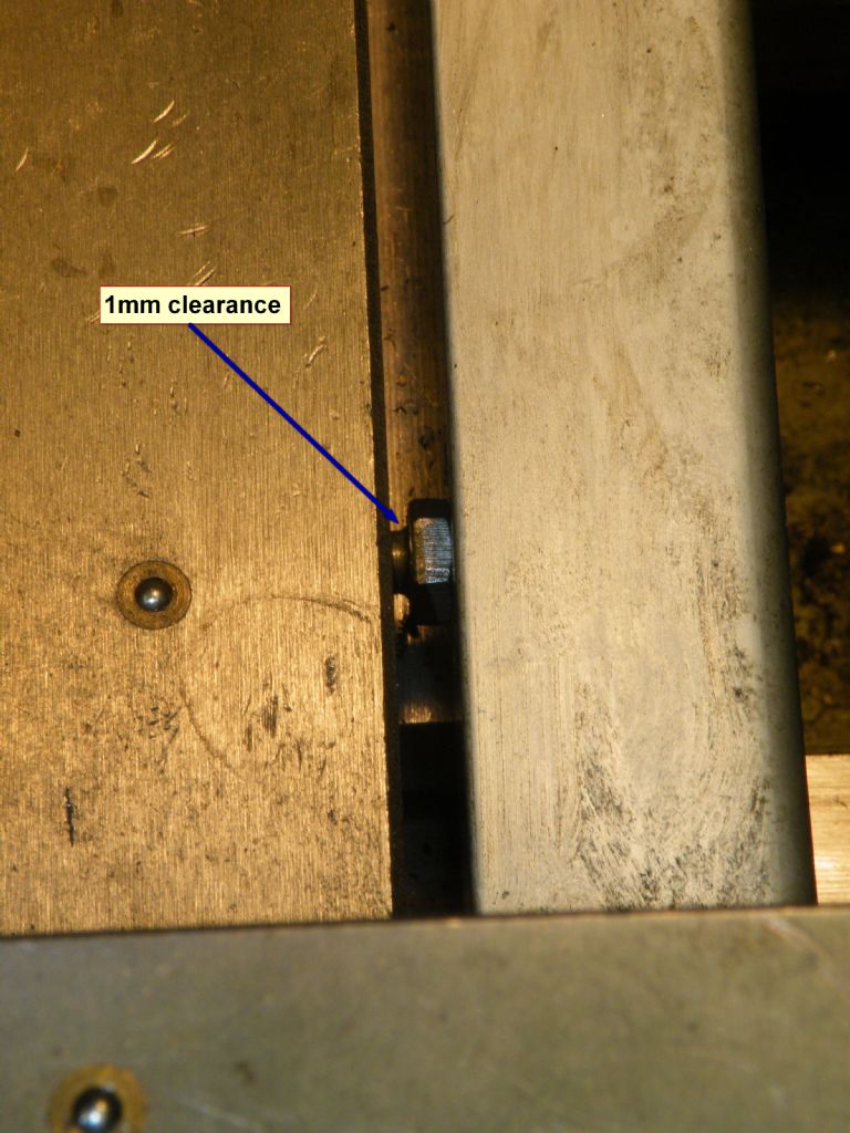

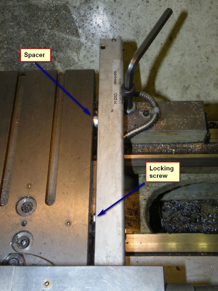

                    My Chester 12×36 GH is very similar to the GH 1224. I fitted a 2-axis DRO with the cross-slide scale on the RH of the saddle because on the LH it's very vulnerable to damage and prohibits use of the steady. There are still problems on the RHS though – it blocks the cross-slide locking screw, and compromises use of the saddle lock. The following pictures shows how I solved the problems.

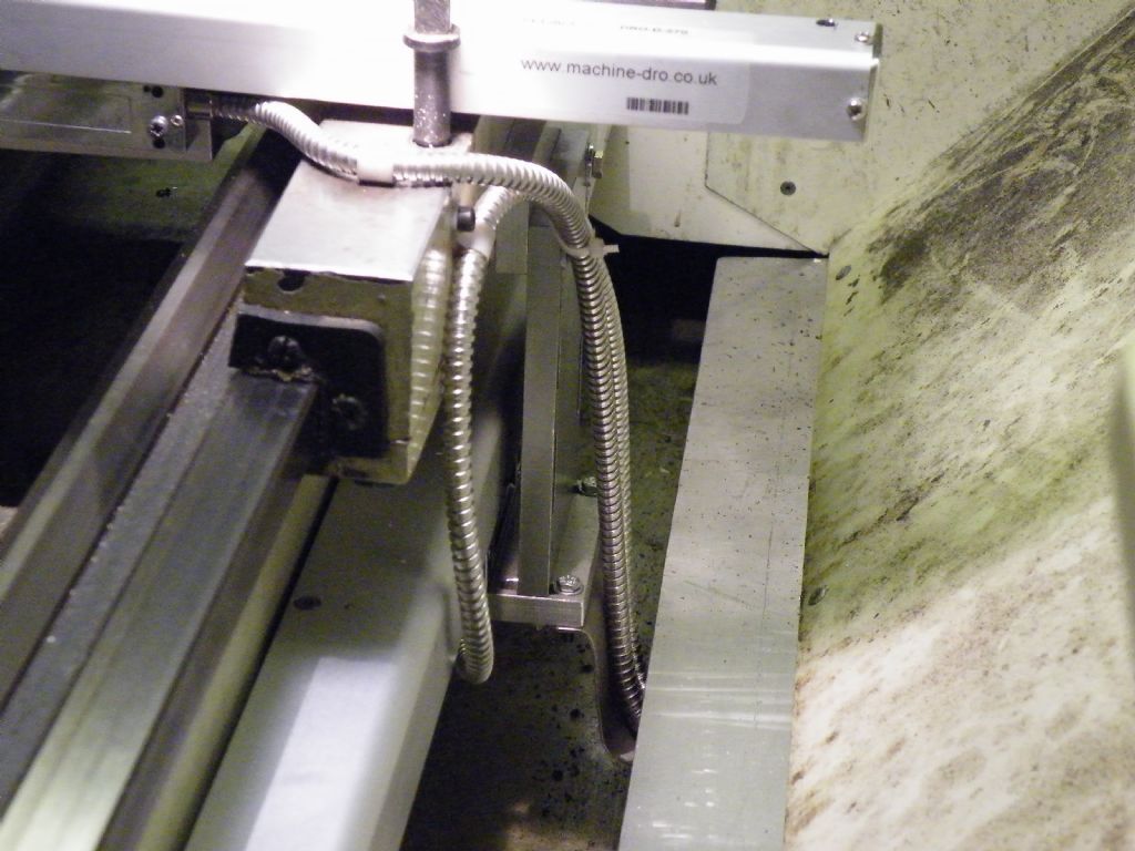

                      that's really useful, what about along the main axis are there any issues?
                      How have you run the cables in order to keep them from snagging

                        Hi Trevor,
                        Hopefully these photos show the cable runs from the cross-slide and the bed.
