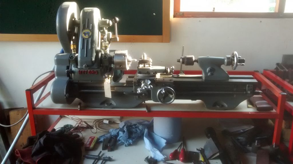

        Maurice Taylor
          @mauricetaylor82093
          img_20150513_182725659.jpgThis was what I put my ML7 on to get going ,worked ok until I made a proper stand.Its on wheels as well.
          Maurice

                          Hi William, Your design sounds very similar to mine.(Photo earlier in the thread). It is made from 50 x 50 x3mm square tube, It does not have diagonals and is very strong.The extended feet make it very stable.It is based on an MEW articlle from a few years ago.The base plate under the lathe is only 18guage steel ,the lathe is bolted to the 2 cross members. I think your price quoted is good.
                          Unfortunenately there some complications engineers on the forum that make a simple job look daunting and difficult without offering any useful help and often have a downer on things other people are doing.
                          Maurice

                                        Hi, Very similar to mine,you won’t have any problems with twisting as it is. I can’t fault any aspect of that bench. Money well spent.
                                        Maurice

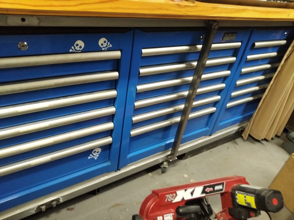

                                                    Pete.
                                                      @pete-2
                                                      Hi William, when I built my workbench, I decided to make sure it had plenty of storage for keeping things organised, so I built a steel frame with 3 Halfords Industrial tool cabinets inside, and put a 2" thick pse board worktop on it, it's pretty solid, you could park a car on it.
                                                      Bench 3
