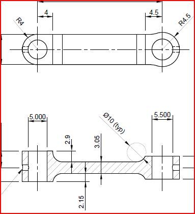

      on drawing 0009 the radius where the thickness of the conrod is reduced is given as 10mm dia typical. But the cuts and fine circle shown on the drawing is more like 5mm.
      Hopefully Glenn is watching and can confirm.

          Sorry Jason just noticed your post 9 days late after your motor is running! but you are correct I've just checked the 3D model and its a 5mm dia (2.5mm rad). Its not crucial dimension and would just add a bit of meat to the conrod.
          Well spotted ! I've uploaded an amended drawing for future ref.

            Thanks for the confirmation Glenn and also for your comments in the build thread.
            Look forward to seeing whats nextsmile
