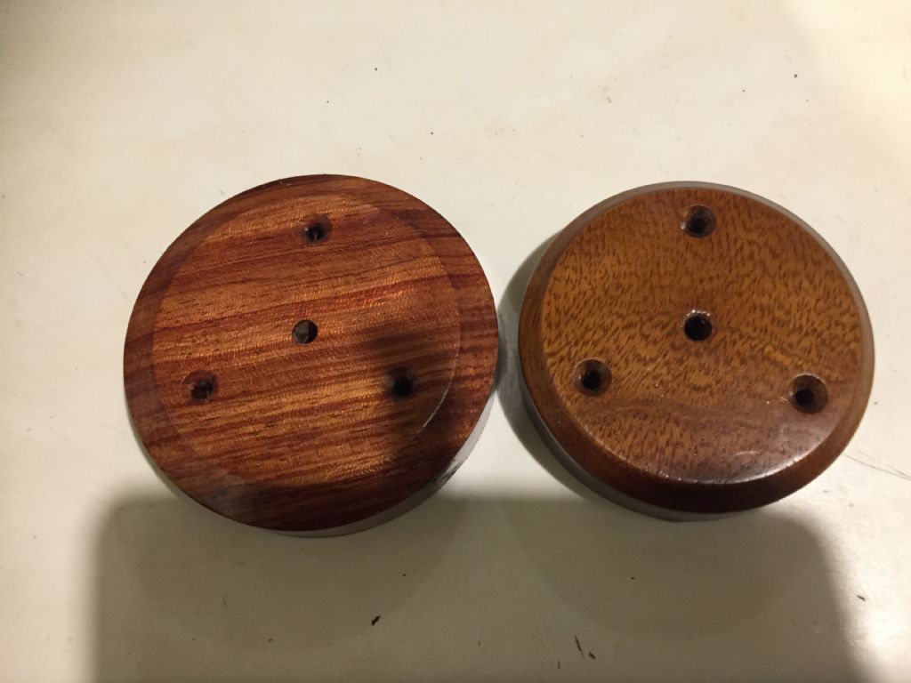

            Robin Graham
              @robingraham42208
              I know what you man about melamine – it's very durable, but does look a bit synthetic. After trying many things (in a different context) I've settled on Osmo Poly-X. A couple of wall mounting plinths:
              not finished yet but perhaps gives an idea of how it looks Left is sapele, right iroko. The sales bumf says 'alcohol resistant', but I think they mean wine. Out of interest I squirted some neat alcohol on one when I started writing – it's evaporated and not made any discernible difference to the finish.
              Might be worth a try!
              Robin.

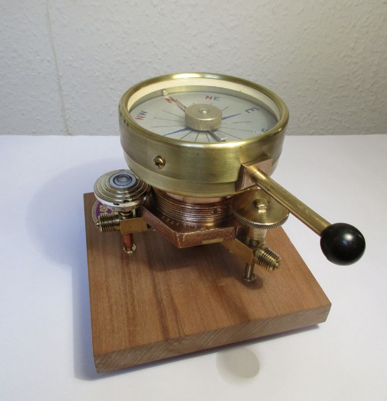

              Nicholas Farr
                @nicholasfarr14254
                Hi IRT, I used a piece of walnut from the draw front of a very old chest of draws that were originally my grandmothers. The grain of the wood looks very pleasing to me and I tried some satin varnish and some regular yacht varnish on a couple of off cuts, but both made the grain look disappointing and kind of hid some of the texture. Having had a look online of various ideas, I tried some Danish Oil just on it's own and was very please with the result. OK, it only supports a compass made in the main of brass and bronze, but I think the natural look of the oil enhanced it's appearance,
                Regards Nick.
