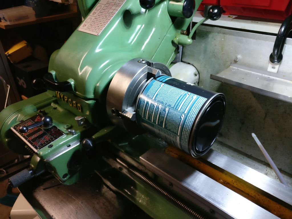

        Had to nip out to take a quick photograph. The 6 inch four jaw is very useful to me :
        #322940
          Posted by Michael Briggs on 22/10/2017 23:13:37:
          Thanks, Michael
          It's fine because the jaws are running in the gap
          … hopefully you have seen my edit, and we're in agreement.

                      Not sure what MG means with regard to MB's picture – as the jaws are inboard of the 6" chuck body OD, the jaws are not running in the gap – a Myford will swing 7" over the bed after all. The jaws are running over the gap area, but not in gap.. That configuration would run without fouling on a C3, which also swings 7" over the bed.
                      Is that a tumbler, MB ?

                        Nigel , I think Michael was suggesting that a 6" on a Myford can be run with the jaws well extended beyond the body due to the gap.
                          Mere semantics, Nigel
                          Longitudinally … The jaws are running within the gap
                          and could if necessary [albeit not illustrated by MB] be opened beyond the diameter of the chuck.
                          A conventional Burnerd 6" 4-Jaw on a backplate does not permit such flexibility of use.
                              Nigel B
                              Hello Nigel, it is just a tin of paint ! Nearest thing on hand to show useful the 6” chuck to me. Would have been a better illustration if I had something big enough to extend the jaws in to the gap as suggested by Jason. Regards, Michael.
