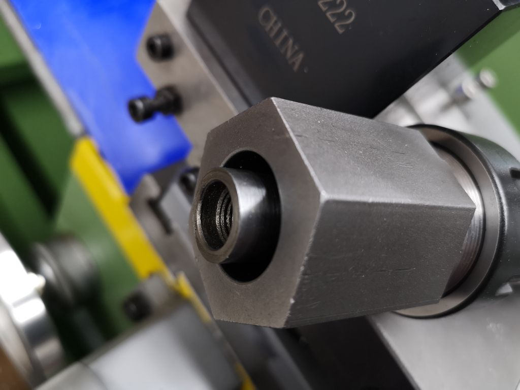

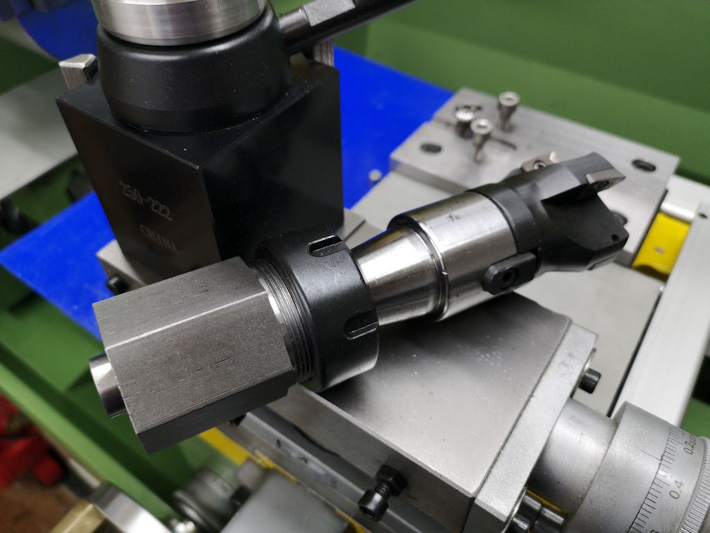

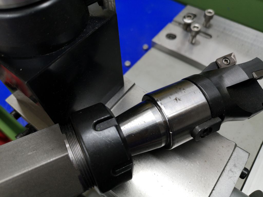

      Following my first dip into milling on the lathe (Warco WM290) I thought rather than using a spindly little end mill to flatten things I'd go up a few sizes. I ended up with this from an Amazon shop:
      It's an R8 50mm 4-cutter job. However, my thoughts were that the extra load imposed on the lathe spindle would require a decently heavy toolholder for it, so I decided to use it inside my largest ER32 collet, a 20mm one. So I set about cleaning off the insubstantial "thick" end of the R8 shank plus some off the whole length to get it down to 20mm from around its original 23/24mm.
      Unfortunately, although I got it sliding through the collet nicely I wasn't happy with the keyway cut into the shank as it was causing substantial runout due to the 70mm or so interrupted cut making the job bounce off the cutter (the arbour was fairly hard and I ruined several carbide inserts). It took another three hours of very careful and painfully slow machining and cooling off time to dispatch the slot, by which time the arbour was down to 17mm so I now had to use a 17mm collet instead. No big deal, I hope?
      Sticking it into the hex collet block it showed just 2 1/2 tenths runout on the dial gauge so I'm happy with that, but my question to the Old Hands today is this – with such a hefty stickout from the chuck, do you think I should also lop off the R8 taper to pull it back into the collet another inch or so?
      And one more question if I may. If I turned it down another millimetre it would fit into my HBM keyless chuck so I could use it in the tailstock and spin the workpiece instead. Is that a bad idea?
      Edited By Terry Kirkup on 14/01/2020 19:30:46

          This is my attempt to get around the issue that "she" won't let me buy a milling machine!
          #446619
            Would have been easier to have bought a 4MT arbor ( or 3MT and reducing sleeve) rather than R8 and simply mounted it into the spindle taper.
            Tailstock idea is a bad one as it will just make a circular depression in the work as they axis is fixed, may as well spin the work against a lathe too as that is how they are meant to be used.

              The WM290 has a 5MT spindle bore, and presumably comes with a 5 MT to 3 MT sleeve?
              If so, would it not be better be better to buy a 3MT Shell Mill Arbor, to minimise the number of parts between the spindle and the cutter, to minimise the risk of run out. One possible supplier of such a fitting is Arc Euro, with a M12 drawbar thread, and probably RDG or other suppliers would also be able to offer one.
              I hope that you were not contemplating fitting the hexagon block into the 3 jaw chuck! That would probably give you a much greater run out!

                Good grief, that's going to be flexible. I don't think you need worry about spindle loads, any sort of cut and you may well get more chatter than an Islington luvvie. And there was me worrying about whether a 50mm face mill would be too big for a Bridgeport.

                      What I would suggest for your lathe setup is a two point fly cutter. Make an arbor which you can hold in your chuck with a thick disc attached. Couple of 6mm holes in the face side of the perimeter with one at a slightly smaller radius than the other with a couple of tapped holes suitably placed in the perimeter to hold a couple of round cutters. Form the cutters in the usual way and arrange that the innermost cutter is slightly proud of the other. You then have a tool that you can stick in the chuck in seconds and will take a rough cut with the outer cutter and a smoothing cut with the inner. George Thomas did it with a bar holder in the four jaw but you said you didn't like taking your chuck off.

                          Way too much overhang, as Andrew pointed out. I would look at cutting off the tapered section all together and grip the cutter by the larger-diameter parallel section on the end in the three-jaw chuck. The closer you can get the cutting tips of the inserts to the headstock spindle bearing, the more successful your cutter will be. IE less chatter.

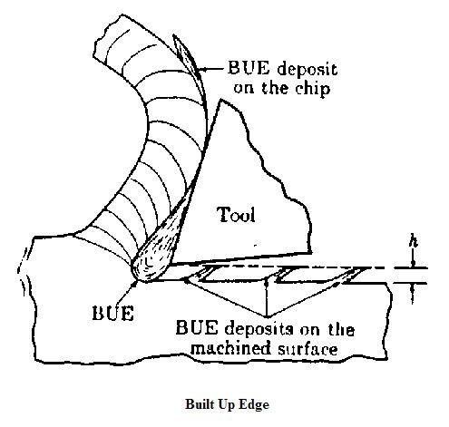

                                                  The picture illustrates 'Built Up Edge' causing rings on the the work. Could this be what's causing Andrew Johnston's recent woe in EN1A?
                                                  Lathe tools intended for finishing are often shaped with rounded rather than sharp edges, isn't that because they polish rather than groove the work? And as a final obsevation, lathes produce excellent finishes with single point cutters: they don't need multiple teeth to get top results.
                                                      Absolutely, the cutting process is shearing, not slicing. I think the tool bit may well burnish the material as it passes, particularly for insert tooling. That may explain why insert tooling sometimes works better at higher speeds. The shear zone is much hotter at higher speeds, so the material is softer and more easily burnished.
                                                      Interesting idea about BUE on my EN1A. But I'm not convinced. The tool on the hydraulic copy unit is actually upside down. During roughing the swarf fell away in a steady stream of small blue chips. When finishing the swarf had more of a tendency to produce strings, but again no evidence of BUE. This morning I've used the same holder and insert in the normal toolpost to clean up a nut I welded on to my M16 drawbar yesterday. The insert looks clean and in remarkably good shape given the duty of producing a bucket load of swarf. I've also just cleaned the lathe and it really was a bucket full of swarf!
