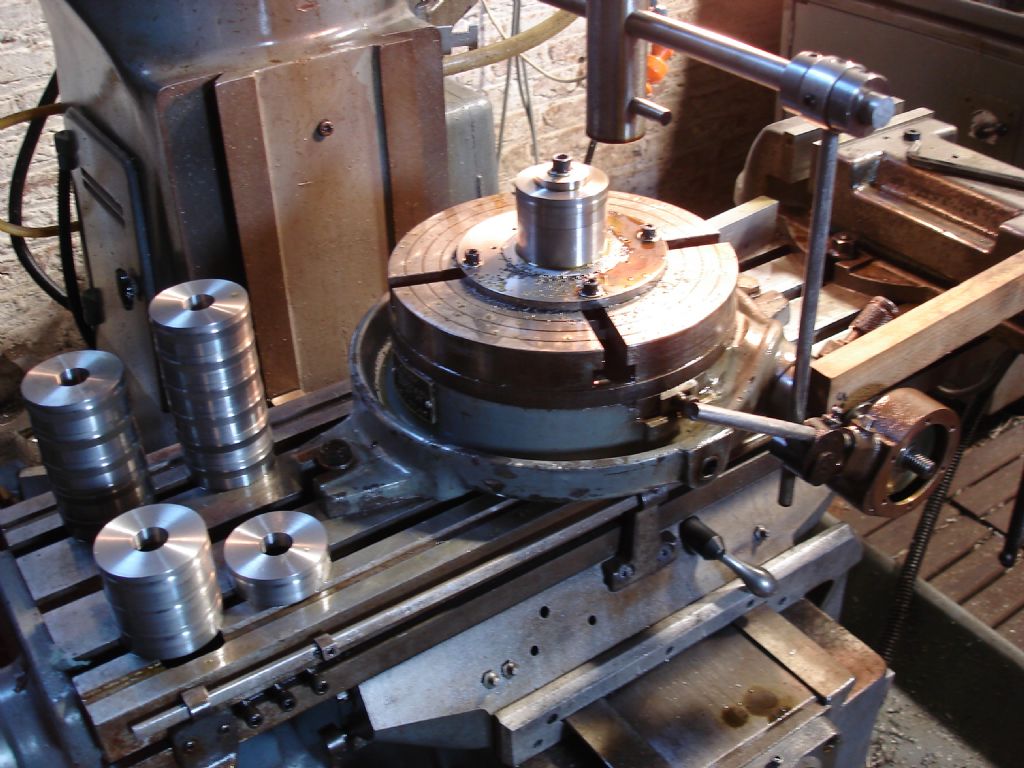

                dsc01919.jpgdsc01709.jpg dsc01704.jpgWhen I first started making the Graham Meek designed Graduated handwheel for the Myford lathe, I needed a reliable, repeatable method to produce a fine knurl on the periphery of the dial body.
                I ended up utilising the slotting head that had lain redundant at the rear of my Bridgeport mill since I acquired it. The general idea is that the slotting head behaves in the normal manner but a rod connects the movement of the ram and indexes a rotary table via a ratchet borrowed from an old steam engine lubricator.
                The original ratchet wheel was replaced with a wheel that had only seven teeth and this allowed an amount of overstroke, which in turn allows the cutting tool to clear the work before the indexing for the next cut takes place. The tool is ground to give a 90 degree tooth form and the job takes 8 minutes to complete one revolution. In this time I can prepare the blanks for this op and the finishing op when the “knurling” is complete. There are 504 “teeth” which gives a pitch of just over 0.016”. I hope the photos show the idea of the setup adequately.
                Best regards,
                Steve.
                Why this text appears in the middle of the photos, I don't know!

                          Steamer, that is a clever set up. beginning to regret selling my Bridgeport slotting head. I sold it to finance the purchase of a "Cherry Head" but that was sold when I arrived to pick it up. The dealer just gave my deposit back and walked off.

                                  I have one of your hand wheel dials on my S7 and very nice it is too! Good job – thanks.
                                  Norman
