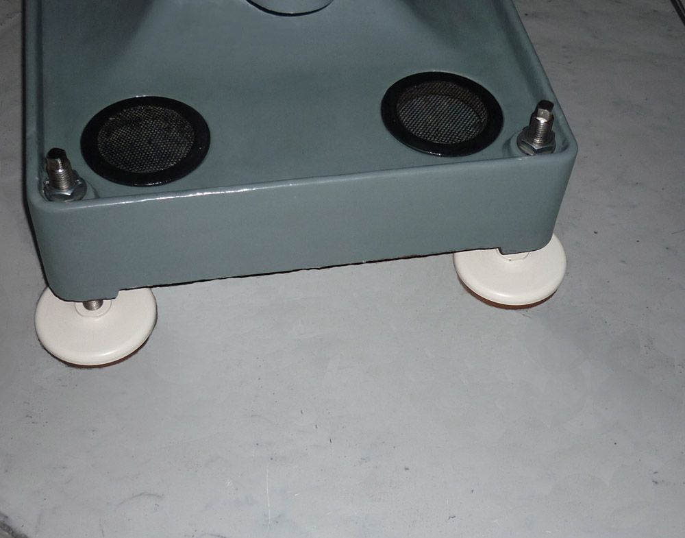

      Hi , Does any one know an easy way of enlarging 4 holes in cast iron from 18mm up to 20mm. Ive been using blacksmith drills and it taking forever and the drill is snagging all the time . The holes are almost 100mm deep . I can only use a hand drill . Any sort of special drill bits that work??

            Hi Gordon, yes the holes are being enlarged on a mill base to hopefully mount some adjustable feet which are M20 threaded.
            A masonary drill may be a good idea as there is more clearance on the sides which is one of the problems im having with the blacksmith drills.

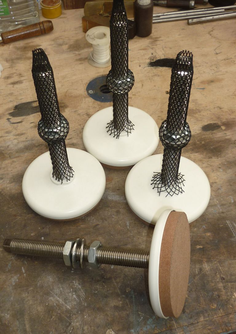

                            These are the feet im fitting, they were retailing at RS onLine for around£50-£60 for each foot plus VAT but the manufacturer is selling them off on ebay for £25 for four including postage, a deal i couldnt resist. Rated at 350 kg -400kg per foot. They are still selling them ,also in other sizes.

                                Hi David they are available here , its Nu-tech engineering who are the sellers. They have M10,M12,M16 and M20 available in this style of vibration dampening feet. Also despite what the shipping says mine came by 24 hr courier next day.

                                            Finally got the feet in ,need to level it tomorrow but its rock solid even before i do that. I like that with the large feet there is quite a bit of adjustment so i can get a comfortable working height.
                                            There was a 24mm difference in the floor between the front right and back left corners of the mill base. So the floor was miles out of level.
                                            Also because i can raise it ,it gives easy access to a pallet truck if i ever need to move it.
