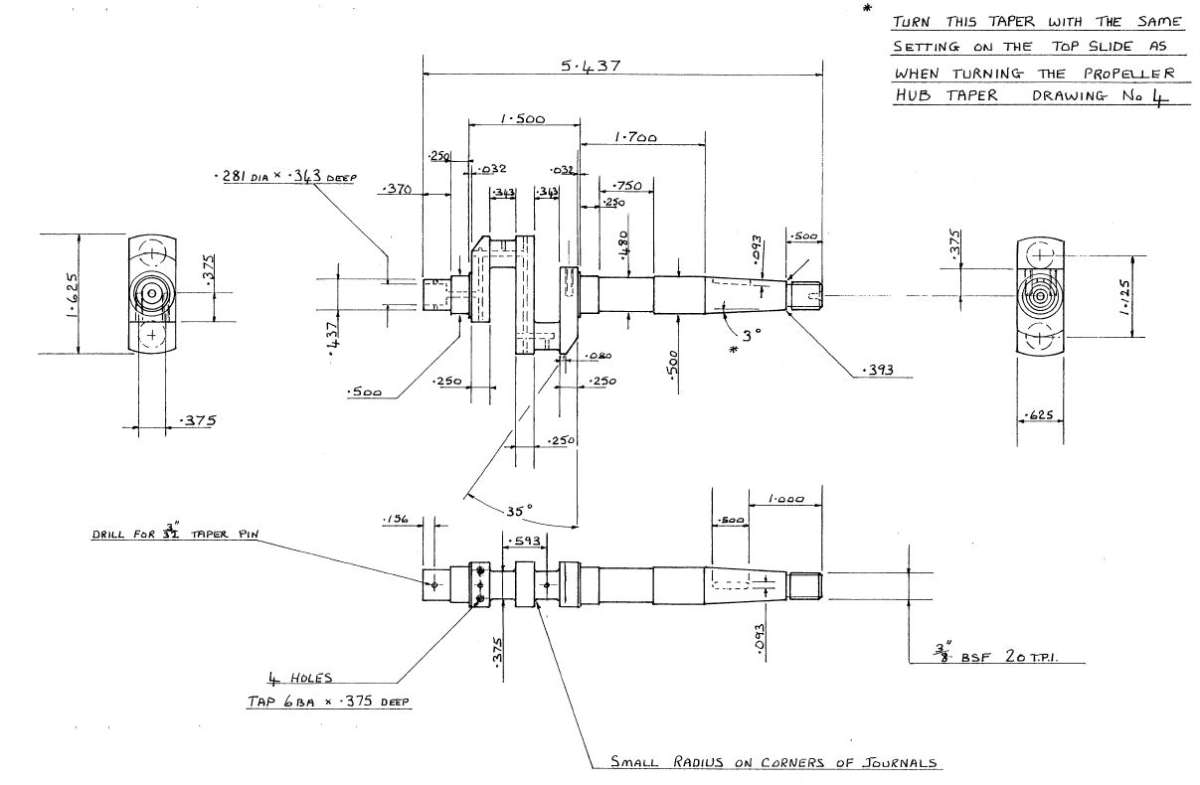

      Hi
      Can anyone point me in the direction of a supplier of en8m flat steel
      I’m looking for something close to 5/8 x 1 3/4
      Or recommend a suitable alternative for a crankshaft
      Thanks
      Dougie

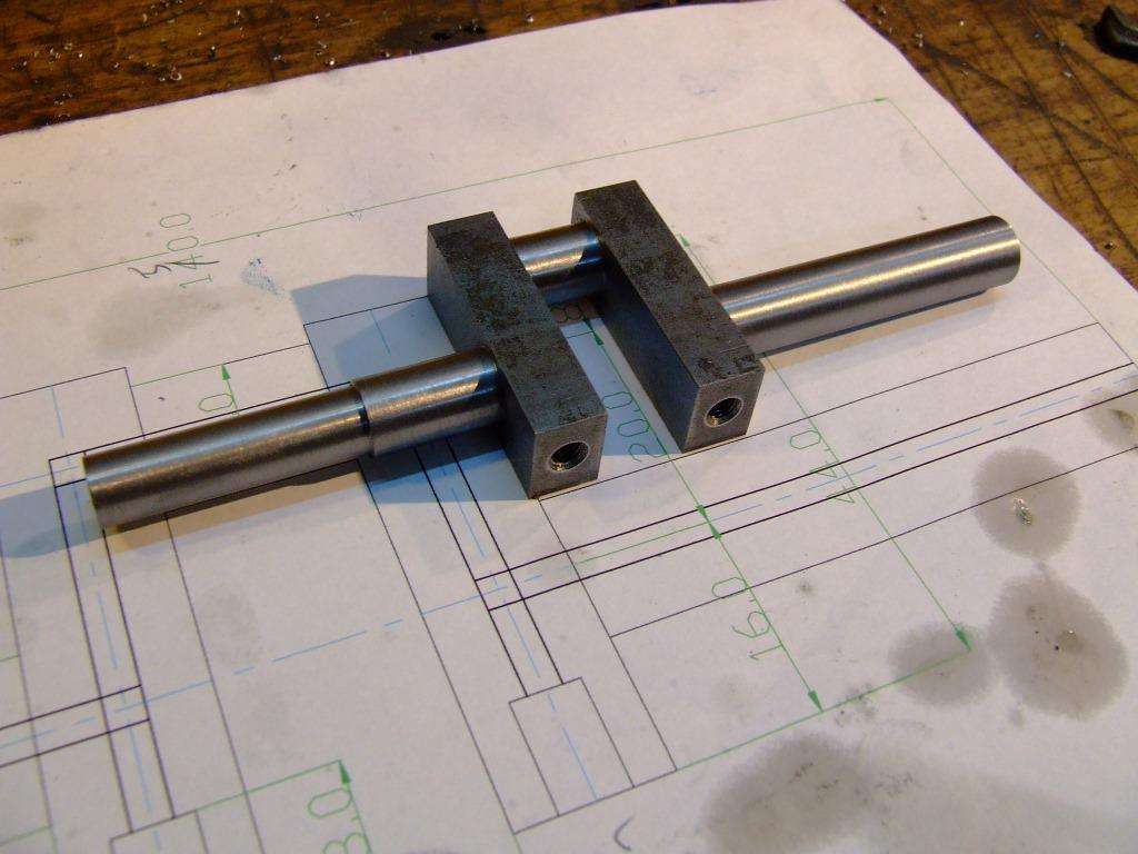

                  A lot of IC engines call for EN8 for the crankshaft and that is where I have used it. My way of looking at it is that I’m going to spend a lot of time making a crankshaft so the extra piece of mind is worth the small cost difference and having to chop it out of bigger stock.
                  Having seen the results of a backfire twist a  3/4″ PGMS model’s crankshaft it is not just crashing you have to consider.
                  This is the crank in question
                  crank

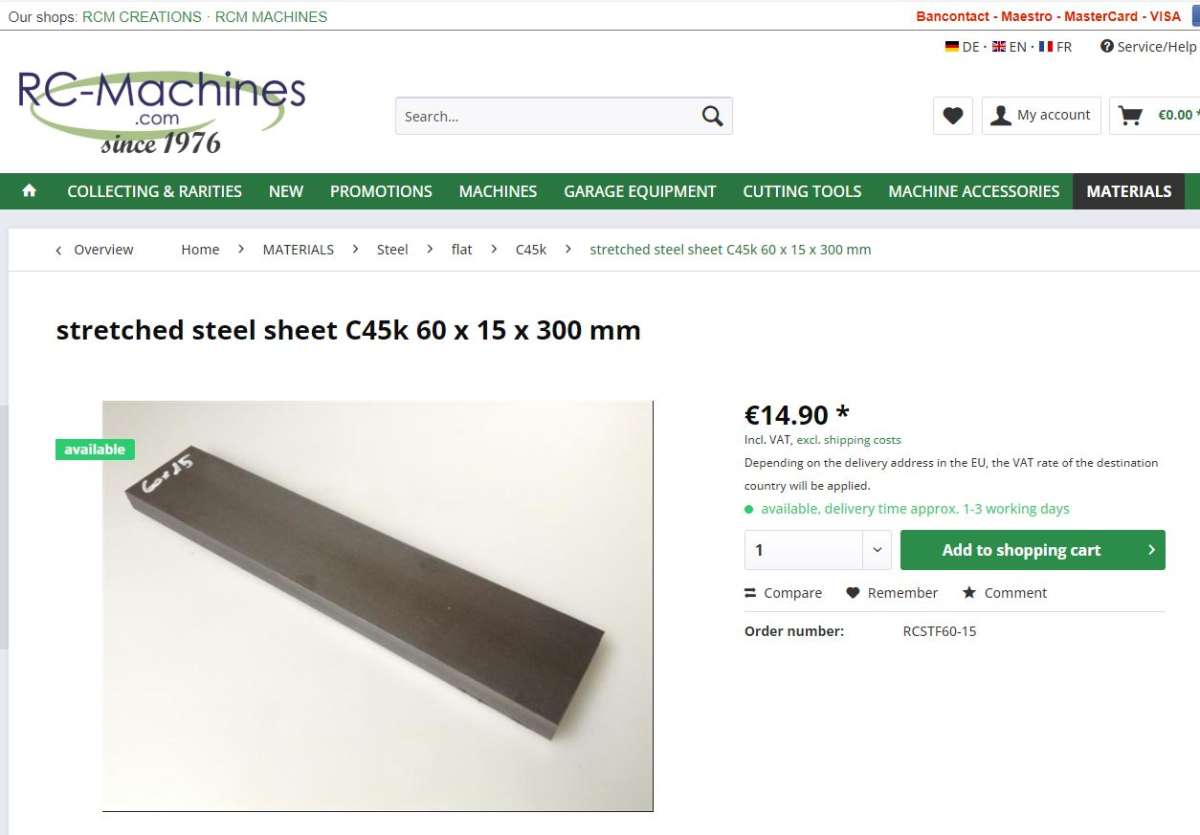

                    This C45k keysteel might be an option although it has the problems of odering from outside the UK:
                    https://www.rcm-machines.com/en/materials/steel/flat/c45k/stretched-steel-sheet-c45k-60-x-15-x-300-mm/rcstf60-15
                    RCM
                    I have used this for several crankshafts including a 20 cc diesel with a compression pressure of ~40 bar. It also survived ingesting a M3 grubscrew.
