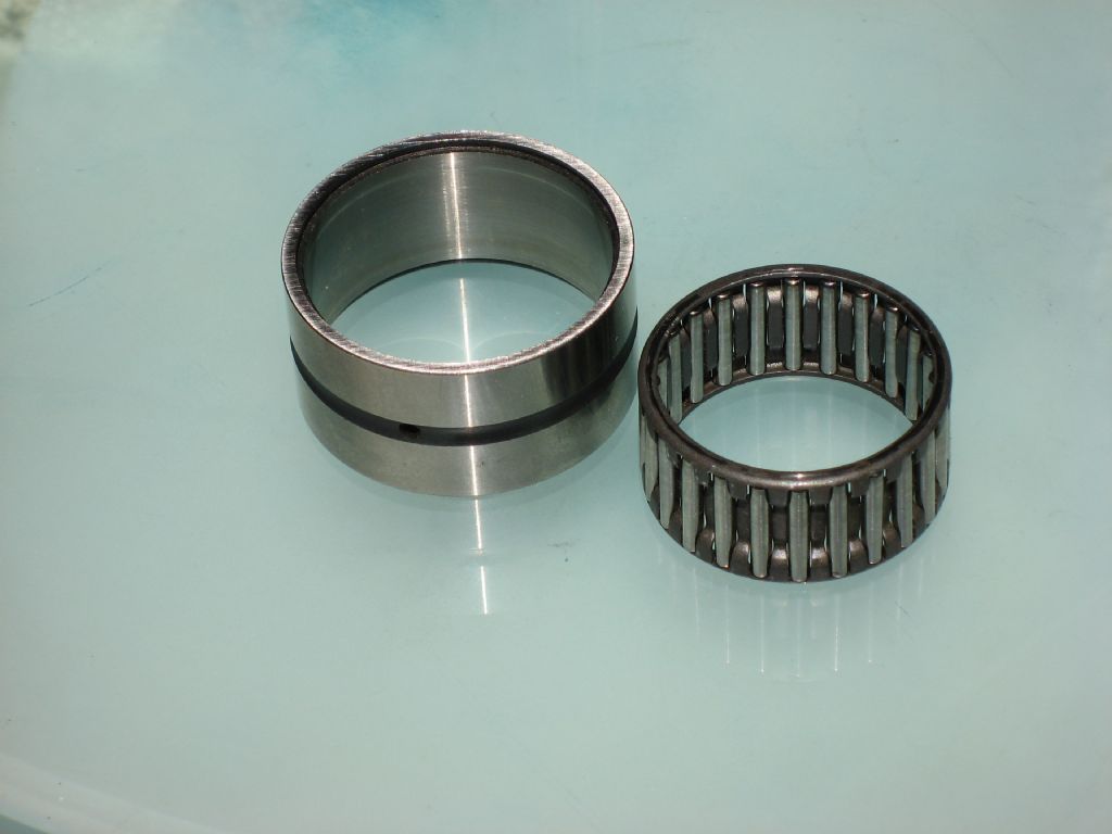

      Following up on my ”Quill fit improvement” topic I have uploaded some pictures of the spindle that came out of a machine I bought recently.
      The photos are in an album I have just created but I am not sure how to link to it but I think I named it ”Emco Mill Pictures”.
      The spindle is about 200mm long overall and the front needle roller journal is 30mm diameter, the section between the bearings is 29.5mm and is about 60mm long before the 20mm diameter seat for the upper pair of angular contact races.
      In the section between the bearings the spindle is bent! Or at least its distorted in some way.
      One picture show the pitting and uneven wear on the front track and another shows the fit of the MT2 adapter.
      The adapter that came with the machine is a high quality Swiss, Schaublin item and if I put it in the spindle taper and rotate it with slight pressure it has a very distinct uneven rotation as if the adapter as well as the bore is ovel in some way.
      I doubt whether the machine is robust enough to have the force and inertia to bend the spindle whilst in even abnormal use, but I have now spent some time examining the spindle and can definately say the that the two bearing surfaces are not in line, and the taper bore is not truly concentric.
      Ian

          What a horrible design.
          I have a genuine Jacobs revolting centre that is the same as this. It has very slight play in the needle roller bearing and so the whole assembly is junk in that there is no adjustment or means to replace the lower / front bearing and or tracks.
          Same applies here
          In this design it has a pair of angular contacts at the top where they are doing the least good.
          Is this the Australian export model ?
          I was going to suggest you make a new spindle using the existing quill but from your previous post you have problems with that as well ? Probably best to bung it on Ebay and replace the whole machine

              Well that’s an honest opinion of Emco’s design!
              You are right though, having a non adjustable needle roller at the bottom end of the spindle is a flawed idea, One of my rotating centres actually has an adjustable parallel needle roller bearing which is what Emco could have done.
              I have now made a completely new spindle for the same quill body so it now has two conventional taper roller races. I’ve done away with the MT2 bore and have an integral ER25 taper. The loss of the Morse tapers is easily overcome as I will make a drill chuck arbour with 16mm parallel stub, any other tooling, like a fly cutter I will make to suit anyway.
              I was unaware there was an antipodean version of the mill, but its not impossible.
              Because the slides and basic parts of the machine are in such good condition I want to solve the problem of the slack quill and I will then have a nice machine. I did consider selling it on Ebay or whatever but I would be duty bound to describe it honestly which would limit what it might sell for.
              Ian

                The quill design of the mill has nothing in common with the SL other than the external appearance of the body. I am not sure what you mean about roller bearing issues with the SL lathe, as that had angular contact ball races, actually the SL mains spindle was quite adequate for its purpose and mine has had hundreds of hours use (and abuse). It does not get used now I have another lathe but its still on its original rubber belts!
                Although I have described the distortion in my mill spindle as a bend, its a bit more complex than that. the unground section between the bearings has the makings of being bent but its also not truly circular.
                Ian

                  I think John means that the bearing arrangement is upside down to how it should be, for best effect.
                  I must agree that it is a poor design thought.
