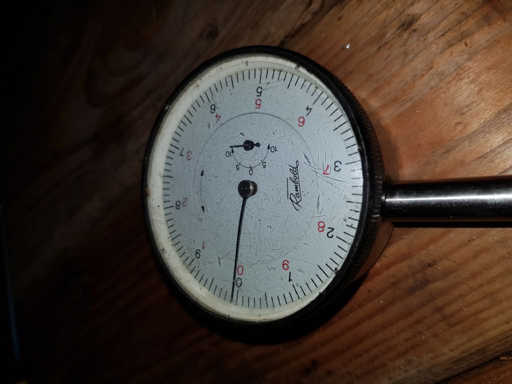

      Hi all
      I have the DTI but it doesn't say if its metric or imperial nor does it say what each increment is. Its very heavy and feels smooth so I'm hoping it's a good quality one.
      Can anyone help.
      Thanks
      Steve

          Why not mount it on your lathe or mill and move a handwheel by a known amount and see if the dial reads that amount in metric or imperial

              I will have a guess and say a tenths indicator with a total travel of .020 inch but the only way to be certain is to do what Jason said and compare it with the movement of a graduated dial like a lathe cross slide or you could set it up in an indicator stand on a flat surface so the nib is vertical and touching said flat surface and slip a feeler gauge between the nib and the flat surface .
              Have a look on the long island indicator website as they may have some info on that make of indicator .
              #415301
              Anonymous
                I'd be inclined to say metric +/- 10mm with each small division being 0.01mm. However, look at how much the nib is sticking out; which will equate to the total travel, that'll tell you if it's +/- 0.01" or +/- 10mm.
                Is it an indicator or a test indicator? The former have a shaft that moves in the vertical direction, the latter normally have a moveable lever that can move in any position it is set.

                  Metric ones are commonly yellow.

                    Think its metric as it does not line up when mounted to my lathe as suggested by JasonB.

                      There should not be much thinking about it.
                      If your lathe is imperial put on 0.050" feed and if the dial goes round 5 times it is imperial. If the dial goes round once plus 27 divisions it is metric as 50thou equals 1.27mm
                      If it is more sensative and does not have that range of movement try 0.005" feed
                      #415362
                      Steve King 5
                        @steveking5
                        Thanks JasonB
                        Its metric 0.050 equal the one full rotation plus 27 divisions.

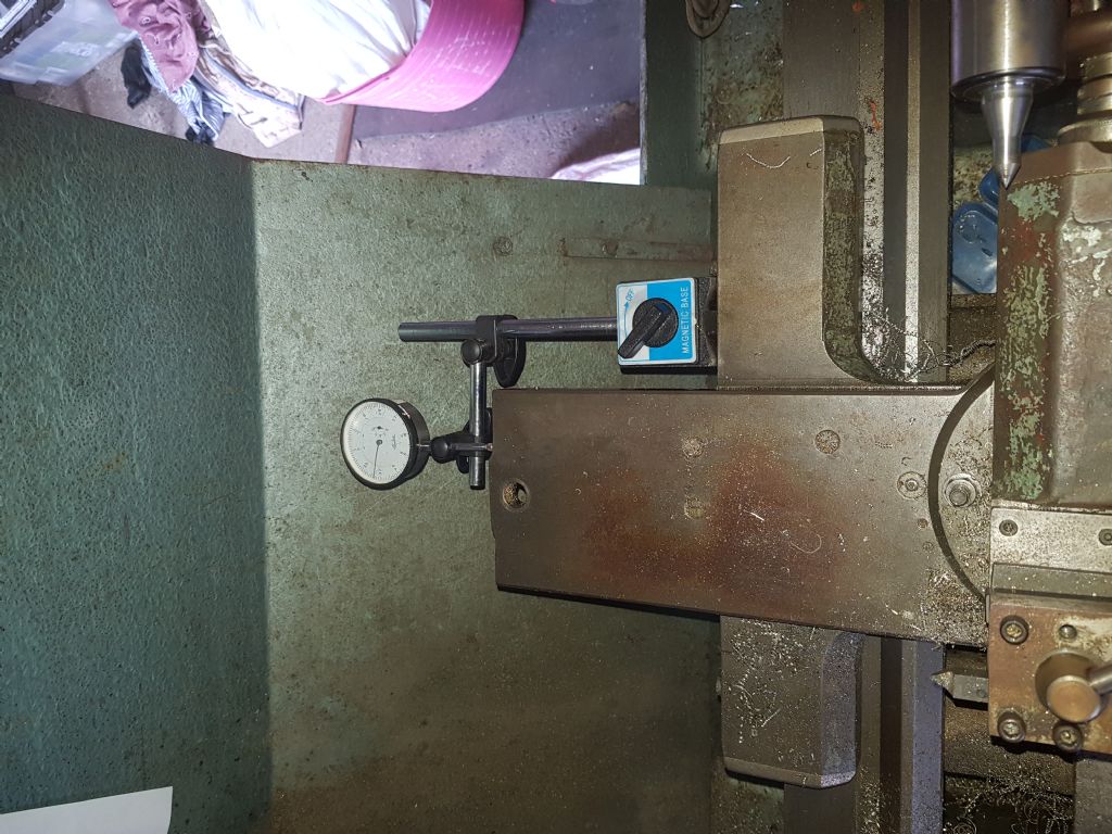

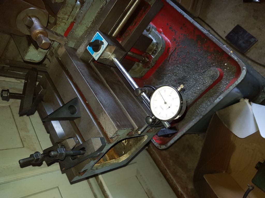

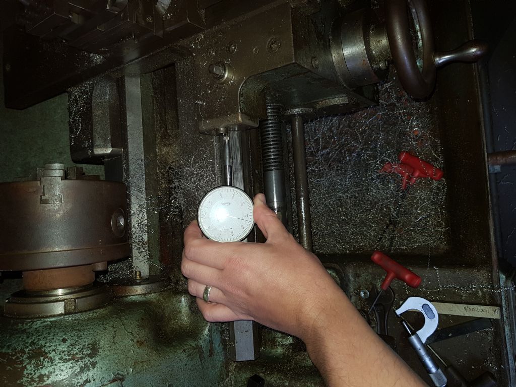

                            I plan on using the DTI like this

                              Hi, it is quite possible that it was for use in a quality control as a comparator. Either it may have been to match parts in pairs or set amounts, or to check on production runs, either way the operator would not need to know any measurement as such, but would set the test machine to a master and compare the tolerances for production runs, hence the zero being in the middle of the stroke.
                              Just my thought the reason that it doesn't indicate mm or inches and the fact the little 10-0-10 dial would suggest it being used horizontally..

                                I think DTIs are intended for use as comparators, not accurate or indeed precise measurement. Their calibration is ultimately dependent on a rack-and-pinion, not a precision thread or transducer. They do have high resolution, for example indicating 0.01 mm/division, but one division will not necessarily be 0.01 mm if you see what I mean. Though it would probably do the job in the application you show, for best accuracy you would be better using for example a DRO.
                                In the language of this a DTI has high resolution but is not very accurate or precise.

                                  I'd love a DRO but even the cheapest Chinese one are hundreds and I only have tens hahaha. Maybe one day.

                                    If I'm not mistaken, that lathe you have is a S & B model A.
                                    #415424
                                    Steve King 5
                                      @steveking5
                                      That's correct a mk2 I believe
