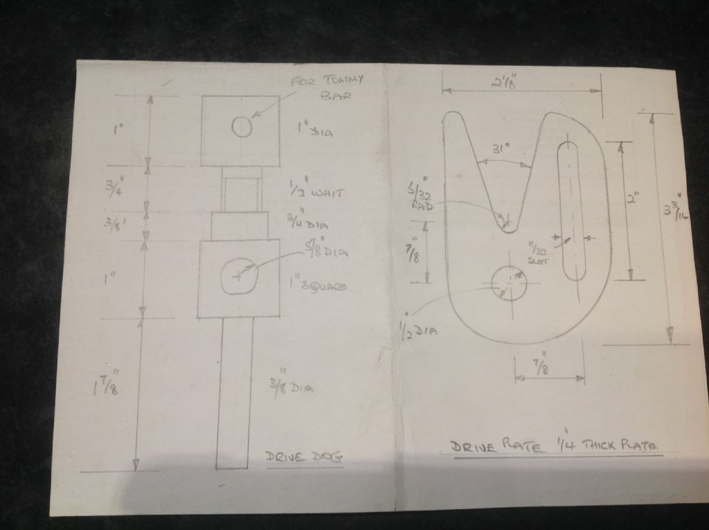

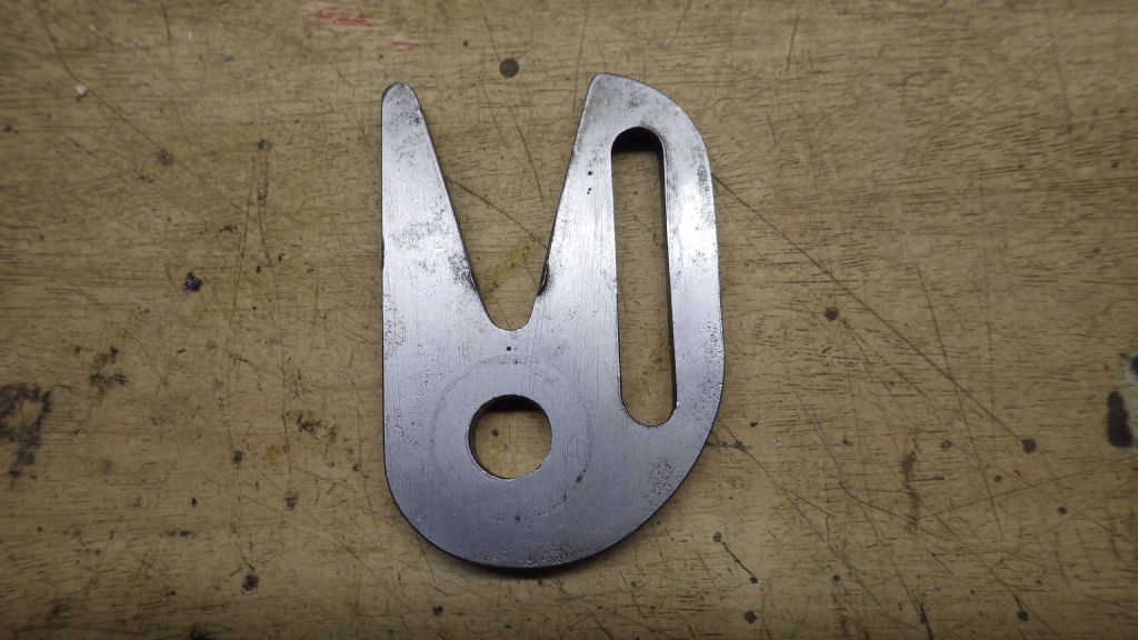

                      Hi ndiy , sorry for the delay in replying, I'll pm you with sketches of the drive on my Drummond shortly. But in answer to your query I can get the movement on mine to vary between one tooth and four teeth depending on the travel of the ram and the position of the pivot in the slot on the drive plate. The cross slide moves about 5thou per tooth. The maximum I normally use is 10thou per stroke.

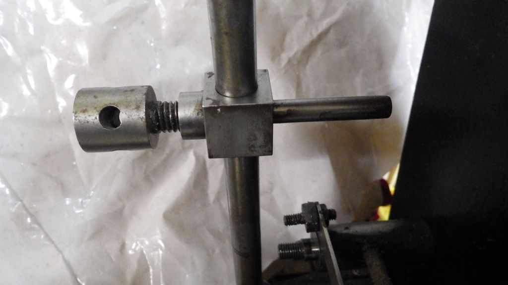

                          As mine has a slightly different drive to other Drummonds here is a sketch and pics of the drive dog and drive plate for anyone who wants to copy them.
