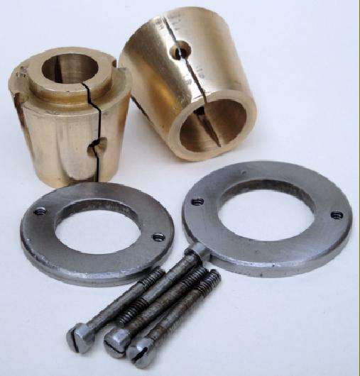

            Hi Guys.
            The bearings in question look like this (pic used courtesy of lathes.co.uk).
            #812528
            old mart
              @oldmart
              There is a small ammount of adjustability built in courtesy of the split has that all been used up? It might be possible to give the bearings a second life by several hacksaw cuts around the OD going 3/4 of the thickness, and filing the existing cut wider. This would allow the bore to shrink slightly.

                  cogdobbler
                    @cogdobbler
                    What has led you to the conclusion these bearings are worn out?
                    Are they pushing so far into the taper the slit is closing up metal-to-metal? Or that the small end of the bearing is pushing up against something?
                    In either case, removal of metal from the slit or the small end  should remedy it. You might have to make up spacer rings to go under those existing rings so the bearings get pushed further into the taper now.

                      Further to above post note the conical oil hole. There might be an oiler bush fitted with a conical end to push the bearing open so check that.
                      #812579

                        Hi chaps. Yup, the slit in the bearing is pretty much closed when all play is removed by tightening the two screws to draw in the bearing. The screws have to be pretty darn tight, so I think we’re at the end of bearing life. The suggestion to widen the slit (ooer) may hold the reaper at bay for a bit.
                        My concern is not that I can’t make a set of bearings, It looks to be quite possible, but the order of operations in order to produce accuracy is my main issue. How to make the things on a lathe with the minimum of faff.

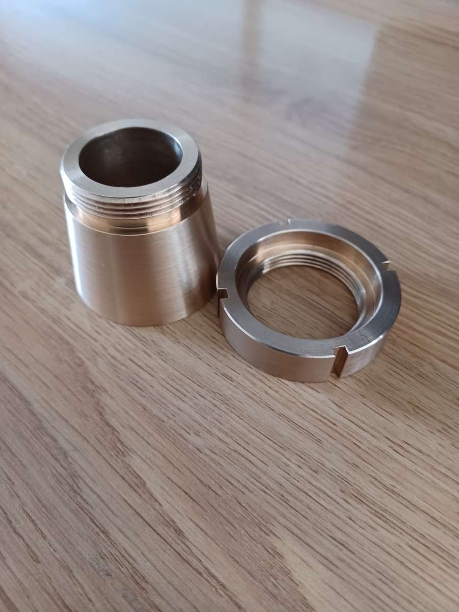

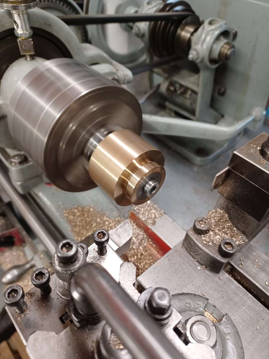

                                  I have made new bearings for an M type Drummond lathe. You should make them from Phosphor bronze as brass will wear in no time at all. You should strip and check the spindle for wear and measure the lengths and diamiters of both ends of the taper before finnishing turning. You should only cut the slot through with a slotting saw after finnishing turning etc. I make a expanding mandrell which i finnish to size of the bore in the chuck before finnishing the outside to size and taper to match the headstock to ensure it runns true.
                                  Pictures of my bearings which although tapered on the outside work diferantly.
                                  20230729_18124320230729_08121320230728_151134
                                  Tighten the screw which has a taper on the head expands the mandrill which has a similar angle in the end.
                                  David

                                    A passing thought. How much gap was there initially and hence what range did they think it would wear over in the bearing’s life. Assuming the initial bearing diameter was an imperial round figure it will be interesting to hear what the current diameter is.
                                    My guess  the gap was about 1/16″ or 3/32″(nice imperial slitting saw) and it has gone down by 1/16″ or 60 thou. So around 20 thou on diameter. Would it be viable to fill the bore out with a strip of brass shim?
