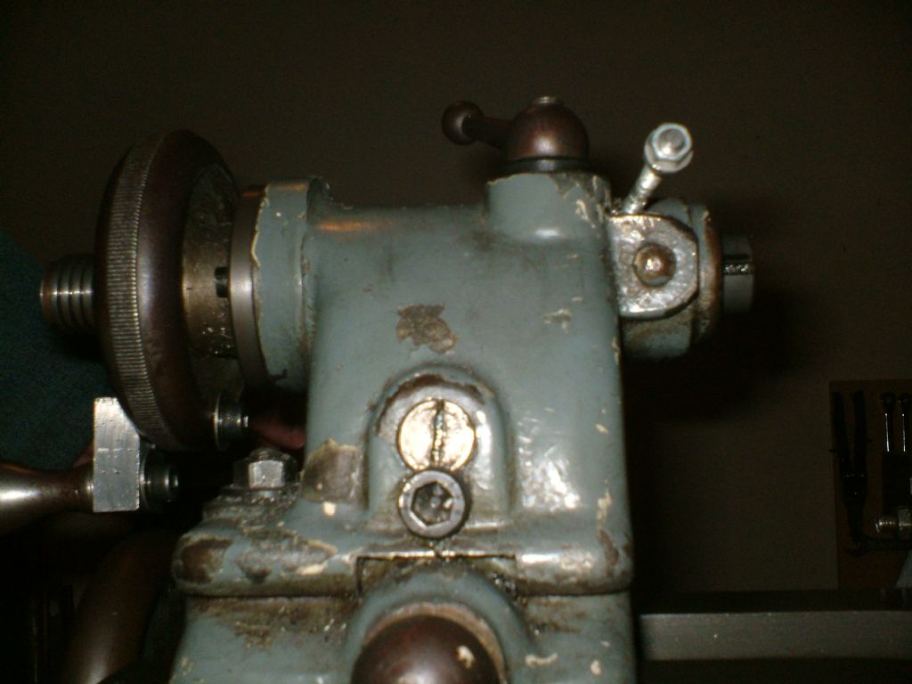

The metal pin is fine, it's a tight fit only and the vehicle by which the two halves move in opposite directions

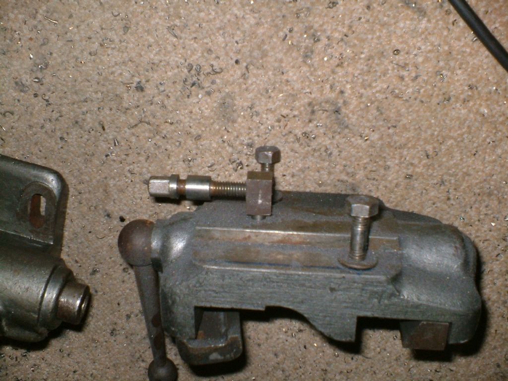

I modded my other tailstock with a hex bolt to make adjustments easier by using an allen key
The two sections can be tapped apart no problem once the hex bolt part is removed, I think it was a big cheese head screw originally
The even BIGGER screw above it is simply to keep the hex bolt from moving about(falling out), so the hex bolt can manipulate the upper tailstock section back and forwards on the lower section via the pin in the lower section
