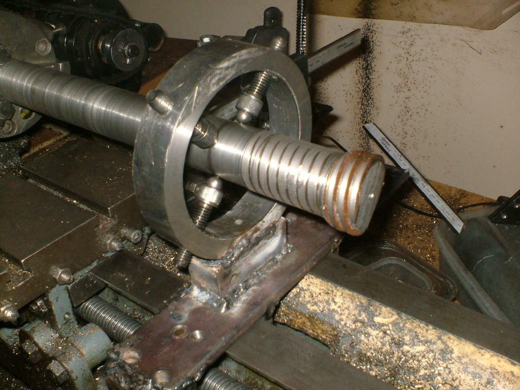

          Here's the current state of my scrap lashup fixed steady, the 1/2 HP motor is making big jobs miles easier
          A 10mm plate for the base, a 1 inch pedestal and a 5 inch ring, plus assorted other bits underneath, all glued together with a 40quid Lidl buzzbox
          Lots to still do, tidy up etc, the 30quid Lidl angle grinder and base are making any welding mistakes or messy bits miles easier to remove, sort out and redo. If you ever take the "welding route" an angle grinder is an essential part of the setup IMO

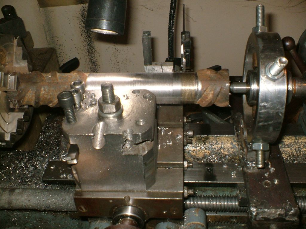

            Update on my Lashup fixed steady
            The Lidl inverter welder and angle grinder tidied up and finished things off and I started doing some rebar for more stock which involves annoying intermittent cuts
            Anyway, the family braincell was active for once and this fixed steady allowed for some serious improvements I had never foreseen
            I used the fixed steady to support my live centre, which flexes with heavier cuts because there is always that inevitable overhang
            The improvement was massive, so much so that I popped in a 5% cobalt tool and on the backgear I can run up the entire rebar with a single shaving cut, completely eliminating any intermittent cutting
            #298395
            Hopper
              @hopper
              Looks good. Some serious swarf being made there. Good idea on the centre support. Makes up for the somwhat spindly MT1 tailstock centre.
