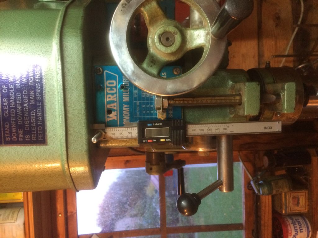

          Speedy Builder5
            @speedybuilder5
            Fitted an old digital calliper to mine. Will take a photo later.
            #433778
            Speedy Builder5
              @speedybuilder5

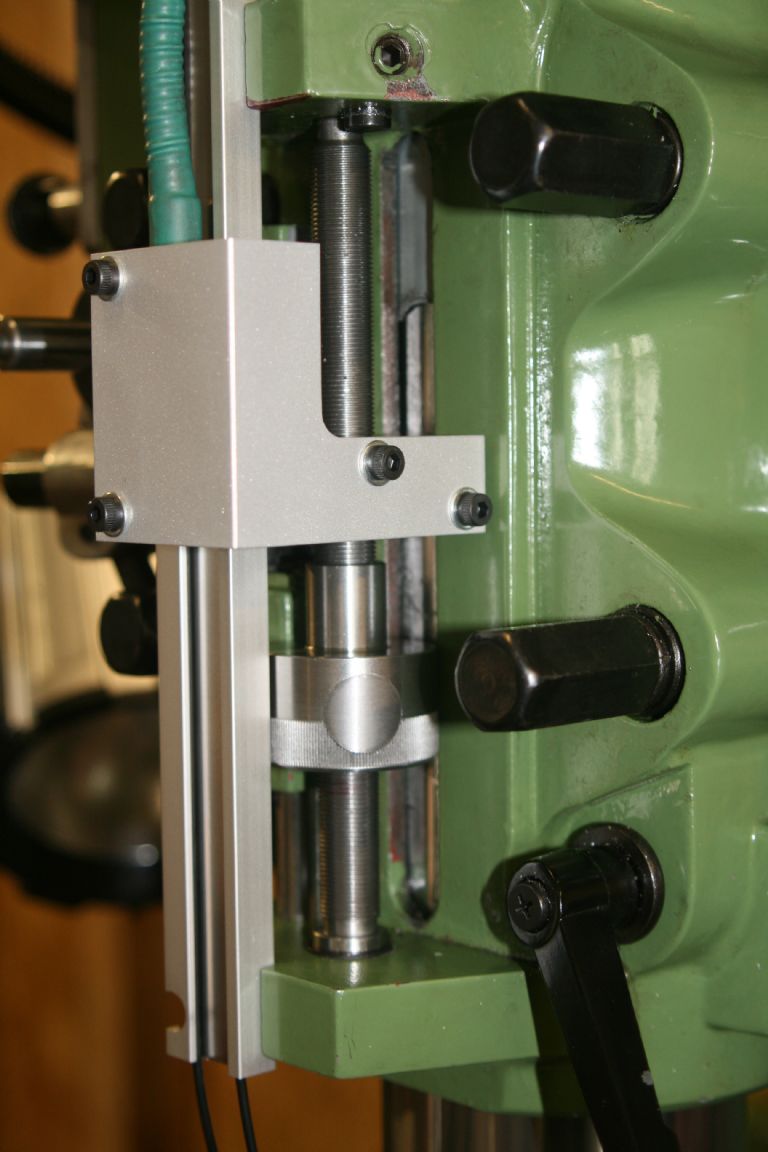

                        Spurry
                          @spurry
                          As fitted to Warco WM40.
                          Pete
