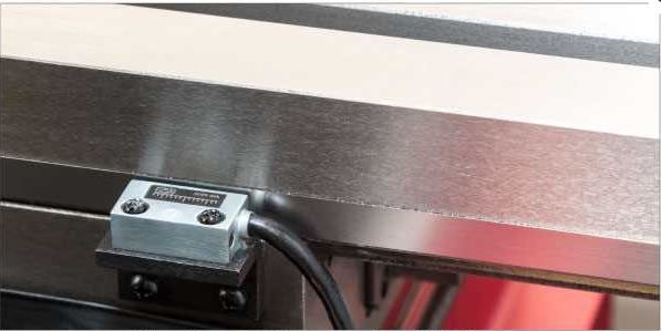

              I suppose it depends on what kit you bought, a magnetic one need only loose you a few mm, even less if you mill out a slot for it in the back of the table with head to one side. Different case if its a standard size glass scale.

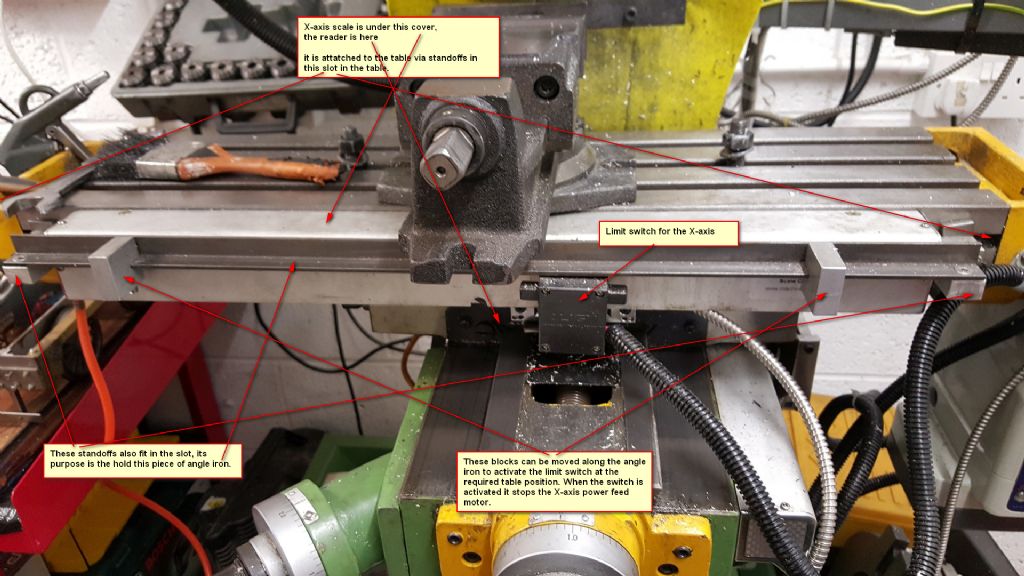

                    At the risk of repeating what I've put in similar other posts, I overcame this problem by extending a milled bar beyond the scale on my VMC:
                    x-axis scale 1
                    And:
                    x-axis scale 2
                    The travel stops are retained, too. More pictures in my album.

                      Yes John, that looks like a solution, something i will consider when i get the dro kit delivered, I have enough movement in the x and z axis, but always found the y a bit limited and don't want to lose anymore if at all possible.

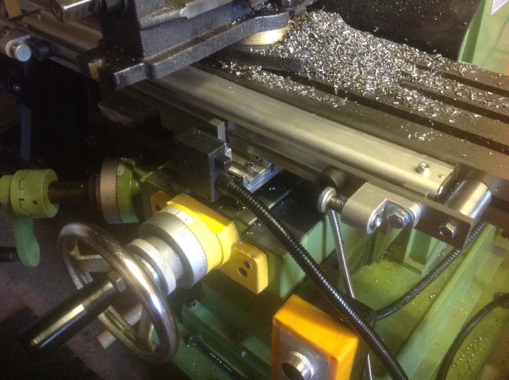

                        I did something similar to John's solution on a friend's VMC mill.

                            The conversion in my photo uses glass scales and no interference with handles has been encountered.

                              Did you slot the table and insert the tape in the slot Jason? I 'm about to mount mine (which is similar) but I'm a bit concerned – the magnetic tape has double sided tape, so I was going to stick it directly to the table, but I don't know how long will it stay there when oil gets to it.

                                  Chris, that's how they are coming out of the Sieg factory with the scale already fitted into the slot. Don't know if they use anything different to stick them or just DS tape. As you say if using something like paraffin or WD40 on ali then that may soften the tape adhesive over time if not protected.
                                            Ah, it came from the factory like that! Very nice of them, the most compact setup I've ever seen. I guess I will just take the chance and stick it with the double sided tape the scale comes with, and if it comes off in the future I'll stick it with some more permanent adhesive. Thanks Jason
