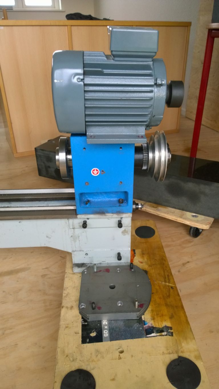

            The way I did it some time ago
            WM250 Three phase
            The way I will do it in future
            Lathe with sewing machine motor

                To drill and tap 4 M8 holes more or less as shown in the cheap and lousy chineese cast iron bed is not a sin like schratching a Myford or Boxford will be.
                The intermidiate aluminium disk was some leftover from windmill manufacture and is more usefull on my lathe.
                The beauty of Fenner Powertwist belts are that they can be rolled on the two disc sheaves without harm.
                When loosing grip with wear or time it is easy to remove one link.
                If You roll over the slim Gates 5M belt it is hurt.The beauty of the Gates 5M is that it will go round 28mm where the powertwist Z is not really well below 60mm diameter.

                  Another picture of WM250 homemade belting

                                As I see it You have to make some desiccion .
                                The shaft of motor is 24mm I asume and that is Optibelt 1108 bushes country.
                                If Your lathe has a 130mm disc for 7M belts You can easily modify a Suitable optibelt spz pulley for 7M belting ca 60mm active diameter.An fourpole can easily run 3000 rpm.
                                3000 divided by 130 multiplied by 60 makes lathe run 1400 rpm and that is enough for my taste and I have used three 250 type lathes.
                                If low speed ,high torque is Your love it is possible to put a say 200 mm ring on the 130mm lathe pulley modified to have a SPZ profie on rim and use a standard SPZ Optibelt 56mm pulley on motor
                                The simplest is to modify the smallest (ca 60mm) motor pulley for 7M belts.
