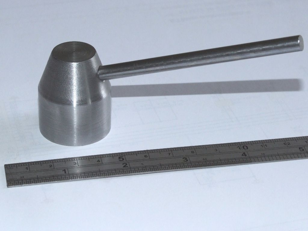

      I have decided to have a go at replacing my toolpost turret with one that doesn't require a spanner (after reading another post on here)
      I have made a replacement, with a taper on the top and am struggling to work out how to drill the hole for the handle in the taper?
      I have attached a (very) rough sketch – I have a bench drill where I can tilt the table so I thought if I clamped the body of the turret in a machine vice and tilted the table at the same angle as the taper, this would be horizontal?
      My problem is how to square up the turret (so the axis is at right angles to the axis of the table tilt? The table has diagonal holes and it is proving a struggle to line up the centrepunch mark, level, while keeping the turret square! I could clamp a straight bar in the vice and try to find an appropriate straight edge to use a square against but wonder if there is a knack or clever trick to doing this?
      The diagram show what I am trying to make (at the top), the vertical (birds eye) view of the table (middle)and the front view of the table (bottom)
      Any ideas gratefully received!

          Chris,
          If you put a 3-flute milling cutter in the drill chuck; you can "spot" the location.
          Work very gently and stop&inspect frequently … you will easily see when the job is properly centred and level.
          When youre happy: Pop the drill into the chuck, and away you go.

            What you are trying to do might be easier if you do not tilt the table of the drilling machine.
            You dont show how you are holding the part you want to drill but if you mount it at an angle (in the drilling vise or bolted to a jury rigged bracket) then that will sit flat on the drill table and not tend to slide down the slope whilst you are getting it centered.
            Once the drill has started is best to stop several times whilst drilling is in progress to check the alignment visually. The precise angle is not important for a locking lever but it needs to look right with the levers spindle intersecting the bolting axis.

              I cut an appropriately wooden wedge on the bandsaw – thinner than the diameter of the body of the "nut" and put this in my vise and clamped it up. Take it easy – centre drill and tapping drill. No problems.! If you have your drill table level best not to disturb it I feel.

                    This is a job that can easily be done on a lathe . With blank mounted on vertical slide using vice or angleplate or alternatively on cross slide using packing and possibly V block you will have a completely rigid controlled set up for drilling .
                    There are ways of finding the correct angle and height setting using a dial gauge but I think trial and error would probably give satisfactiry results for a simple job such as this .
                    If you are uncertain about the set up do a spotting with a small slot drill fist and just look at it – if the mark is in the wrong place it will be obvious and you can correct positioning .

                      Thanks for all the suggestions – the consensus seems to be leave the table alone and angle the work so this is what I will do! I have two machine vices both of which have a horizontal groove halfway down the faces presumably to grip round work – but I can mount at an angle with some support and keep the vice tightened up.
                      I do not possess an end mill (yet) I presume this is to give a flat on the angled face? I do have a spotting dril and was hoping that this would get the main drill started as well as giving me an idea of alignment?
                      The image shown by Norman is exactly what I am trying to achieve

                          First; you should use either a 3-flute cutter, or a slot-drill, NOT an old style 4-flute end-mill. … The end-mill would leave a "pip" exactly where you don't want it. [if you are not aware of he differences; please PM me, and I will try to explain]
                          When the job is correctly centred and level under the chuck; the cutter will leave a symmetrical witness line. The two ends will be slightly curved, and the "line" will have constant width.
                          For your piece: I would use a 3-flute cutter of about 6mm or 8mm diameter, and aim for a witness line about 2mm wide.
                          First roughly centre the work under the chuck [a pencil held in the chuck might help] … Then adjust the "tilt" until the cutter produces a good line. [if it's wrong, the high side will be cut first and the line will be tapered]
                          Then … adjust the "position" until the curved ends of the line are symmetrical.
                          When BOTH of these tests are satisfied; the drill chuck will be aligned with the centre of the witness line. … Just finally, check the "axial position" before you drill.

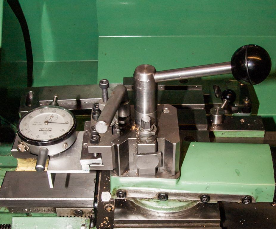

                                                    Final episode!
                                                    Here are the results of my toolpost handle project and thanks for all that helped!
                                                    I even managed to make it carefully enough so I didn't need a spacing washer – the arm is off my tapping tool, as my 10mm die is now too blunt to cut, and I don't know (yet) where to buy the ball ends (although suitably encouraged, now I might think about making a ball turning attachment tool…)
                                                    Chris
