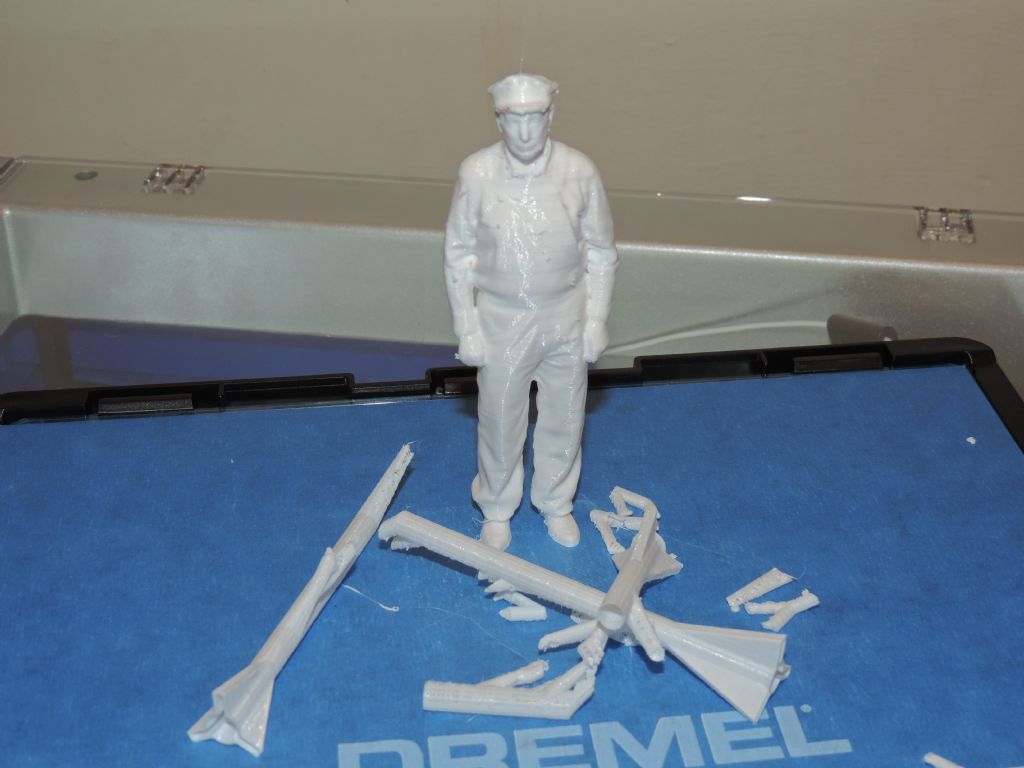

            #272422
              The demo worked well.
              Initial impression is that its a very high quality printer, but doesn't allow all the tweaking you can do with a homebuild.
              Only downside is no heated bed – tough getting the print off the buildtape even with the 'special removal tool'!
              Loco driver is appearing right now.

                Driver came off much more easily – probably because a much smaller contact area.

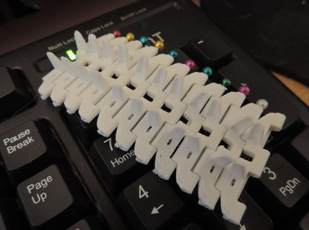

                        This is a rough prototype for a tank track, please don't score it on accuracy or knock of marks for dressmaking pins being used as hinge pins…

                                        Hi Neil
                                        Lets see a picture of your driver figure, will you be selling them to finance other projects? I could do with one for my 08. Just need to get a 3D scanner now and you can rescale any thing!
                                        Paul
                                        #279124
                                          To slightly modify the article text for context: The figure is from a file for one of ARD Digital’s 3D printed figures for 16mm railway enthusiasts. They kindly sent me an OBJ file for one of their engine driver figures, which I was able to enlarge to suit my loco, Southam. The tall, thin figure benefited from plenty of support. Obviously I would be a scoundrel if I sold figures using their data and their prices are really very reasonable. If you are interested in these figures, visit their website at designscanprint3d.bigcartel.com to see more examples.
                                          You may be able to persuade them to print at a larger scale than 38mm but expect to pay more as materials and time increase as the cube of the scale!
                                          This is actually printed at the standard setting, not the fine one! ARD Digital's prints are at least as good.
