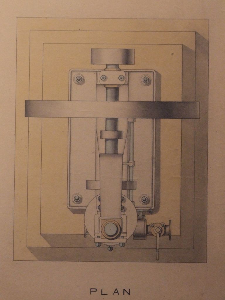

              Andrew – you must have pondered the design for many hours over the years! I'm assuming that the connection between the pin and the disk on the piston rod must be either spherical or at least capable of accommodating 2 axes of rotation. Was it his own design? Do you know if it was ever built? Perhaps somebody ought to have a go at a making a detail design and then building it….
              Interesting that the "plan" view is actually a sort of perspective / slightly isometric view. And the views show shadows. Somewhere between a technical drawing and a rendered view!

                I think Neil may have it right when he says its a "Twisty" one, there is no sign of valve gear and the "crank" could be harlf a bevel gear with the other half driven by the shaft comming out the top of the cylinder which point to a turbine of some sort.
                I don't think the plan is iso or perspective but it does show draft angle on the main castings.
                Indeed it would make an interesting project, maybe andrew could provide a few close ups and also share the other two engines

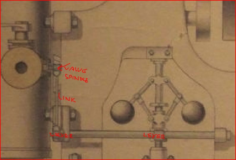

                      I thought that the pully and belt would drive a shaft to bevel gears just above the governor as I can't see any other way it is driven
                        I agree on closer inspection. It's actually just shadow – but it's cast on the machinery but not the foreground which is confusing.
                        If you were to build it, you'd certainly need to decide if it's a reciprocating engine (my vote) or a turbine. Of course, it may have been a "naive" design that would never work. No disrespect intended but we have no idea how real it was. Hopefully Andrew knows something about it….
                          Ah ha! That makes sense, no problem driving a governor with a belt.
                          Even though I can't see any valve gear I think it reciprocates too.

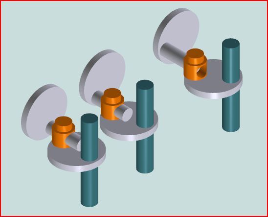

                            For anyone not familiar with the 'twisty' concept , its a single or double acting engine that has an extended piston with ports in its sides, the drive to the flywheel is some sort of universal joint so as it lifts and lowers the piston it also covers and uncovers the ports.
                            With care its possible to make an engine with only two moving parts (piston and flywheel/shaft). The downside is the lack of adjustment.
                            Twisty was an example described in ME as a new idea, but in fact a similar model had been descrivbed many years before, and clearly this engine is even older.
                            Nihil sub sole novum

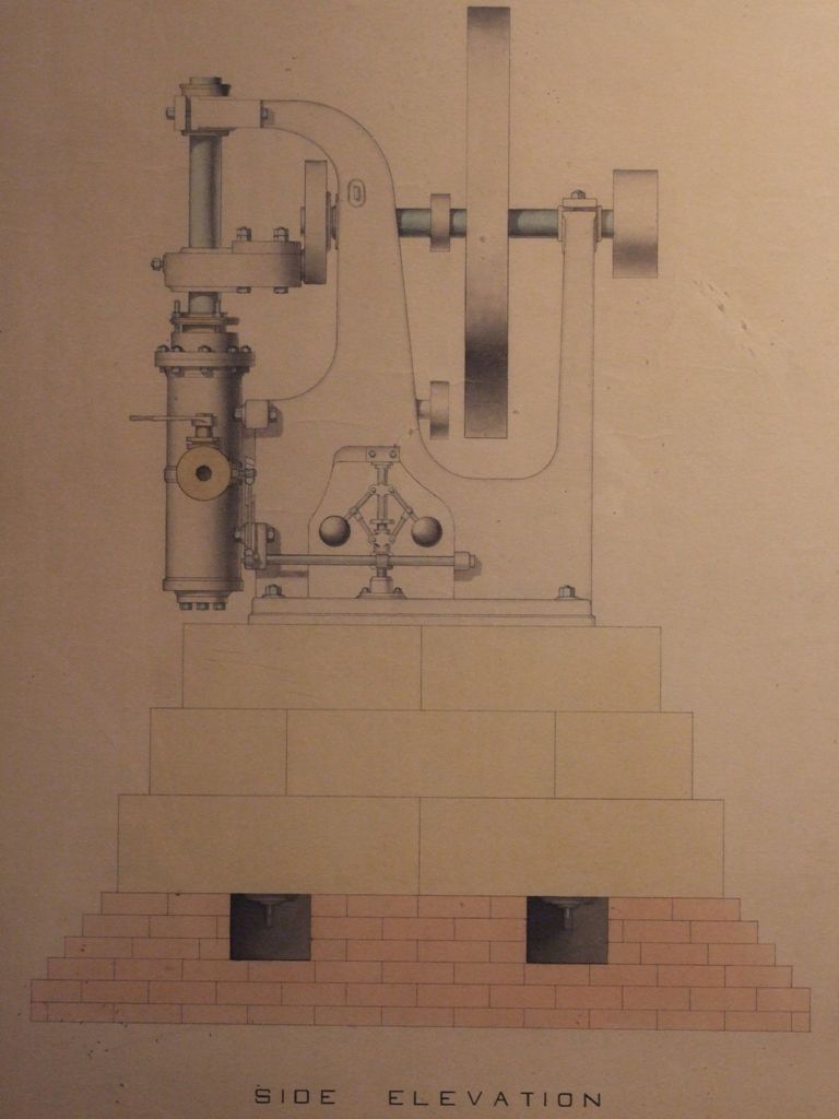

                                I think the engine is definitely a reciprocating type.
                                I assume the crank pin engages with the lump attached to the piston rod and it slides in the upper tail rod support. There is probably an oil well in the lozenge shaped bit which is bolted to the piston rod, you can see the cross bolt in the diagram. That would be enough to keep the crank pin and piston rod lubricated.
                                The governor is driven by the belt pulleys (belt not shown in diagram) and there must be a pair of bevel gears inside the casting. The governor operates the steam regulator. The mystery is – where is the valve gear? Possibly it is contained within the piston casting and as with most stationary engines it only rotates in one direction, so a simple piston or slide valve would do the necessary.
                                I have seen similar steam engines in old books but never one like this one.
                                There appears to be a sort of name or logo cast into the main support but it is too indistinct to decipher.

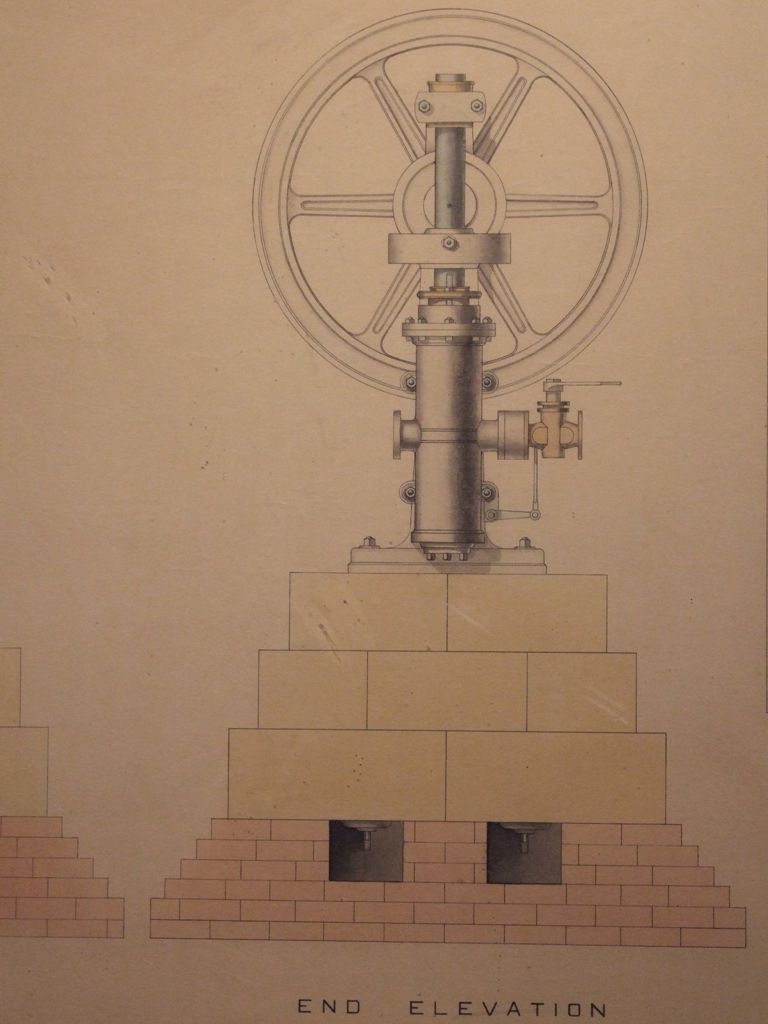

                                  Indeed I have pondered it over the years. I can sort of see how the crank may be articulated, although it seems rather complicated. Neil may well be right about it being a twisty. It seems to show steam entering on one side with the exhaust in line on the other. I'm afraid I have no clue about the origins of the engine, or whether it ever existed in full size. Here are some closer shots of the elevations:

                                    Some background – my grandfather was born in 1888 and came south from Edinburgh in 1904 looking for work. So he would have been about 20 when the drawing was done. That seems a little late for an apprentice piece? My mum thought it might have been a demonstration drawing (like an artists portfolio) when looking for work. If that is the case it may well be that the engine never existed, and wouldn't work as drawn. However, that seems odd. Remember that in the good old, bad old, days the draughtmen often did a lot of the detail design and calculations, so not good if the engine design was wrong?
                                    I know that my grandfather was working at the Royal Aircraft Factory at Farnborough in 1912, as there is an entry in Geoffrey de Havillands flying logbook in that year stating "took Mr Johnston for a ride". In the early 1920s he was working on high voltage switch gear at BTH in London. In 1925, a few months after my father was born, he moved to Yeovil to join Westlands as chief draughtman. As an aside my father had his first trip in an aeroplane at Westlands. Aged 10 he cycled out to the airfield, spoke to the test pilot, Harald Penrose, and was given a trip in the back of an aeroplane about to be test flown. Can't imagine that happening today!
                                    In the late 1930s my grandfather moved to Airspeed as chief draughtsman, working with Tiltman and Neville Shute Norway. He lived in Portsmouth during the war, where they had an indoor Morrison shelter, rather than the more common Anderson shelter. When Airspeed was taken over by de Havilland my grandfather transfered across and became their design office manager at Christchurch. He retired from de Havilland in 1960, and promptly joined a local engineering company in charge of the stores.

                                      Andrew, thanks for the extra photos and family history.
                                      J
                                      PS could you provide one dimension so an idea of size could be worked out, say flywheel diameter

                                          Andrew – that's quite a respectable aviation engineering family history. There definitely seems to be a genetic component to what makes us tick. In my case, it seems to be agricultural engineers and carpenters, also from the Scottish Borders – not quite in the same league perhaps! My dad came South for work with his PhD and found ICI (remember them), while his cousin (and now his son, my second cousin?) took the other route and stayed to run the farms.
                                          From what I can now surmise, it's pretty much complete as shown. The "Twisty" concept sounds right, whereby the piston is also a rotary valve, being both raised and lowered as well as rotated back and forth by the connection to the end of the crank.In the process, it opens (uncovers) the inlet and exhaust ports, a little bit like a sleeve valve engine (without a sleeve as such). Can't see the detail of the connection between the governor and the steam valve but that's not critical.

                                            In it's simplest for the joint between piston rod and crank could be something like this. A second top plate would support the top of the rotating bearing.

                                            The governor link is visible, that "ring" between the flange from the cylinder and the regulator flange would have a butterfly valve or similar. A lever from the governor to the rocker shaft and then a second lever from the shaft to the butterfly valve complets the linkage. It is there if you blow things up.

                                              It could be a type of sleeve valve engine. The sleeve is connected to the piston rod and moves to open and close the ports. As the exhaust seems to be directly opposite the inlet steam pipe that could work. But the piston must have been quite a small diameter compared to the cylinder outer diameter?

                                                I expect the port timing would be controlled by suitable holes in the piston skirts, so no need for sleeve valves as such. The piston could be not much smaller than the outer wall.
                                                Although there is no need for a conventional conrod, one of the main downsides of this concept must be the greater stresses on the piston rod. It is subject to significant bending stresses, as most of the thrust is generated when the connecting pin at its greatest off-axis distance. This probably explains the hefty piston rod – possibly hollow but still quite sturdy. And although the piston motion is linear, there will be significant friction generated in the sliding piston rod bearings by the crank / connecting pin.
                                                  Jason: Flywheel diameter measures as 7.5". Thanks for the excellent 3D CAD models. It seems that it may well be a viable engine? With your workrate I expect that you'll have knocked one out by the end of the coming Bank holiday weekend. smile
