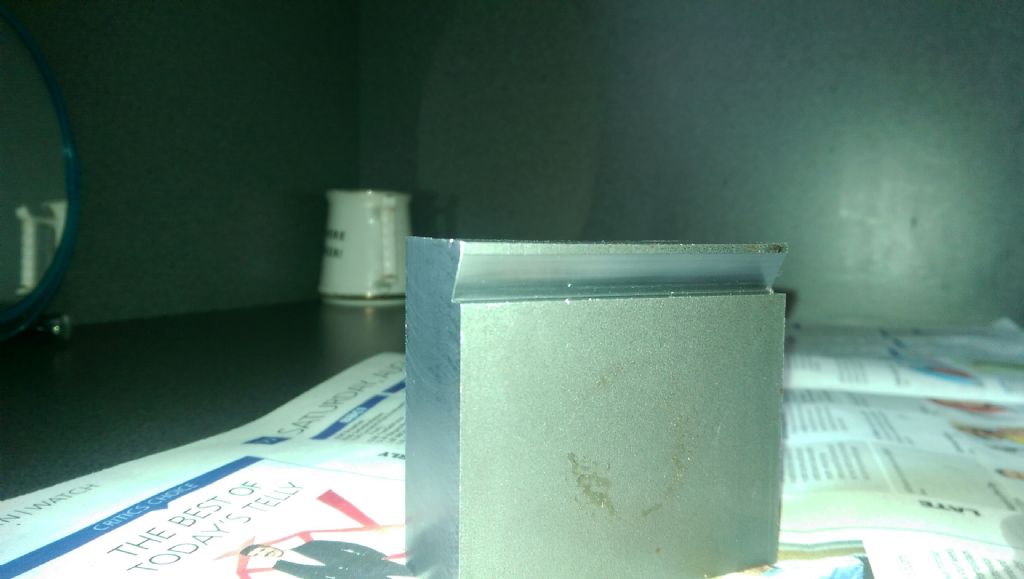

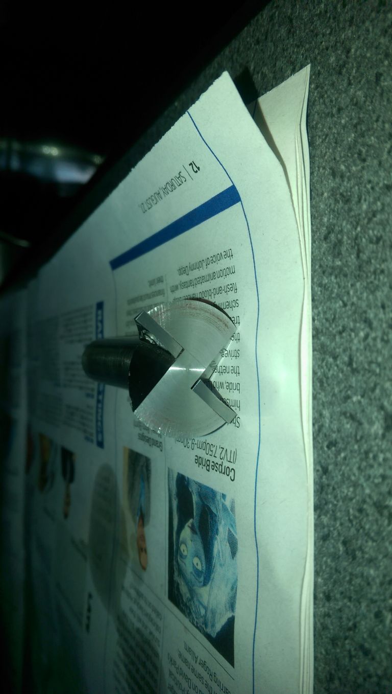

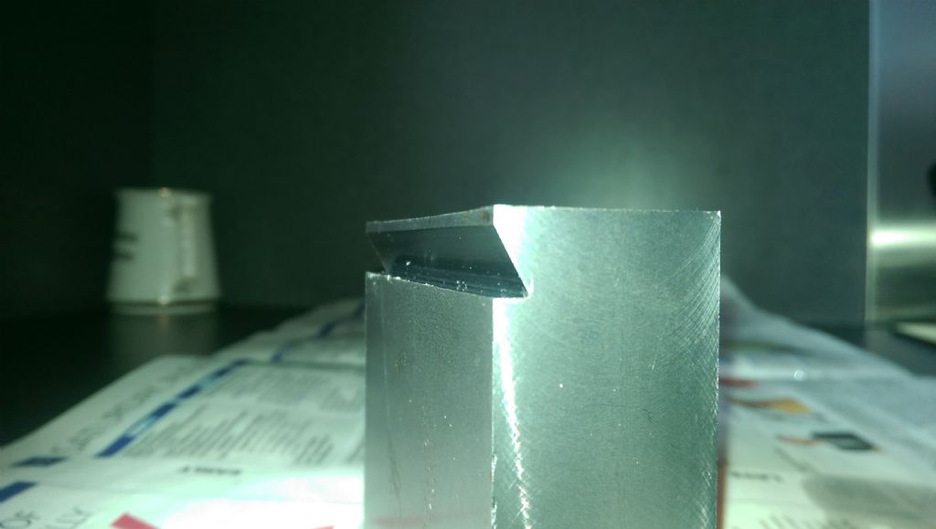

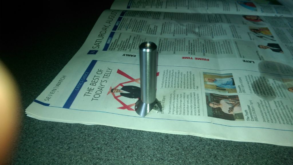

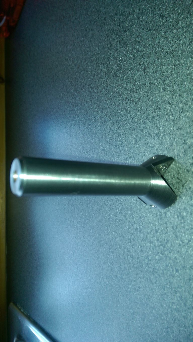

                    dt2.jpgdt1.jpgdc3.jpgdc2.jpgDecided to go ahead and make the cutter I set my self a tolerance of 0.01 mm for the inserts in relation to each other [ outside that then scrap and try again ] Got them to 0.005mm on the bottom and 0.007mm on the cutting face. 0 would have been perfect, but in my world what I managed was close enough for me. It's made from a piece of EN24T . Tried it out on a bit of 4140 and got the full depth dovetail [ 11mm on the face ] cut in 4 passes and surprisingly soft cutting action It doesn't "hammer " like single insert ones. And leaves a very smooth silky finish. The inserts I chose are TCGT 1104 although any TC insert will suffice. I initially had reservations about the TCGT inserts [due to their perceived fragility ] after the test piece I checked the state of the inserts and no chipping had taken place. It is I think vital, to get the 2 inserts as near perfect in position to each other and the use of the correct Torx screw. This cutter will fit into a slot of 24mm in width I am now going to make one that uses a 09 insert to allow it to enter a narrower slot [should be able to get into 16mm slot ] and one using 16 size insert. Maybe even try a 3 insert design on the bigger size.dc1.jpg

                        Thanks Michael, It was something that I wanted to try a while back. Actually works better than I thought it would. smiley.

                            Hi Peter, As you will probably realise already it is VITAL that the inserts are as near as perfect in relation to each other or else one insert will be doing most [all ] of the work. That is easily the hardest part of making the cutter,.the rest is straight forward. I could easily have done a three insert one using the 11 02 inserts but I wanted to keep the core strength as high as possible. 3 inserts of that size would have meant a bigger Ø body to keep the strength. I will go 3 inserts on the 16 size insert which should fit into a 30 /31 mm slot. It was a nice little exercise.
                            Cheers.

                                  I am curious about the back edge of the inserts. They look to me like they will have a larger radius than the cutting edge and as a result will rub. Is there any sign of this?

                                    Martin, I'm not sure what you mean about the "back edge" do you mean what would normally be the"bottom" of the insert if it were mounted in a lathe tool ? Because they are positive inserts they cut only on the leading edge [s] There is no rubbing. The back of the inserts are exactly on the edge of the mounting surface so only the leading edges project below the base / rim of the cutter.. If they project too much then that would weaken the support for the inserts. They project the same as they would on any quality lathe toolholder.. Hope iv'e grasped what you mean..
                                    Cheers.

                                                Hi Murray, In answer to your queries, No, the surface is cut with no burnishing. Because the inserts are 7° positive there is clearance for the trailing edge. After I cut the test piece I blued both the inserts [ actually a red Eddings marker ] on their edges and put the cutter back into the cut dovetail and rotated the spindle by hand shaving a minute amount off and the red remained on the back edges In fact you could actually see the clearance without the need for bluing. The inserts are mounted with their cutting edge exactly on the CL of the body.
                                                With negative inserts then that would be a different scenario, and it would need to have the rake built into the mounting surface the same as negative toolholders I would never go back to a single insert as I value me spindle bearings too much and I hate the "hammer " thats the reason I dont like fly cutters although I will use them if I have to. The swarf came of as sort of needles terrible stuff to deal with.
                                                Theory is all right at times, the Titanic should not have sunk "in theory " but it did. I prefer real world results. One bit of theory that I would agree with is the need for the inserts be be as close to perfect in relation to each other as you can get. That is as close as I can get them 0.005 and 0.007mm.

                                                  Almost forgot, the feed rate was 60mm pm and 1200 rpm on the 4140 steel piece.

                                                    Further to my post yesterday I have taken a photo of my little hogger insert cutters. What can be seen with these cutters is that the cutting edges are not aligned on a diameter through the centre. As Muzzer stated the inserts must be ahead of this line by at least half their thickness. If you measure the distance from cutting edge to opposite cutting edge on your cutter the dimension may be less than the dimension of the trailing edge to trailing edge of the inserts. If this is the case then the trailing edge will rub.

                                                      Jesus Martin with respect, what part of " there is no rubbing " don't you understand ? The clearance is visible without having to measure anything. but I have measured it to confirm, Leading edge to leading edge 23.36mm trailing edge to trailing edge 22.74mm. Were the inserts to be NEGATIVE [ like those in you little hoggers appear to be ] then then that would lead to rubbing if they were mounted on the CL. The 7 ° clearance on the inserts is enough to give clearance for the cutter. When all said and done me vision is 20/20 I can see clearance.and the surface is CUT not burnished.
                                                      cheers.
