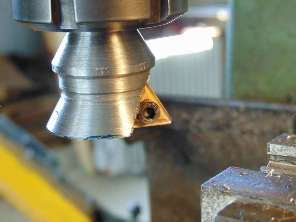

      Hello who has made their own diy dovetails and what carbide bits did you use please ?
      See my album for my first try. Bit type is unknown. A friend gave me some bits and I had a go.

          There are a few pics in one of my albums of a set I made from IIRC en24 and tcgt inserts [ various sizes ] be precise when setting up to machine the pocket / angle, also use the correct screws for the inserts [ vey important ] I used tcgt inserts because of the 7deg clearance angle to prevent rubbing and gives a nice soft cutting action The test block in some of the pics is either en16 or 24 can't remember. There is a thread on them somewhere on this site

              I have made a carbide tipped dovetail cutter more or less like described here, using a TCMT insert. There is another description of a dovetail cutter with carbide inserts on MikesWorkshop. A multipoint cutter would cut better than a singlepoint cutter, but I often use the carbide tipped cutter to mill away most of the material and use a HSS cutter for the finishing cut.
