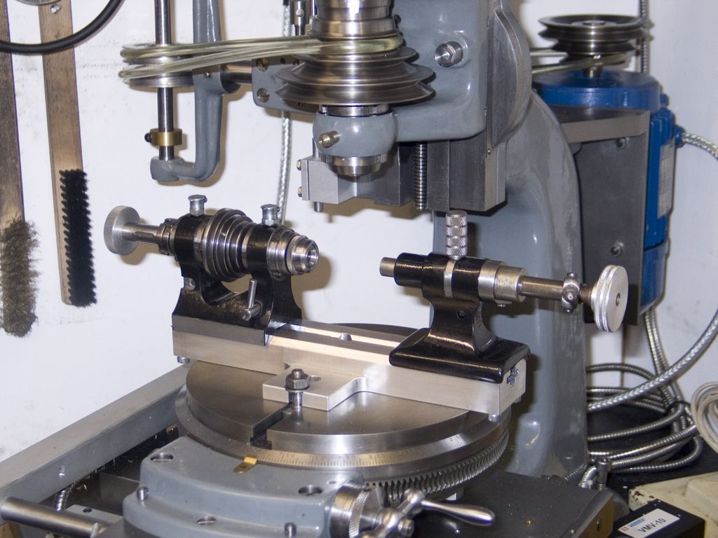

                  You could do something like this which I made for my own machine. It adapts a Pultra clock-makers lathe head and tail stock to use for small dividing jobs.
                  Phil

                          Phil P – I remember seeing your Sigma(?) and your dividing head on that "other" forum…. Very nicely done!

                                Posted by Phil P on 25/07/2018 18:47:17:
                                Phil
