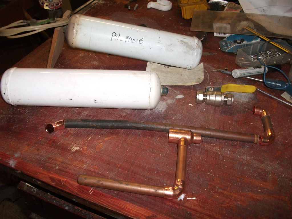

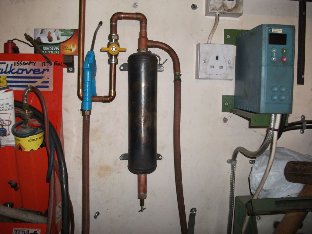

                I reuse my old mig and other pressure bottles,when they are empty
                i drill out each end, the paint seems a bit tough so i chuck them into the
                wood burning stove and burn off the paint .
                Seen here used as a water trap on the airline system and in the
                next photo the adapter fitting is silver soldered in the top,
                the supply comes in through the middle and exits about 2/3rd's
                down via an elbow which spins the air inside the bottle.the air exits
                though the top .a short piece of pipe at the bottom collects the
                water to drain off.
                Also used here in the photo as a refillable propane bottle for
                model gas turbine starting about 75 % liquid gas filled.
                Apart from that they are useful pieces of steel tubing ,why chuck them away.

                  Be careful repurposing second-hand pressure vessels because their pressure ratings aren't guaranteed. In particular disposable bottles are lightly made because they don't have to withstand the repeated inflations and deflations that cause metal fatigue.
                  Rechargeable pressure vessels are stronger and have a limited life after which they are withdrawn before they become dangerous.
                  As always level of risk depends on the circumstances. Occasional recharging of a small second-hand bottle at reduced pressure in a home workshop is much safer than repeated recharging to full pressure of a large time-expired bottle in a busy factory.
                  As a matter of interest, does anyone know what happens when an old bottle fails? Copper boilers as used on 'our' steam locomotives leak and split rather than explode because the copper and joints both give way gradually. Steel is much stronger than Copper but likely to shatter. So although steel vessels hold a lot more pressure they fail in a blink and the pent up energy is released all at once in an actual explosion. I vaguely remember reading gas cylinders are weakened at the neck so the top blows off and they vent upwards. This in expectation they are stored vertically bottom down and can't take off like a rocket.
                  Anyone tried doing a hydraulic test on an old disposable gas bottle to see how safe they actually are? Harder to test than a locomotive because gas pressures are higher, for example Propane about 200psi and Carbon Dioxide 900psi. Argon could be at 3500 psi.#
                  # This implies it's safer to repurpose an Argon cylinder for reduced pressure work than one that contained propane!

                      John P
                        @johnp77052
                        Posted by SillyOldDuffer 17/01/2021 10:41:32
                        The Bottles mentioned in my last post have a maximum rated pressure of 165 bar
                        2,400 psi ,i would not consider these to be lightly made ,if you cut one
                        open the wall thickness is at least 3/32 inch or greater.
                        Pressure of propane gas at 20 deg C is 7 to 9 bar.
                        Of course if you happen to live in Death Valley you would need to observe that the gas
                        pressure would increase ie at 50 deg C is 15 to 19 bar.
                        Less for butane however at 50 deg C butane pressure rises to 3 to 7 bar, 103 psi,
                        the throw away camping gas containers that butane is supplied in is 0.017 inch
                        wall thickness.
                        Air line pressure used in these mig containers is about 115 psi .
                        Unless you make a pig's ear of soldering on the fittings these things are no less
                        safe than using copper for the pipework or even plastic and it is as well
                        to point out the the the supplied air tank with the compressor is a great deal
                        thinner than these mig bottles.
                        When the first model gas turbines were sold by JPX in France
                        these run on propane and used an aluminium container as a fuel tank a
                        similar size to the mig gas type bottles but very much thinner ,having had
                        the opportunity to repair one of these engines and examine these parts
                        the container for the gas was so thin you could easily press in the
                        sides when empty.

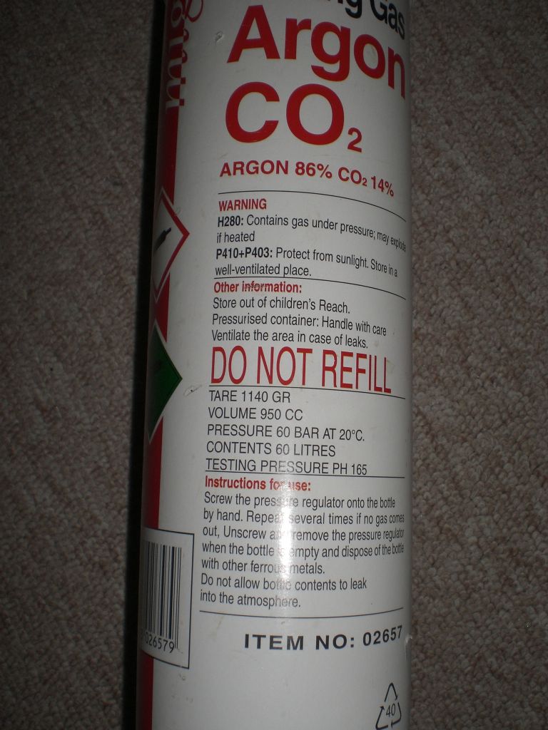

                              Sort-of relevant to the thread: I have an argon/CO2 bottle with my MIG set and it says "Do not let the contents escape into the atmosphere" or words to that effect (I can't check it at present).
                              Given that the gas was obtained from the atmosphere in the first place, what's that all about?

                                      Hi, I have a 60L one that states the pressure at 60Bar at 60 C. Testing pressure PH 165, I doubt many home compressors will reach very near that pressure and I have welded a BSP socket onto a couple in the past to get a little extra reserve pressure for a paint spray gun which have had 160 PSI in them without any problems. But of course we do these things off our own bat as long as no one else is put in danger.
                                      Regards Nick.

                                        Posted by Georgineer on 17/01/2021 15:30:22:
                                        George B.
                                        NDIY mentioned the effects of breathing it, which in volume could be nasty. A lungful of 14% Carbon Dioxide would disrupt the breathing reflex and Argon is a suffocating gas – no oxygen. Knocking the top off would cause the cylinder to fly about, and rapid release of gas causes a strong freezing effect. I suppose you could lose all your teeth, choke, and have frost-bitten lungs!
                                        Not very likely a little bottle would do all that but I guess the sellers want to be sure they don't get sued.

                                              Nick's bottle says "Store in a well-ventilated place" and "Ventilate the area in case of leaks", which both make sense.
                                              However, it also says "Do not allow bottle contents to leak into the atmosphere" in the Instructions for Use. We're obviously not talking flying bottles or huge build-ups here. I'm still as puzzled as I was why they use that wording.

                                              Nicholas Farr
                                                @nicholasfarr14254
                                                Hi, as GeorgeB says, it is puzzling, the very intended use allows it back into the atmosphere. However both Argon and CO2 are heavier than Air, so in a small unventilated space, it can build up to an unbreathable atmosphere especially if you get through two or three of them in a short period of time.
                                                Regards Nick.
