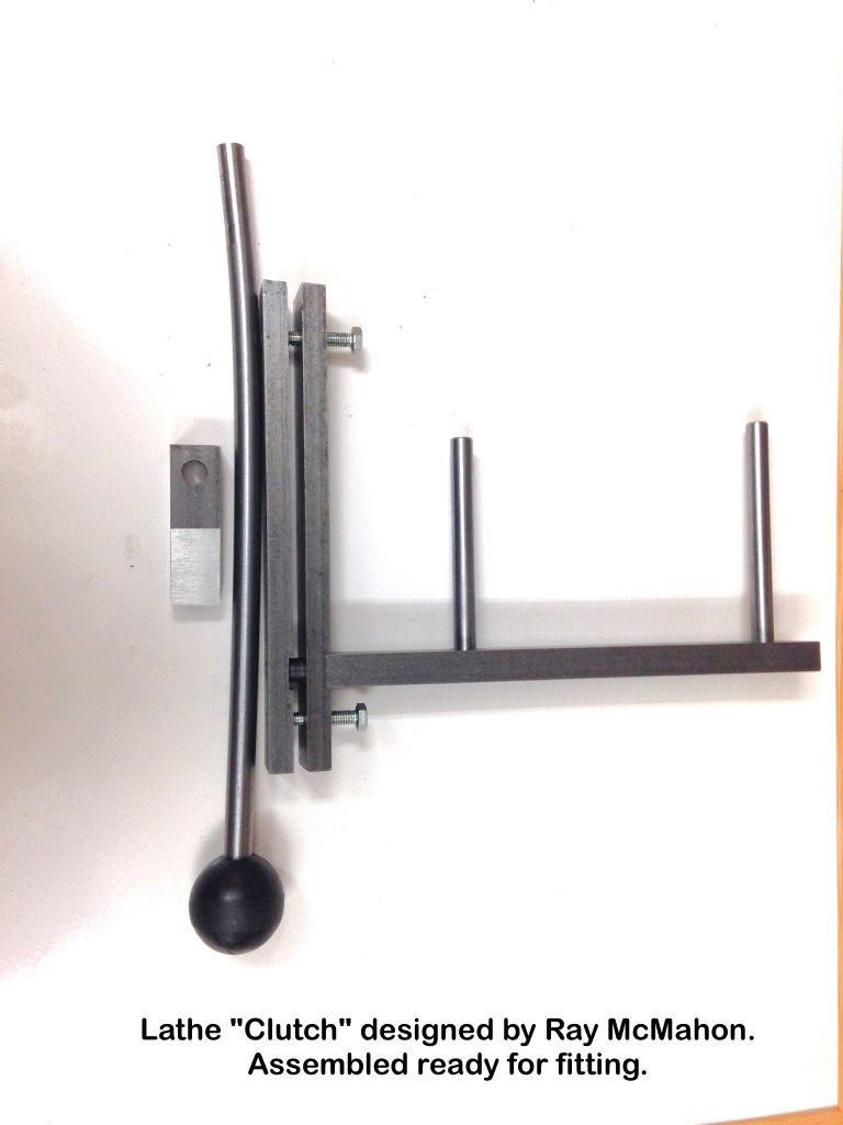

                        Howard Lewis
                          @howardlewis46836
                          Slackening the belt, to use it as a clutch, is not unusual, on all sorts of machinery.
                          Some time ago, a simple modification, used slackening the belt as a form of clutch on the Warco BH600.
                          IIRC it was designed and made by Brian MacMahon.
                          For anyone who wants to look through back numbers of M E W , it could be implemented on any of the clones of the Taiwanese lathes, such as the Chester Craftsman, Engineers Tool Room, BL12 – 243 etc.
                          Something similar could be applied to almost any lathe using V belt drive, possibly even flat belt drive?
                          Howard

                                    #551950
                                    OuBallie
                                      @ouballie
                                      Ray MacMahon device in action on my BH600G:
                                      Warco BH600G Clutch
                                      The lever was my ‘design’.
                                      Geoff – Play halted due to my stupidity.
                                      Edited By OuBallie on 30/06/2021 12:18:10
                                      Edited By OuBallie on 30/06/2021 12:19:06
                                      #552046
                                      Howard Lewis
                                        @howardlewis46836
                                        Thanks Geoff for correcting my half right memory!
                                        At least we both had the same device in mind.
                                        How's the Seven rebuild progressing? Give us an update, please
                                        Howard
