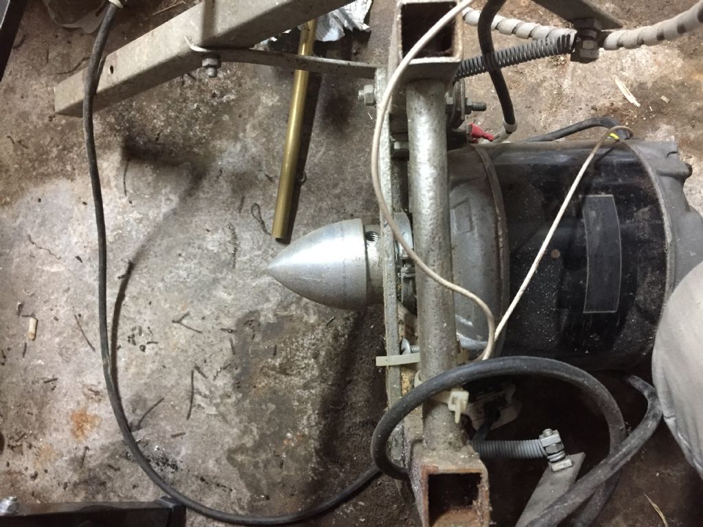

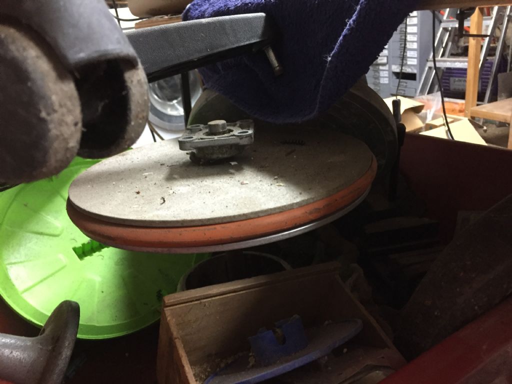

      I'm having a bit of a clearout and want to get rid of a potter's wheel which my wife bought some years ago. It has a 10 inch wheel head (potters' jargon for the the bit they bung the clay on) driven by a 250W motor though a cone / tyre drive to give variable speed:
      I understand that this is a true and trusted design but my problem is that it has been so badly implemented (bits held together with rusty bolts and cable ties!) that I can't in conscience sell it on as as is.
      I'm wondering about replacing the mechanically complicated cone/tyre arrangement with with a 3-phase motor and VFD, but I don't know enough about the low speed torque performance of these things. I had a look around and found a pottery wheel supplier who says:
      "The Bailey wheel is powered by a super smooth, super quiet 0.5hp motor controlled by a computer-enhanced VF drive. This unique design delivers a peak equivalent of 1hp under heavy loads to give constant, smooth power throughout the speed range."
      In the specs the the speed range is given as 0-280 rpm. I'm confused! What does 'peak equivalent' mean? What does 'computer-enhanced' mean? Can VFD/motor combinations actually deliver the rated motor power at, say,10 rpm?
      If anyone can explain or point me to educational material I'd be grateful.

          First, you won't get your money back if you put in a three phase motor and VFD. It's like an old car, you might put in a new engine but you will still only get an old car price. Sales people don't normally have consciences, they find them an unnecessary burden!
          Second, marketing BS is not necessarily rationally explicable. Peak power is pretty meaningless. Power is the rate of doing work, if you store energy in a flywheel and then dump it into a load, you get a very high peak power but the average is still low. The advantage of the vfd is that the torque of the three phase motor will be smoother and higher than that of a single phase, if your wife wanted to keep it and use it the VFD would be a good idea.

                  The Bailey wheel is likely to be powered through a gearbox with the motor controlled by the VFD.

                    Thanks. I have a gearbox ( from a Clarke bench grinder) which takes 2-pole motor speed down to 135rpm and I had it in the back of my mind that I could somehow deploy that with a new motor / vfd to get the right torque /speed characteristics for this application. But reading your replies in the sober light of day, well, you're right. It would be quite a lot of work to make the mountings for the new motor and gearbox, apart from the cost of the parts. And all I'd have for it would be a glow of satisfaction which would soon fade. I'll just bung it back together with proper fasteners etc. Might bring back some of the 300 quid it cost (second hand) that way. And then I could put the money towards a VFD for my lathe, which would give a longer-lasting glow I suspect.
