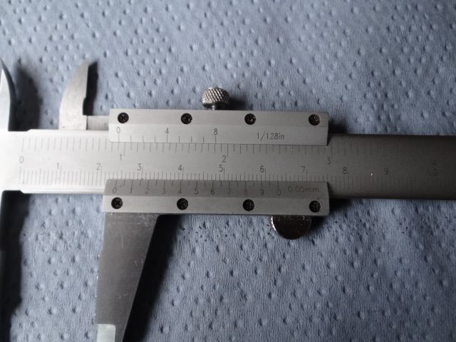

            I have one of those too. It's kept upstairs for rough work when I'm playing electronics.
            The main trouble with this one is reading the vernier. The picture demonstrates parallax error very well – the camera must have been off centre. Actually, from directly overhead the reading is closest to 24.05, but it's hard to tell the difference between this and 24.1 or even 24.15. A magnifying glass helps.
            Much better than a 6" rule though.

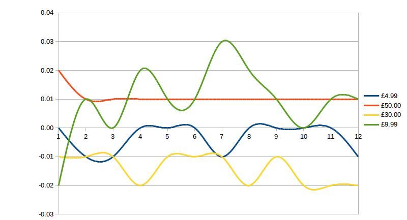

                        I spent time learning just how much thumb-wheel pressure to apply to each Digital Caliper. A bit of practice and careful positioning of the jaws makes quite a difference. Three Calipers work best with the same firm pressure, the fourth (£10 model) works best with a gentle touch.
                        Unlike the first round of measurements, the Calipers all spent the night in the same room to make sure they were soaked to the same temperature, 18℃.
                        I took extra care to clean the Calipers generally and also by sliding clean paper between the jaws. Even though the Calipers were cleaned yesterday I was able to remove more dirt. The precision parallel and worktop were cleaned and clean paper was laid on top. I wore new latex gloves and a clean apron.
                        I took care not to touch the parallel or Calipers more than necessary. As it took 20 seconds to enter the result of each measurement the Calipers had some time to cool off after handling. This is based on Neil's hint that the electronics are temperature sensitive.
                        I took twelve measurements each of the 24mm dimension and graphed the variation from assumed truth, ie ±24.00mm
                        • The red line is the most expensive caliper. It is by far the most consistent but it reads 0.01mm high. Mean 24.011.
                        • The blue line is the cheapest caliper. It reads closest to 24mm but has a tendency to read 0.01mm low. Mean 23.997.
                        • The yellow line is the £30 caliper. It's not quite as consistent as the blue line and reads slightly lower too. Mean 23.987.
                        • The green line is the worst performer. It's the £10 DIY store caliper. Mean 24.015 but notice that wavy line which is not good.
                        The surprise is just how good the £4.99 caliper bought from Lidl is.

                        Measuring with jaw tips only looks to be less accurate and it also seems as if measurements taken at 6mm are more accurate than those taken 24mm. I haven't done the graphs yet but will post them later if they're interesting enough. It would be nice to see the expensive caliper measuring equally well across the range whilst the cheaper ones don't.

                            It helps to have realistic expectations when testing calipers:
                            http://www.mitutoyo.co.uk/hometabs/top-rated/500-196-30
                            Only the green one is outside the Mitutoyo +/- 0.02mm spec on that graph.
