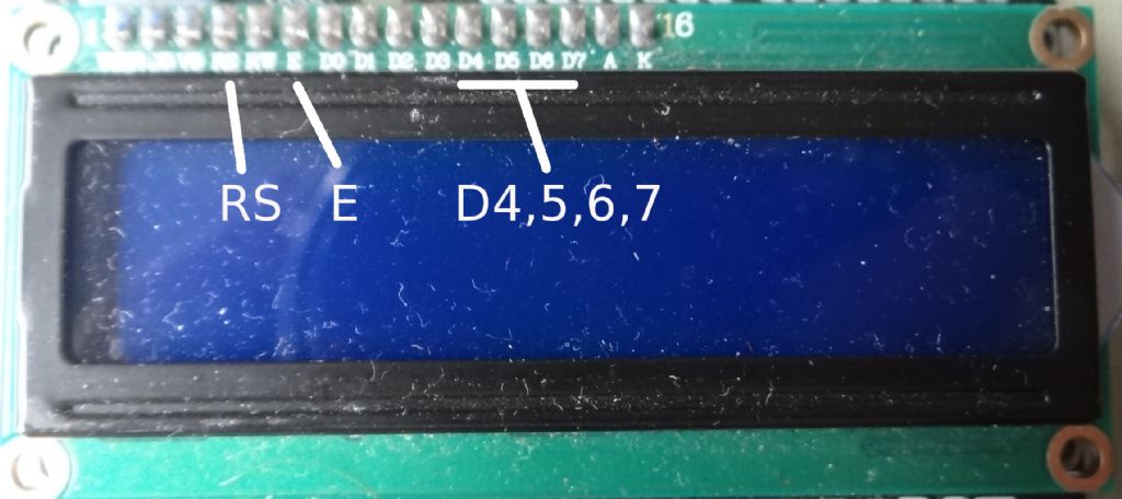

          Hi Ken,
          What you have is very similar to Bob's sketch so it should work. 3 statements need looking at.
          First, fix a bug by changing:
          value|= 1<
          to
          value|= 1L<
          Secondly,
            lcd.begin(20, 4);
          This means that the connected LCD will have 20 characters on each of 4 lines. If your LCD is the more common type with 16 characters on 2 lines type, change the statement to:
            lcd.begin(16, 2);
          Thirdly,
          LiquidCrystal lcd(6,5,4,3,2,1);
          This defines which pins on the arduino the display will be wired to. It means:
          Pin 6 on the Arduino will be connected to 'RS' on the LCD
          Pin 5 on the Arduino will be connected to 'E' on the LCD
          Pin 4 on the Ardulino will be connected to D4 on the LCD
          Pin 3 on the Ardulino will be connected to D3 on the LCD
          Pin 2 on the Ardulino will be connected to D2 on the LCD
          Pin 1 on the Ardulino will be connected to D1 on the LCD
          I'm not keen on that because Pin 1 is also used by the Arduino's Serial Interface. There will be bad behavior if you try and use the Serial monitor. Instead I'd use 7,6,5,4,3,2 e.g.
          LiquidCrystal lcd(7,6,5,4,3,2 );
          Also, because the caliper is already using pins 7 and 8, we should move the clockpin. That is change,
          int clockpinX = 7;
          to
          int clockpinX = 9;
          and move the caliper clock connection from pin 7 to pin 9 on the Arduino.
          Hope that makes sense.

                              #315310
                              Ken Weeks
                                @kenweeks58536
                                Hi All
                                Having read all the post' and installed the Arduino software on the computer, I have produced a schematic and code for a single axis DRO.
                                The suggestions made by Dave were incorporated
                                Caliper input moved to D8 and D9
                                The outputs on the Arduino to the LCD moved up by one
                                Arduino 1 now 2 D1 on the LCD
                                Arduino 2 now 3 D2 on the LCD
                                Arduino 3 now 4 D3 on the LCD
                                Arduino 4 now 5 D4 on the LCD
                                Arduino 5 now 6 E on the LCD
                                Arduino 6 now 7 RS on the LCD
                                I have attached the code schematic in a seperate postand and would appreciate comments/suggestions

                                  #315329
                                    Hi Ken,
                                    A few comments:
                                    • The schematic looks good. I see you're using a bidirectional level converter module. I have no experience of them but the spec implies they're intended to do 3.3V to 5V rather than 1.5V to 5V. It may not matter in practice but if you happen to get erratic decoding it may be down to the level converter.
                                    • The code is a bit mangled, very possibly as a result of publishing it on the forum.
                                      • void loop() starts with PAC X, which won't compile. (I just commented it out)
                                      • A few lines inside int decode() there's a line starting '>if'. The sketch compiles OK after the '>' symbol is removed, .
                                    • Also at the end of int decode(), the switch(axe) construct is unnecessary because there's only one axis. ( The switch becomes useful if a second axis caliper is added, and no harm is done if you leave it in. )
