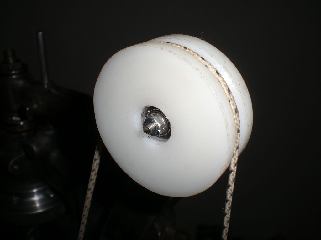

                                  Hi, you can always use one of the platters to make a rough and ready compass, should you be taking one apart in the middle of nowhere, but you will need a container to hold some water and a method to mark the compass points on the platter.
                                  The bearing in the actuator arm are very usable. I used one in a plastic guide wheel on my "Tapping and Drilling Machine" which was described in MEW 238.

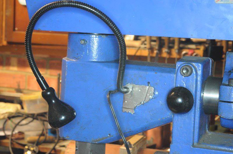

                                            The magnets are very strong. I've attached them to Janso lights on both the drill and milling machine. The co-efficient of friction between the plating on the magnet and the painted iron of the machine is very low so, although the magnets stick very well, they are inclined to rotate so that the C of G is at the lowest point. A bit of duck tape stuck to the magnet cures that.
