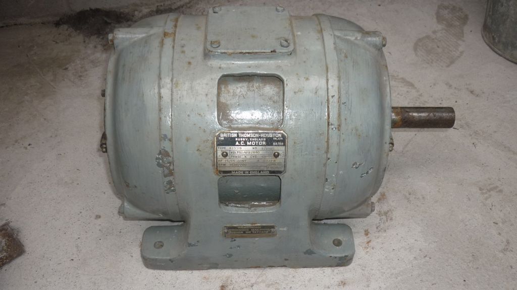

        Hi all,
        I have the chance to buy a Deckel FP1 Mk2 and I'd be grateful of the forums view on these. The research I have done on the internet suggests it's a very capable piece of kit that will grow with me as my machining skills increase.
        It's in fair condition, mainly covered in old grease. Some paint loss as you would expect, but the ways move smoothly and I cannot see that there is a lot wrong with it. The motor has a two two speed box, with the slow speed going slower than the brass plaque suggests (according to my handheld tachometer) and the upper one higher (two speed seems to be 2,500 rpm, when the plaque suggests it should be 1,900 rpm). Which leads me to wonder if the motor is not original. Now the motor is a beast of a thing, at least as deep at the mill itself. To replace this would be great, as it would make the footprint smaller. However, what size motor would I need for this? I am trying to replace the motors in my studio with 36v motors, so that things run off solar panels. So far I have done one of the winding machines with a 2800 rpm 1/4hp belted down 3.5:1 and I am about to try converting the Frederick Pollard & Co twin headed pedestal drill press with a 2800rpm 1 1/3hp motor belted down to 2:1 (the original was a 3/4hp).
        So any thoughts on the above very welcome, either feedback on the mill itself or thoughts on the type of motor power required.

          Hi James ive just restored a Alexander toolmaker ,which is almost identical to the Deckel,in fact Alexander was selling/making Alexander/ Deckels under license until the outbreak of WWII. Mine is only the 2 lever type which uses changewheels for feed speeds. Yours will have four levers i think so no messing with changewheels.
          I have really done anything with mine yet as im still gathering tooling ,as mine didnt come with an awful lot.
          I changed the humungous motor to a 2hp 3 ph and an inverter drive. Cant help with solar powered supplies and motors .
          They are fantastic mills and extremely well built and very accurate.
          You can see mine here in this album.
          http://www.model-engineer.co.uk/albums/member_album.asp?a=42647
          And heres a photo of the massive motor that came with mine a 440v 2 speed job which must weight around 50kg by itself.

                      The Deckel is indeed a very capable piece of kit but, considering the relatively small work envelope, its a big, complex, machine. You also need a fair selection of accessories and considerable skill to exploit its advantages over more conventional machines such as the common Bridgeport or larger bench top mills. Not really a machine for "L plate" drivers as there are plenty of ways to set things up wrong with puzzling results.
                      Biggest issue when its the only mill in the shop is the lack of vertical room. Unlike, for example, Bridgeports Deckels don't do well as mill drills. They are great if you want a hole at an odd angle but for ordinary vertical drilling they just run out of space. Similarily it can be hard to set up for internal milling on a component with walls round the outside. Deckel rotary tables are low profile for good reason. if you look at the various pictures around the internet of Deckels in use you will see that most of them exploit the table movements to bring larger parts up to the cutter. Sort of thing that needs good 3 D visualisation to do easily and remembering to put things back right afterwards.
                      Workspace restrictions aren't a great worry for most Model Engineering type jobs outside the large scale traction engine and big loco worlds so the versatility is a great advantage. On 12" to the foot scale jobs you do have to think seriously about how it will all fit in.
                      Disclaimer. I do mostly 12" to the foot work, have a Bridgeport (but would prefer a Beaver) and a Deckel as a second mill would be great but a Deckel on its own would never do.

                            May I just add that [subject to nothing important being broken, missing, or clapped-out], there is no substitute for 'build quality' … and Deckel is up there with the best.
                            You can surely fit a smaller motor [in terms both of physical size, and power], even if that means taking lighter cuts.
                            Good luck with it, and with your venture.

                                Deckels are top notch.
                                Might you be best using the 1 1/3hp motor on the Deckel and fitting a smaller (& cheaper) one to the drill press. You REALLY don't need that much power for the work you're considering, especially steeped down 2:1.

                                  Believe it or not, I actually use motors designed for scooters. They are 36v and so fit in the system without the need for a transformer and they are very economical (c£60). The down side is that (at the moment) the supply of them seems a bit hit and miss. I was looking for a 3/4hp motor for the drill press, but couldn't get hold of one. So I bought the 1 1/3hp one. Eventually, if I can get the 3/4hp, using this on the mill is a good idea Neil.
                                  I've not looked into the spindle speed of the Deckel, but I assume that the motor will also need to be stepped down 2:1, maybe a bit more (usually the things were designed to run with 1425rpm motors and at 36-40v the scooter motors tend to be around 3000rpm). So presumably that will be enough ooph. Obviously I don't know the long term life of these motors, but their biggest nemesis tends to be over heating. This can be improved by taking it apart and drilling air vents, but given that I have the duel concern of using as little battery as possible I fit foot switches to all machine (also a safety feature) so that when not in actual use the machine is off and hence has a chance to cool and isn't using battery. I realise this is something I might want to give more thought to on the mill, where it is going to be on for longer periods.
