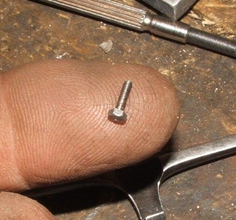

              Yes 8BA is pretty small, some of the parts use 10BA !!!!
              #75536
              Terry Lane
                @terrylane
                It’s all relative – sometimes even 10 BA can be huge!
