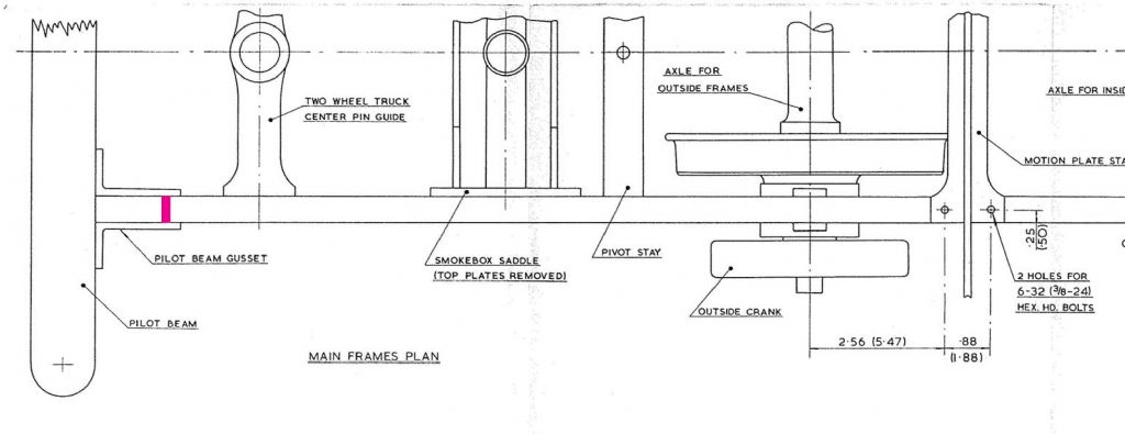

        John – a 7/8 forum acquaintance in the US scaled the plans to 7/8 scale. I have just measured the gauge on the drawings, it's 42mm, which is 1.65". Does that sound right?
        #278812
        John Haine
          @johnhaine32865
          That sounds even more puzzling, assuming that the gauge is the distance between the rails. If the frames are 8mm thick, total 16 mm, that sounds quite out of proportion to the gauge! For example, what thickness would be used for the frames of a 3.5" gauge loco? Looking around I found a reference here to 3mm frames on 5 inch gauge…
          #278814
          Chris Hammond
            @chrishammond37041
            I'll try and post a couple of images from the drawings before I throw the plans out of the window!
            #278816
            Chris Hammond
              @chrishammond37041

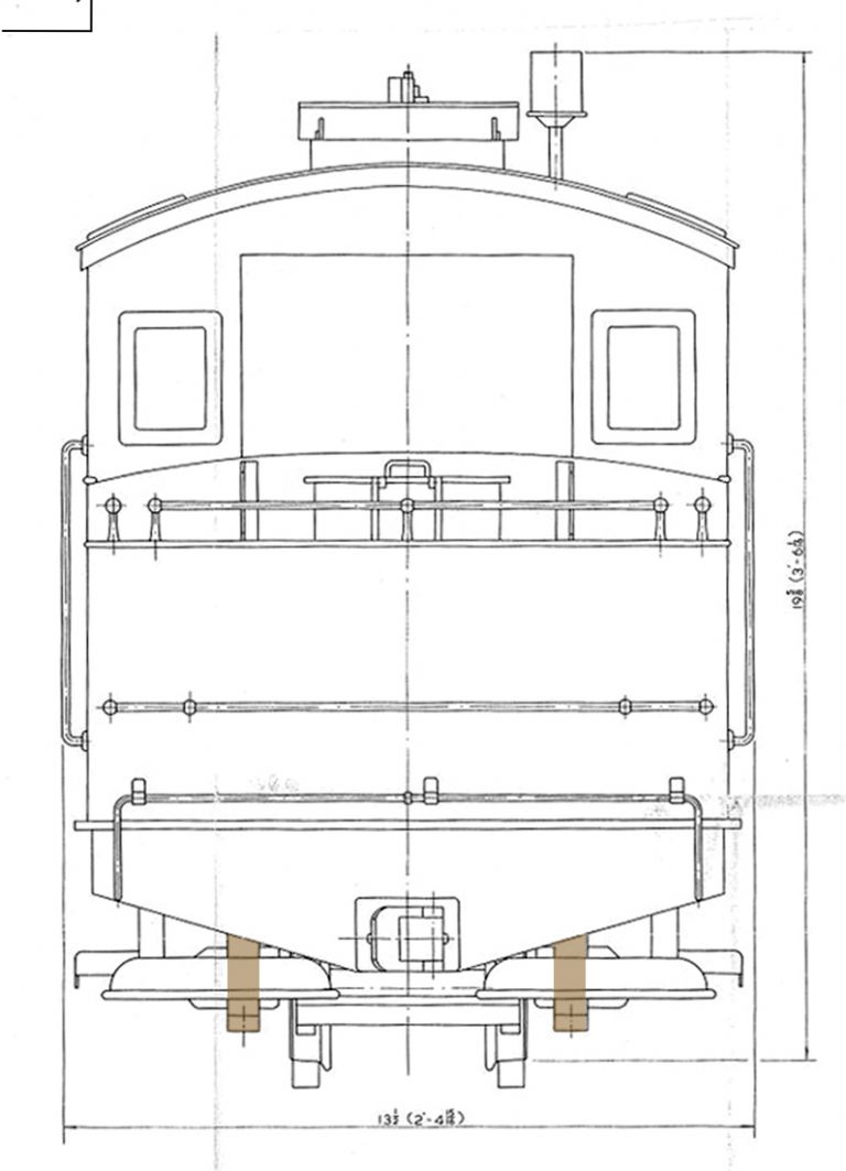

              example2.jpgOk, here goes, finger's x'd!
              #278817
              Chris Hammond
                @chrishammond37041

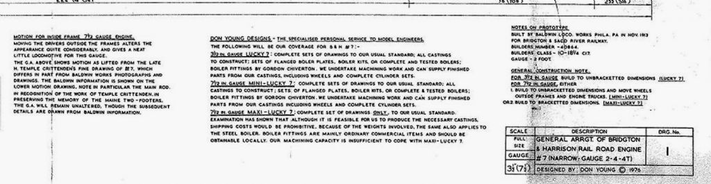

                Ok, so the images are from the plans enlarged slightly by my acquaintance, to 7/8 scale.
                The first shows the info on the plans, which I assume refers to the full size loco (I have no idea how large the pdfs I inherited were, but I am assured they are now correct for 7/8 scale). You can see in the second image, the frames marked in brown. These measure, physically on the printed out drawing, 8mm.
                The gauge, also on the printed drawing, measures 43mm or 1.65".
                Help!
                If any of you gentlemen would like the scaled up drawing jpegs mailed to you so you can help further, please let me know your email address.
                Edited By Chris Hammond on 19/01/2017 15:15:17
                #278822
                  So if I'm thinking right these are the frames for the front 3 axles on your "Lucky" 2-4-4
                  You have Dan's drawings for 7/8" to the foot which should give a gauge of 1.75" as the full size is 2' 0" narrow gauge
                  But what gauge are you building to? have you doubled up his 1.75" drawings to fit 3.5" gauge track?
                  Blowing that picture up until the "brown" bits are 8mm gives a gauge of 45mm, are you sure that is the frame and not the axle box as it sems really thick for  aG1 loco and would need to be a lot more if you ar emaking a 3.5" g loco.
                  J
                  Edited By JasonB on 19/01/2017 16:00:22
                  #278825
                  Chris Hammond
                    @chrishammond37041
                    Jason – no this is a different loco to Dan's, it's not a Shay. This is a Baldwin.
                    I am hoping(!) to build it to 7/8 scale, as per the drawing. Which is, I am told, an accurate enlargement and accurate print (bought from a copy shop I know have calibrated machines).
                    So, there is obviously some discrepancy somewhere as the gauge, when measured with a good old fashioned ruler, is definitely measuring 43mm which is 1.69291".
                    Hmmm,,, that's a good point re whether it's the frame or axle box…. I could have read it wrong (I am very new at this as you can all tell!)….
                    OK, so the instructions on the plan say that that main frames should be cold finished steel or similar, 3.56 x .5 (7.62 x 1.0) nominal section.
                    Does this help?
                    Edited By Chris Hammond on 19/01/2017 16:08:25
                    #278829
                      See my PM
                      So if you are looking at the Lucky drawings then that is for 3.5g track and is 2ft gauge in full size that equates to 1.75 :ft and drawings say frame is 0.5" thick (bracketed figures are for the larger 7.25g lucky)
                      You say you want to make it smaller at 7/8" :ft which is half the 3.5g drawings so frame would be 1/4" or nearest metric would be 6mm thick.
                      I thought you wanted a large model are you sure you want to build for 43mm gauge?
                      Y
                      Edited By JasonB on 19/01/2017 16:18:37
                      #278832
                      Chris Hammond
                        @chrishammond37041
                        Jason – I believe you are 100% correct, so thank you. It does look like I have made a mistake – what I assumed (one should never assume) was the frame, doesn't look like it was.
                        I found another view of the frame, drawn looking from the top, on another page of the pdf, and it measures 6mm wide when enlarged by the same percentage as the other drawings. See pic, the pink rectangle measures exactly 6mm wide.
                        However, this doesn't solve the gauge issue does it. What would you recommend I do? Enlarge the drawings slightly to fit the 1.75" gauge?
                        Edited By Chris Hammond on 19/01/2017 16:23:08
                        Edited By Chris Hammond on 19/01/2017 16:25:17
                        #278833
                          According to an ancient encylopaedia of railway things bar frames may be three to seven inches thick, so in 5" gauge that's roughly 6mm to 15mm thick, and up to 11mm think in 3 1/2" gauge, so 8mm seems pretty reasonable.
                          <edit> Ah 1.75" gauge 8mm is a tad thick, 4-6mm might be closer to scale, if they are bar frames.
                          Edited By Neil Wyatt on 19/01/2017 16:27:52

                              #278837
                              Anonymous
                                As I read it the drawing is for a gauge of 3½" or 7½", so I don't see why they've been enlarged if you're talking about a smaller gauge. The two trapizoids at the bottom of the drawing probably represent the track, the inside dimension will be 3½" or 7½".
                                The numbers you quote for the frames will be the cross section (in inches) for 3½" and 7½" respectively. On that basis for a gauge of 1.75" that gives a frame thickness of ¼". It's bad form, and inaccurate, to scale off a drawing.
                                Personally I'd make the frames from hot rolled steel; cold drawn will end up like a banana.
                                Andrew

                                      #278843
                                      Chris Hammond
                                        @chrishammond37041
                                        Andrew, the pdf was kindly given to me by a friend. I have no idea how big the scans are on the pdf. They don't appear to have any relevance to the measurements stated in the drawing scale boxes.
                                        Therefore, a 7/8 forum colleague in the US enlarged the drawings we have by measurement.
                                        The great news is, at least now something tallies up, because you state a frame thickness of 1/4" and I just measured another drawing and got 6mm which is of course 1/4" (or there abouts). Phew.
                                        Yes I plan to use hot rolled steel for the reasons you state.
                                        I can't thank you fellows enough for all your help. It is wonderful to have such a wealth of knowledge and expertise around.
                                        Please can I ask, if its bad form to scale off a drawing, how else should I do it?
