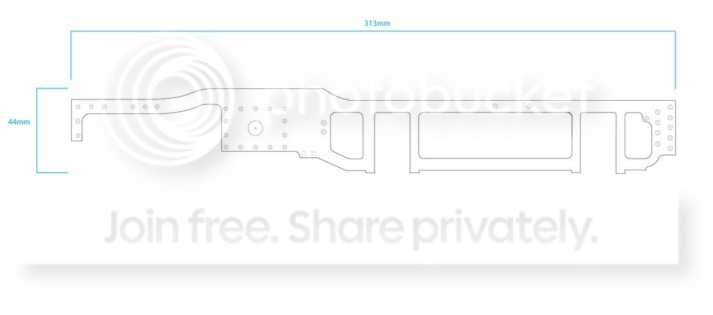

      Guys, some advice for a newbie please.
      How would you go about tackling the cutting of this shape out of 8mm mild steel? I have a manual milling machine, no fancy CNC unforch.
      What would be your recommendations? (I can't afford water jet cutting for the project).
      Thanks.

            8mm – are you sure?
            Chain drill round to rough out, then lots of work with files/angle grinder/mill (if it will fit). By the time you'd finished you'll be thinking that getting it laser or water cut would have been worth it!

                Do all the drilled holes first while you have some straight edges to work from . Then I would work out the position of the holes that will form the various corners of the cut outs and drill them next. You can then remove the metal with a mixture of sawing and stitch drilling.
                If you have not made a set of frames before then usual practice is to start with hot rolled steel not bright as it will be less likely to go bananna shaped. Mark out a couple of holes at either end on one piece then clamp them together and drill as a pair. unclamp, deburr and then bolt or rivit together, this will ensure that the rest of the holes and cuts all match across the pair of frames
                8mm does seem thick for a frame that is only 313mm longcrook

                        By the time you have laid out and drilled all those stitch drilled holes, then cut it out. I would have milled it out using coordinates. There are quite a number of nice corners you could drill (and bore for larger radii), both plates at the same time to ensure they are and remain the same, That top line looks very weak along the top right edge.

                                    Here are a couple of examples of stitch drilling followed by milling which is a method I quite often use on plate upto 25mm thick.
                                    Drill a series of holes who's edge is just inside your cut line, looks like you work in metric so use a 6mm split point drill as that won't require spot drilling first and just wind the mill table along 6mm drill a hole, wind drill, etc. If you get it right the waste will just drop out if not there is very little to saw. Follow by a couple if rough cuts to remove the drilled edges followed by a final full depth pas sto clean up.
                                    In this shot you can also see a boring head being used to get a large internal radius on two bits of 5mm plate clamped together
                                    Same parts after the drilled edges have been milled
                                    Another job this time one 5mm plate, all fixing holes drilled first and larger holes done with boring bar
                                    Hole stitch drilled out and being milled
                                    Doing a curve on the rotary table
                                    Job done
                                    Stitch drilling 25mm black bar

                                        You used to be able to get Abrafiles, a sort of cylindrical saw blade. Taken carefully they will cut 8mm (well I cut 2 off 3mm at the same time on one of my locos. They will start from a much smaller hole than a normal saw blade, and if you are careful you can cut round corners.
                                        If you've got a plasma profiler near you I'd take the drawing and discuss it with him. It's not as accurate as laser or water jet, but just leave a bigger finishing allowance. It's a lot cheaper.
                                        Having said that laser is cheaper than water jet (more expensive than plasma), and with the right machine you can do 8mm.
                                        With all the hot cutting techniques you need to whizz over with a grinder any surface yoiu intend to finish machine.

                                          OK sounds like a bit expensive but basically laser cutting and water jet are costed out the same way. They need to draw it first as costs are worked out on material plus distance traveled and running costs are built into the two of them.
                                          So I took the drawing as a jpg, cleaned it up a bit.
                                          Then saved this as a dxf file which the laser software can read. I have sent this off to my suppliers to get an idea of what it should cost. I'll have that back later tomorrow so if I get time I'll repost with prices.
                                          I have took a bit of leeway on the radius's and curves from the jpg but it will be very close.

                                            In 8mm steel a good quality blade in a sturdy jigsaw will quickly do most of that. Then you could bolt both pieces together and finish them with files etc.

                                                    Jason's method is how I make engine plates for motorcycles, does not take to long at all. With the job marked out with decent scribe lines it is easy to "walk the milling cutter" around the shape. If you master posting photo's show us some progress when you get there. We love photo's so easy to see what people are doing. Chris.
