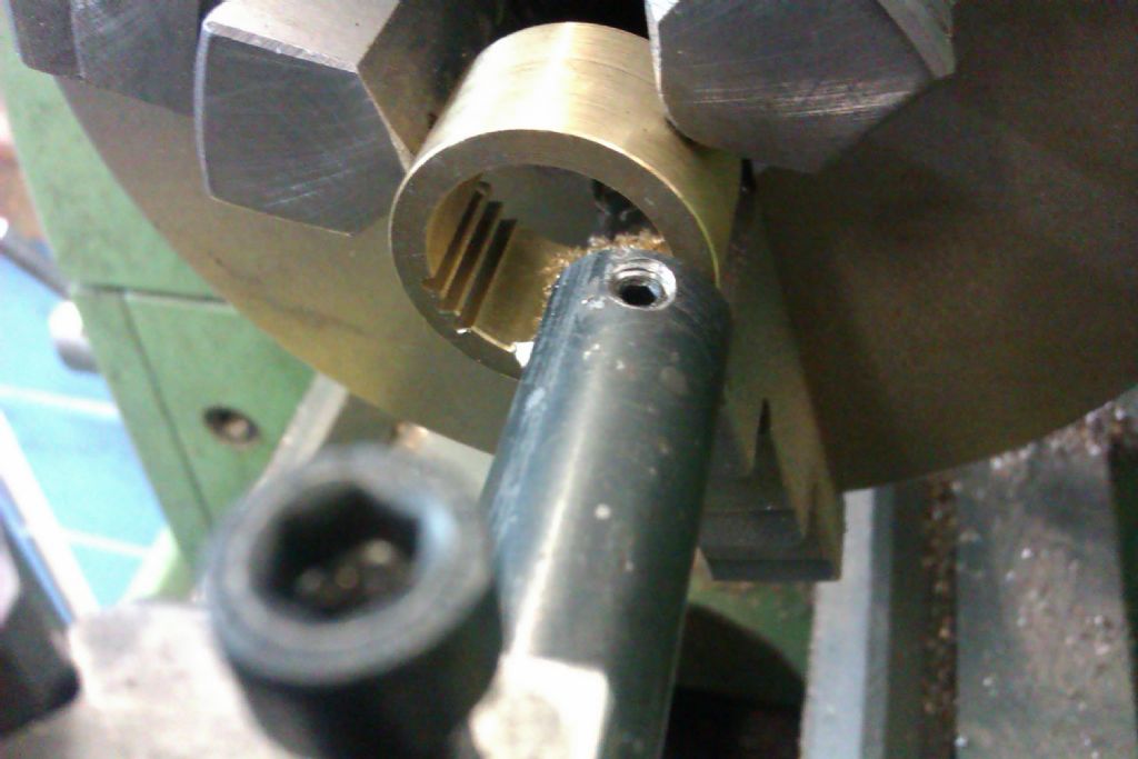

      Is it possible to cut gears on a Lathe if so how would you do that.

          Yes. Two major methods involving different approaches.
          1/ the lathe spindle holds the cutter and the gear is held in some other fixture.
          2/ the spindle holds the gear and is indexed round while a small additional spindle is used to do the cutting.
          Put google into images mode and then enter "cutting gears on lathe" and you will find a mixture of examples. Then add 'youtube' to the end and you get some more.
          Reading that lot should use up most of Sunday for you.

            Both Myford and Boxford had/have their own dividing heads designed for indexing on the lathe with the cutter then mounted between centres .
            Cutter mounted between centres setup:
            Toolpost cutter with gear blank mounted in chuck.

                If your gears are not too large a tooth then you could also index the spindle and use a tool ground to the correct profile to plane the cuts much like a shaper, this is the principal on an internal gear
