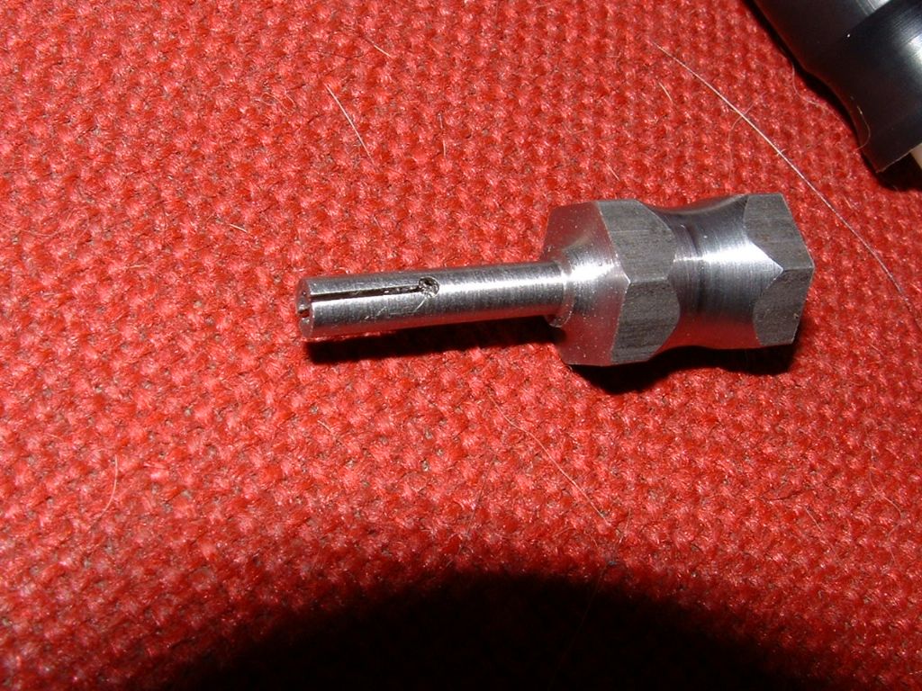

                  On the last gudgeon pin remover tool I made, using an arbor mounted 2.75mm diam saw in a vertical spindle, I bought the slowly rotating 0.50mm thick blade down to touch off the top of the 4mm diameter part held in a horizontally fitted indexing/dividing head, set the Z axis to zero, moved off in the X direction until clear then dropped the blade to below the part, raised the blade to touch off the part and read the Z readout, moved off the part again in the X axis and raised the head 1/2 the recorded distance. Set the spindle revs to 300 and using the X axis moved the blade into the work by the 10mm required with a feedrate of 30mm/min.
                  Using this method evens out any runout on the blade and gives a spot on centre cut.

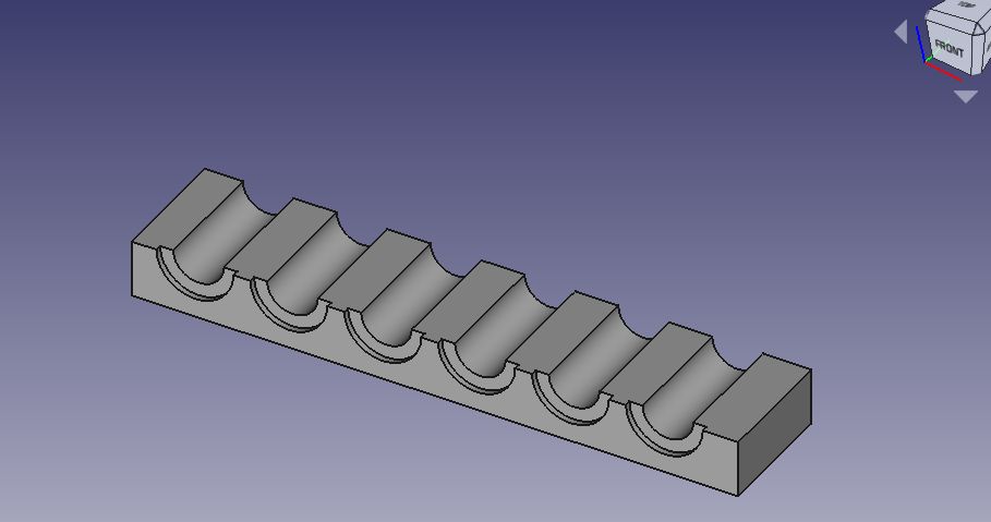

                                          Slotting screw heads one at time would soon get tedious if a large number had to be done. Has anyone tried 3D printing a jig to do this sort of work?
                                          Something like a pair of these sandwiching multiple screws so that all their heads are slotted in one pass of the slitting saw:
                                          My CAD example shows slots 6 on the assumption that the two halves could be held together somehow in an ordinary vice, but for serious work the jig halves would be just shorter than the mill's travel, and held in a purpose built holder bolted to the table.
                                          Making the two halves of this jig in metal would be time consuming rather than difficult, but 3D printing makes producing them easy, even if the holes were tapered and ridged to grip the screws better, and the two halves were jointed together.

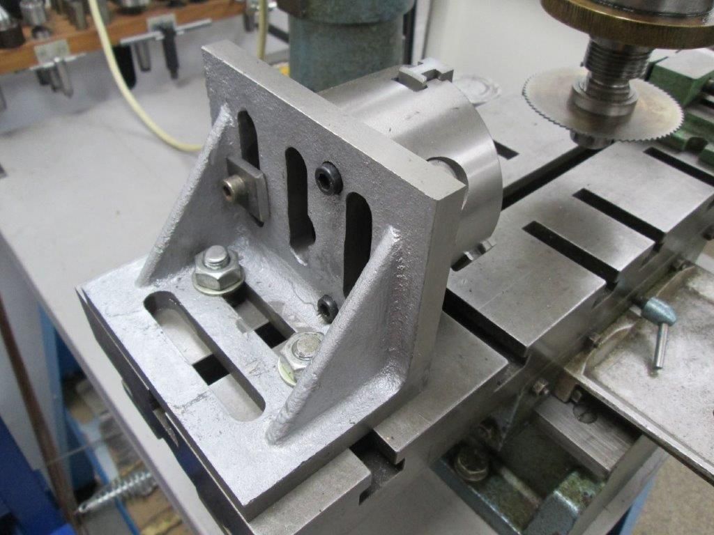

                                                The biggest problem with Dave's jig is that it will hold the heads horizontal if in a vice so you have to use very small dia milling cutters with a slow feed so unlikely to be any faster than a saw. Most of the screws I make have slots of 0.8mm width or less. Unless you have a horizontal mill with rack feed then it would be faster
                                                I usually do them in the spin indexer which is quicker to change screws than having to use spanners on a collet block

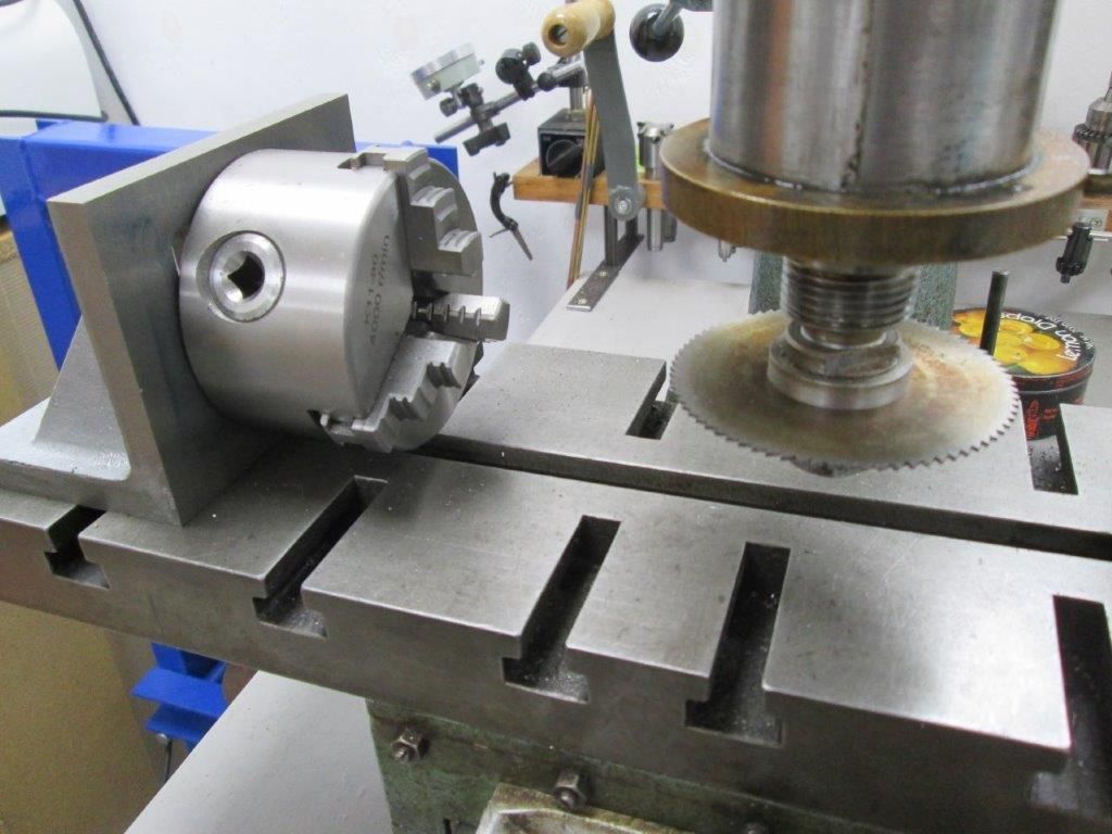

                                                  I mounted a cheap 3 jaw chuck to an angle plate and leave it permanently set up on my D-W miller. No DRO, so I turn a piece of scrap 1/4" rod to form a pip whose diameter equals the thickness of the slitting saw. Then align by eye. If using small countersunk Allen screws, I slot them to allow them to be removed if the hex socket becomes rounded.
