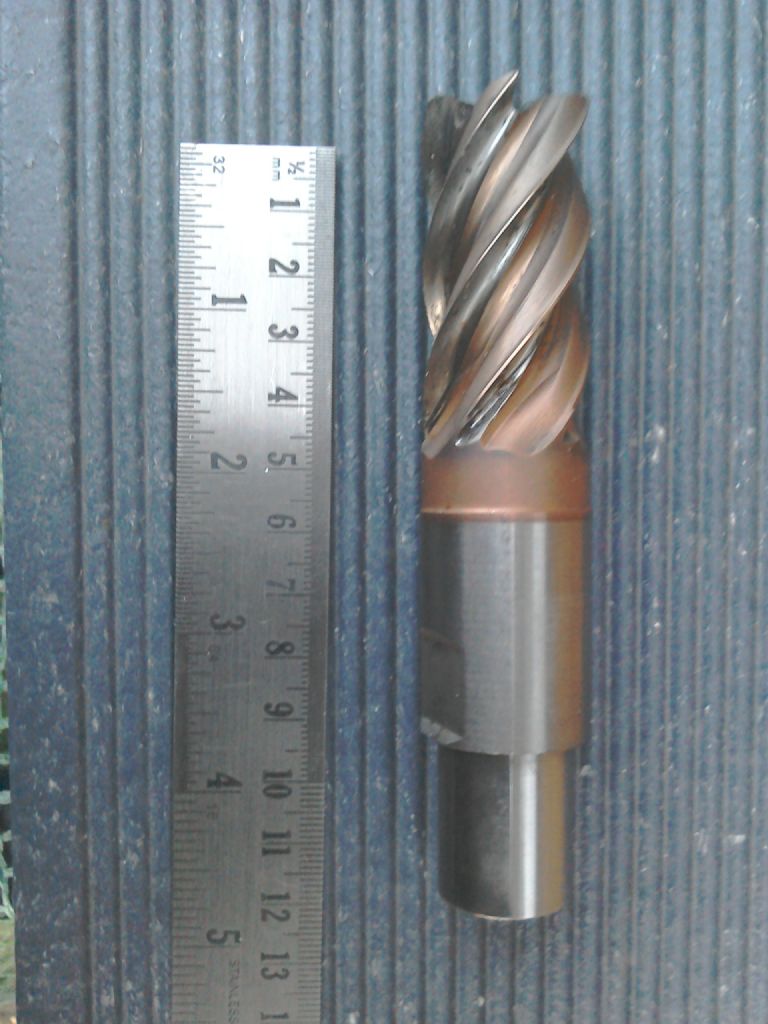

      I have a block of aluminium roughly 100x30x20mm which I need to mill so it will mate onto a tube. So I need to match radius of the tube which is 7/8 of an inch diameter. I have made a mistake by buying a 7/8 ball mill which has a 1 inch shank. I never thought it out and know realise that I cannot hold the tool in the mill. Spindle is MT3 and collets wont take such a shank. I have a lathe but no milling slide so cant go that route.
      I havent tried but I am guessing trying to turn the cutter to a reduced shank size would be futile? Would I be wasting time and tooling trying ? Is there another way to put the radius onto the block? I need to put it down the longest side. I dont want to do it by cutting a V into it I need it to look nice and be a radius.

          I have turned down the shanks of milling cutters using carbide tooling.

                  #238354
                  Martin Connelly
                    @martinconnelly55370
                    Turned down shank on a milling cutter.

                      Thanks for all the replies they are really appreciated. Also thanks Jason B for giving me multiple ways of achieving what I want to do. I will try to turn the shank on the cutter down as that is probably going to be the simplest option but if that fails then I think Jasons option two of cutting it with a bar between centres looks best for me to do. I have learnt some good stuff here cheers.

                        Ady Wilson
                          @adywilson52106
                          Just an update I managed to turn the shank down to 20mm so I can get it in my collet chuck now. Used it and it worked out great. I wont be forgetting the tips given me though as I am sure they will come in handy in the future.
