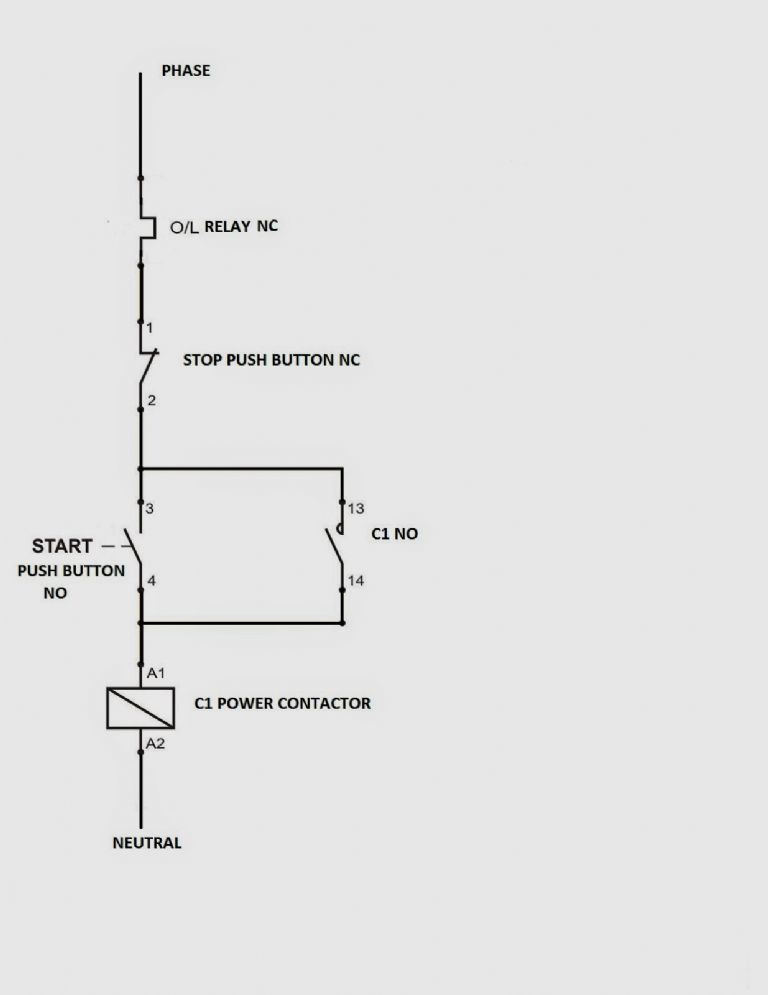

      Hi I'm in the process of modifying / upgrading my Tom Senior M1 milling machine. I've got the new motor and have a new VFD to power it. I was thinking of trying to utilise the original Crabtree B15 Stop / Start switch to switch the 240 volt supply to the VFD, I'm aware I would need to modify it.
      Striped it down today and can see the start contactor and the main coil but can't see how the stop function works. I would have thought the stop relay simply broke the coil circuit causing the main contacts to open but can't see how it does this.
      I wondered if anybody had come across a similar problem.

          the coil is connected in series with the overload button circuit, terminals 95 and 96 this also acts as a stop button when used with its original enclosure. any additional stop button is also in series with the coil circuit. below a genric connection diagram

            Thanks for the circuit diagram Split pin, just checked my switch again and it looks like the stop push button contacts are u/s, they are not normally closed as shown. I'll try stripping it down tomorrow but it looks pretty sealed up. I've got nothing to loose. Thanks again.

              The lid stop button pushes the small 1/4" diameter red piece to the RH side of the contactor to stop, open the contactor.

                Spent 3 hours this morning stripping and cleaning the switch, interesting project. All sorted and dirty stop switch contacts all cleaned and operates great.
                Only problem is it's a 415v switch which I'm trying to operate on 240v unfortunately there isn't enough pull on the electromagnet to pull the contacts hard on and the whole thing vibrates at 50hz. Looks like I'll be putting the thing in my box of museum bits unless somebody knows of a supply of 240v coils.
