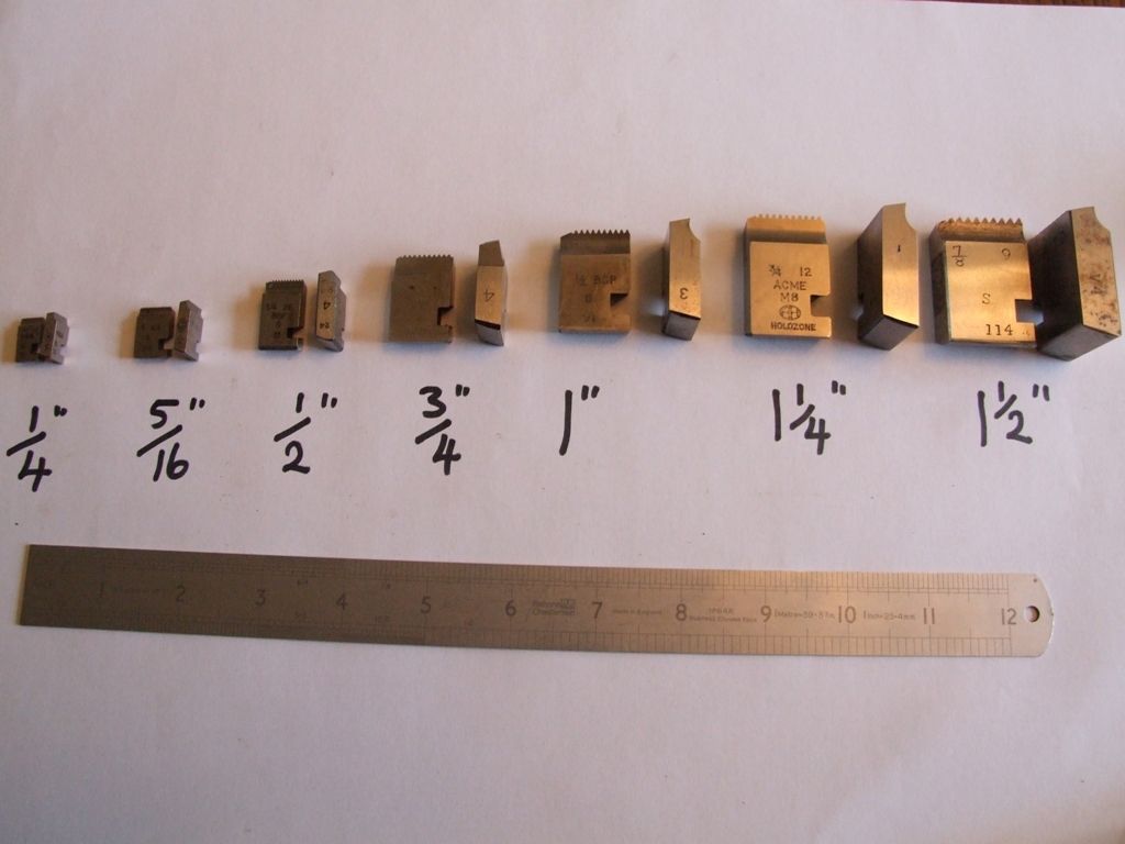

                #251257
                Anonymous
                  Here's a guide I did earlier:
                  Andrew

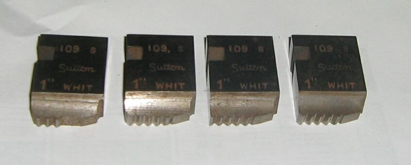

                      My only set of dies

                        #251269
                        Anonymous
                          Posted by hth on 18/08/2016 09:36:51:
                          My only set of dies
                          The leftmost die seems to be missing its cutting teeth?
                          Andrew

                            Posted by Andrew Johnston on 18/08/2016 09:50:10:
                            My only set of dies
                            Andrew
                            Maybe the larger thread sizes are made that way ?

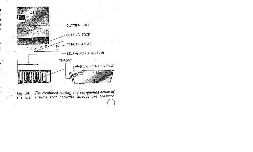

                              The manual explains that the teeth only guide the dies , they behave like a nut, the actual cutting is done by the angled section before the teeth .
                              #251288
                              Anonymous
                                Posted by hth on 18/08/2016 09:59:51:
                                Really? Think about it! If none of the teeth cut how is the thread formed. If you look at a die end on, at the teeth, you will note that the teeth are not parallel to the axis of work rotation but angled. It is true that the teeth at the rear of the die are in front of the rotation axis and do indeed act as a guide pulling the diehead forward and eventually opening it when a stop is reached. The cutting is done by the partial teeth on the throat (angled section) and the first full depth tooth to give the full thread form.

                                  The first one has lost a couple of teeth. It's not supposed to look like that!

                                    manual2.jpgWhat the book says , the teeth guide the die , they don't cut

                                      Posted by Muzzer on 18/08/2016 11:53:25:
                                      it was absolutely made like that !
                                      #251312
                                      Muzzer
                                        @muzzer
                                        If you say so. Did he charge you extra for it?
                                        #251317
                                        Phil P
                                          @philp
                                          It was absolutely NOT made like that from new. It has been made like that by someone after they have damaged the teeth. It is not uncommon to see this sort of thing on second hand dies. I have drawers full of them.

                                              The cutting edge of the dies, is defined by the throat and the first tooth flank .. look at the line on the diagram , it explains it clearly . The text was written by the manufacturers themselves …what more can I say . You guys cannot understand plain English ..

                                                  OK, I reckon this is going to be a silly question but where on the die head body should I look for some inscription that tells me what size it is?
                                                  Best regards,
                                                  Swarf, Mostly!
                                                  #251351
                                                  Anonymous
                                                    Posted by Swarf, Mostly! on 18/08/2016 16:18:54:
                                                    On the dies or on the diehead itself? The dies are not marked with the size of diehead they fit. On the dieheads it is usually on the round, fixed, part of the body. But on my dieheads the engraving/etching is often worn making it darn near impossible to read the size.
