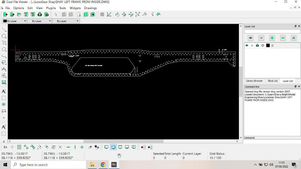

        Hi and help please.
        I've been sent files in dxf and dwg format from the US and my local laser cutter needs them in mm. I don't have any experience with any CAD drawings, can some kind person out there convert them for me please.
        I have them in a zip file so I can email them easily.
        Thanks in advance.
        Steve

            How many of them are there? Can you post a photo of a typical one?

                  A screenshot of one of the files.
                  This is a simple file viewer program and I couldn't see a conversion feature. As this is likely a one off I don't really want to have to buy a CAD program and the free ones seem very limited.
                  The local firm that has done laser cutting for me is very friendly and helpful. The stuff I bring them is very different to their normal massive projects so they deal with me as a cash sale at a discounted price. Very useful. They usually fit my bits in on the edges in the otherwise scrap areas. I can understand they don't want to tie up the programmer or take the risk of it being wrong at the end. Either way I'd be paying for the programmers time.

                                The 'how to' descriptions above are somewhat contradictory, not surprising as all CAD systems have their own foibles. For information the way the 'conversion' was done (in Alibre Design) was as follows.
                                • Open the file (it came is as inches) – check an obvious length using dimension tool
                                • Switch display units to mm (no scaling, no change of size)
                                • Delete dimensions, notes, and other extraneous items to leave a clean outline for cutting
                                • Use Analyse Tool on the drawing – to find problems
                                • Heal the multiple small gaps between figures
                                • Delete overlapping (duplicated) figures
                                • Export as DXF (2007 in this case as some CNC software may prefer older DXF versions) using a name to differentiate from the initial file.
                                • Re-import the exported DXF (as a check) – it came in as mm, and the size was correct.
