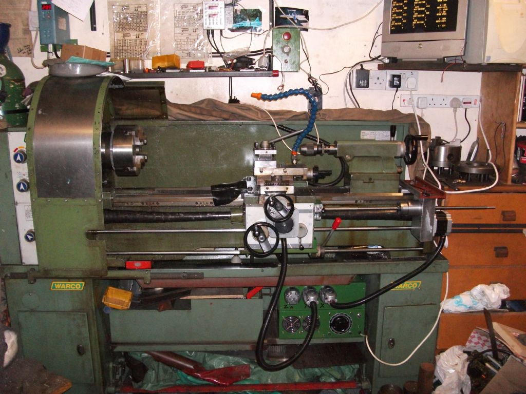

            Hi Duncan,
            I converted my Warco GH 1000 to part cnc use and did not use
            the original lead screw that is on the machine,i made a new lead screw
            that has the stepper motor fixed on a bracket that clamps to the bed
            of the lathe , it appeared in an article in mew in issues 207 through to 212.
            No real alterations were needed to the machine i think i had to drill and tap
            about 5 holes.
            Even has it's own thread on here ,not worth reading as there is nothing
            constructive in it.

                Hi Duncan,
                Here are the original leaflets from 1999 as you can see the GH 1000 swings 13 3/8 inch over the
                bedway and 18 1/2 in the gap.The stepper motor that drives the 10 tpi lead screw came from
                Arc euro and was 350 Ncm 10 mm shaft 3.36 volt 4.2 amp /phase. As i use Compucut
                an early hobby cnc system that is unipolar the output of the motor is slightly less but still
                more than enough to do the job.
                I see from the pages of lathes .co .uk that the Myford 254 has a protusion where the lead screw
                passes through the rear mounting much like the Super 7 lathe.
                I have a super 7 lathe that is also part cnc and is driven this way ,the problems in using the original
                lead screw is the continual movement and wear of a cnc system as this is always going to be up the chuck
                end and also the backlash in the halfnut on the machine,on a gearbox machine such as my GH 1000
                there is also the additional drag of driving this around.
