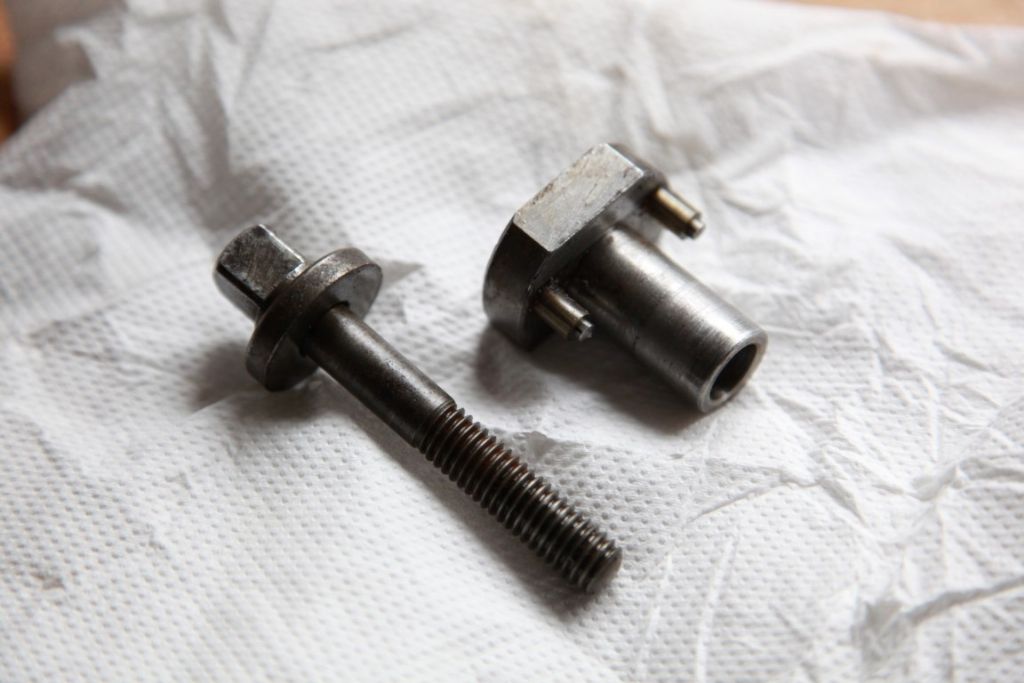

      I have a 6" Student which I am finding my way around. When I engage Surfacing I can get the cross slide to move back and forward OK and can adjust its speed my moving the collar to give me low, off or high on the feedshaft. This works OK but the saddle is not secured and if I engage the saddle lock this engages the lead screw resulting in the saddle moving. Is it possible to disengage the lead screw? I assumed the collar I move to vary speed of feed shaft would have provided that and perhaps its all just out of adjustment or am I looking for something that is not there. Any help appreciated.

          Had another look and a closer look at the manual and it does not appear as if what I want is possible. Will find a clamp to lock saddle as an alternative. Any suggestions?

            The clamp to lock the saddle is on the top on the right hand side with a square head
            No way engaging that should also engage lead screw
            Not sure which collar you are adjusting to give you a different speed
            you can disengage lead screw by putting imp/metric lever into neutral
            you cant disengage lead shaft unless you remove gears

                The lock is the square headed bolt on the top right of the carrage in teh middle of teh photo. Sounds like you have been "locking" the saddle by engaging the screwcutting half nuts on the stationary lead screw

                  Thanks Jason, the mystery has been solved. I had noted that hole but that is all as the part has been removed. Will see if I can manufacture a locking device. Is it possible to provide a close up photo?

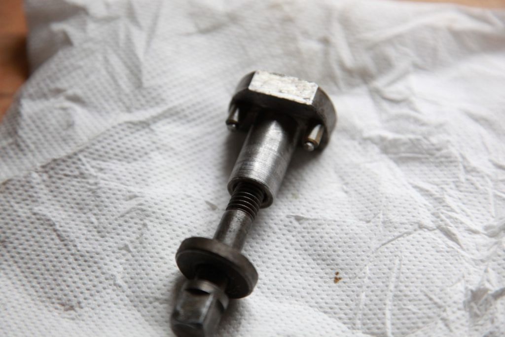

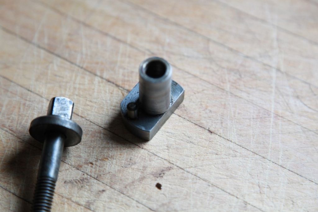

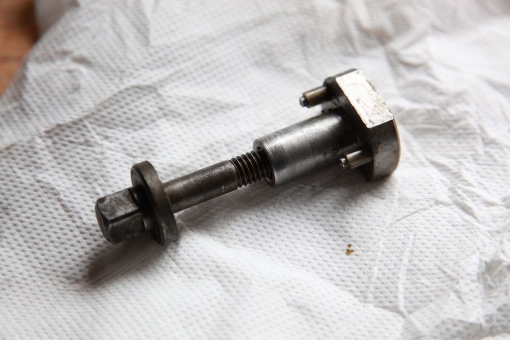

                    img_7368 (medium).jpgimg_7367 (medium).jpgHeres a pic of the locking mech
                    Its ( on my lathe a mk1.5 )
                    The nut is 15mm dia where it slides into the saddle 28mm long
                    the big end is 35mm dia 10mm thick with one side cut flush with the 15mm dia bit
                    the opposite side overhangs by 6mm which engages on the bed slideway
                    the 2 pins are to stop it rotating
                    The bolt is 58mm long under the washer
                    obviously all dimensions would be imperial
                    Is there a pic on lathes of a non gearbox student?
