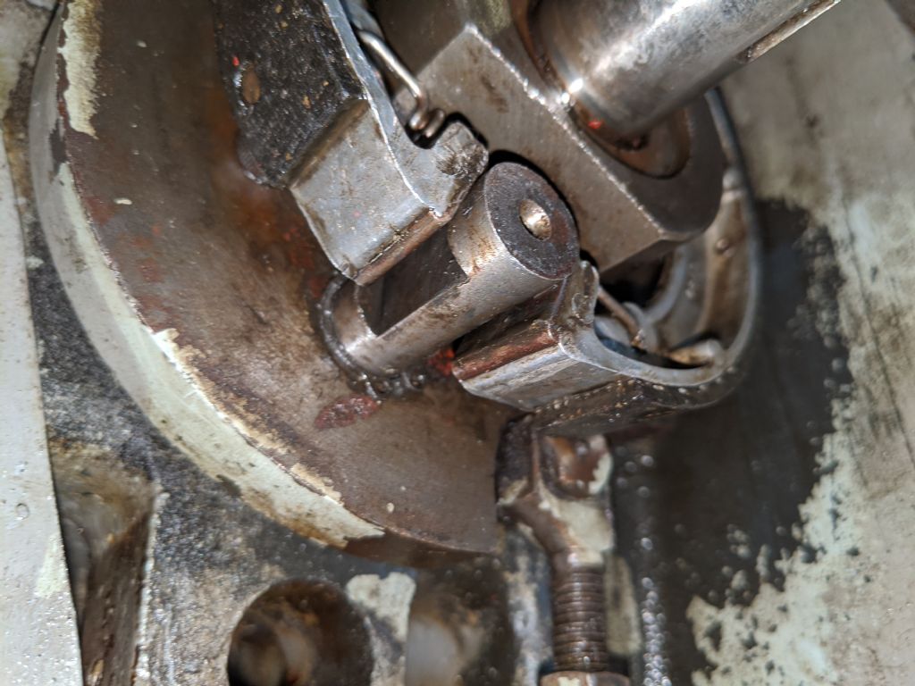

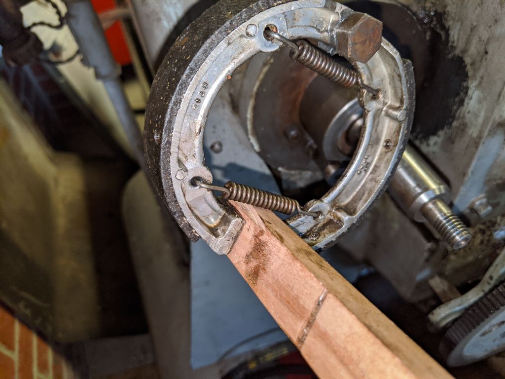

      Drum brakes all work the same. You need a drum brake spring plier to remove the bottom spring first. Then the two shoes will open up and you can undo the top spring.
      Your shoes needs to be replaced. Not expensive as you take it to any brake service place and they glue new shoes on. Ask them to skim the drum as well and then sand the new shoes to match the drum.
      Installation is the reverse of disassembling.

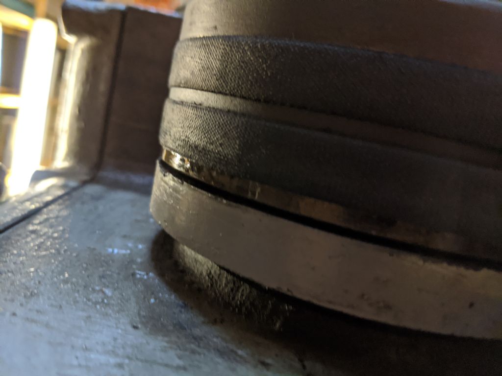

              Posted by Richard Kirkman 1 on 16/05/2020 17:03:01:
              You have a bigger problem now…. your one V-belt is wet with oil. Oil and rubber in a belt do not go together as it will ruin the belt. More so when you have a matched set (which I trust you have). If one belt stretches more than the other due to the oil, or slips, your tighter belt will try to play catchup and hunt causing a vibration in your drive. For this reason I only use Nu-T belts.
              Try and soak the wet belt in some acetone for a short while and rub it with a dry cloth to get the oil out. Repeat until no more oil is on the cloth.
              Also clean the grooves in the pulley and if they are glossy sand the grooves with 600 grit wet sandpaper.

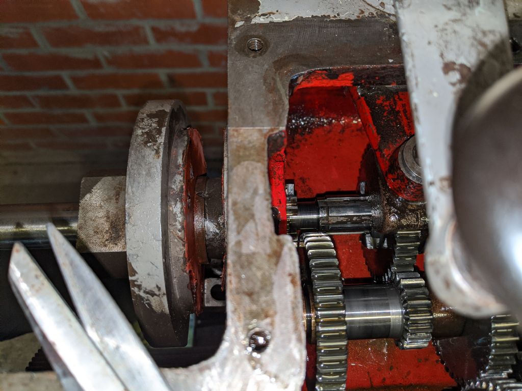

                  Last time I cleaned in there when there was only a bit of oil, they worked really well, so I don't think they need replacing.
                  Speed change shaft is looking very nice Herman. I'm glad I didn't have that much trouble with mine!
                  I had a nap to think on it then headed back out to try again. I managed to get it off, I pried it off at the bottom then undid the screw, while putting a block of wood on to keep it from snapping closed again, so it'll go back on more easily.
                  I'll see if I can get the spare brake shoes from Tracy. It's about time I messaged her again, it's been a month, but I was waiting on the bulb to arrive first so I could finish that chapter.
                  As for the flange/bearing thing, It doesn't seem to want to budge. So I put some penetrating oil on it and I've left it. The 3 screws that came out smelt quite funny, not like a normal grease but sort of sweet maybe? I don't know but it didn't smell normal.
                  I don't particularly want to order a new seal from the spares place as they'll probably charge a small fortune for something that I could possibly make myself? Or perhaps source from elsewhere cheaper?

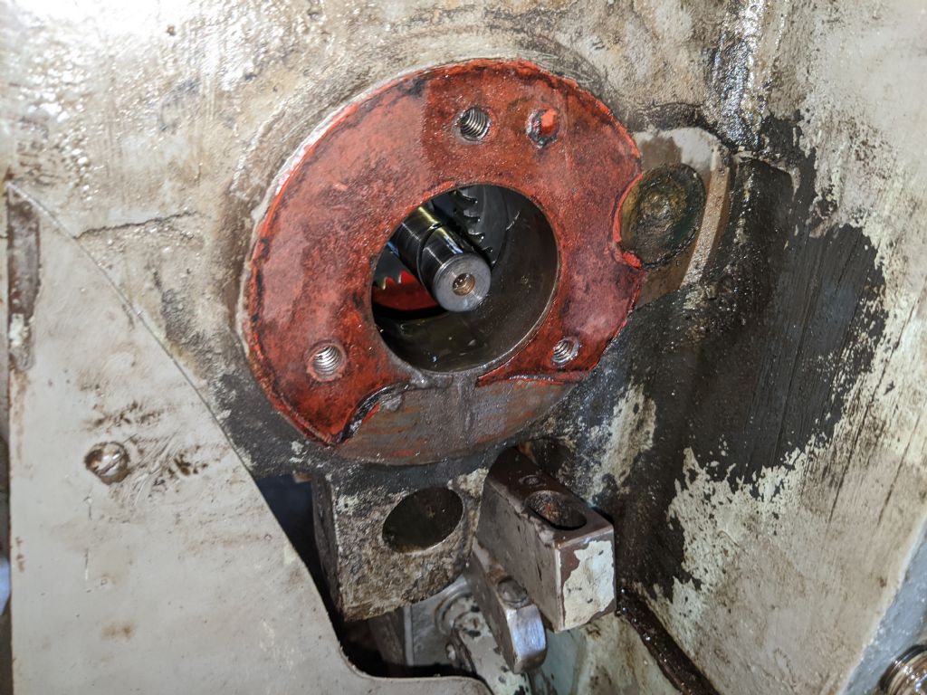

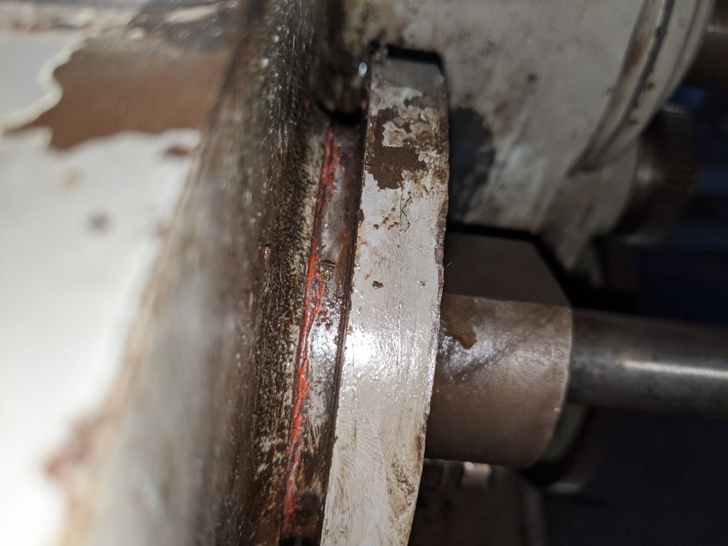

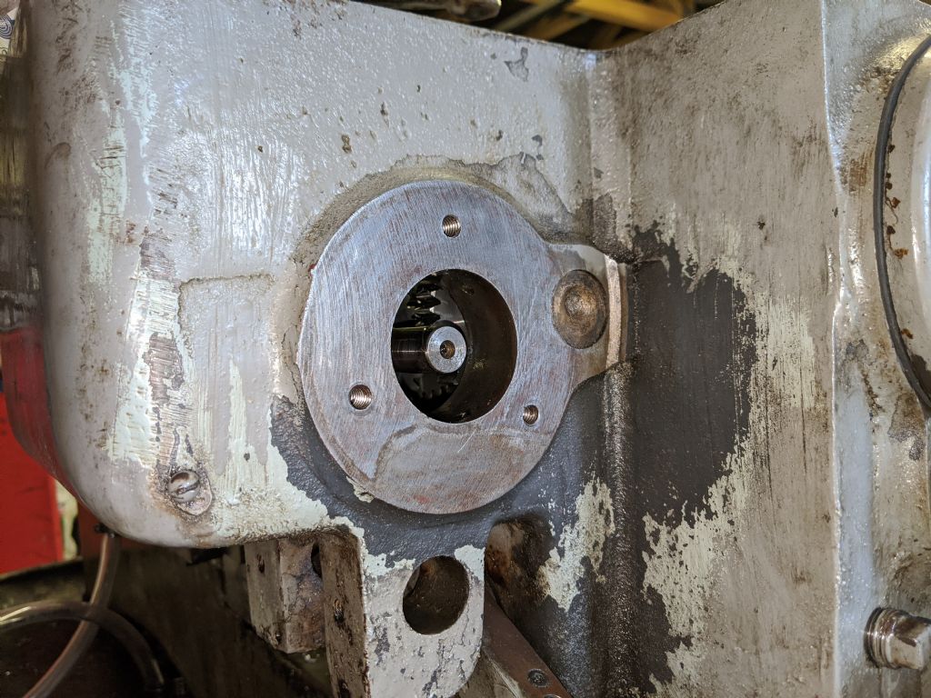

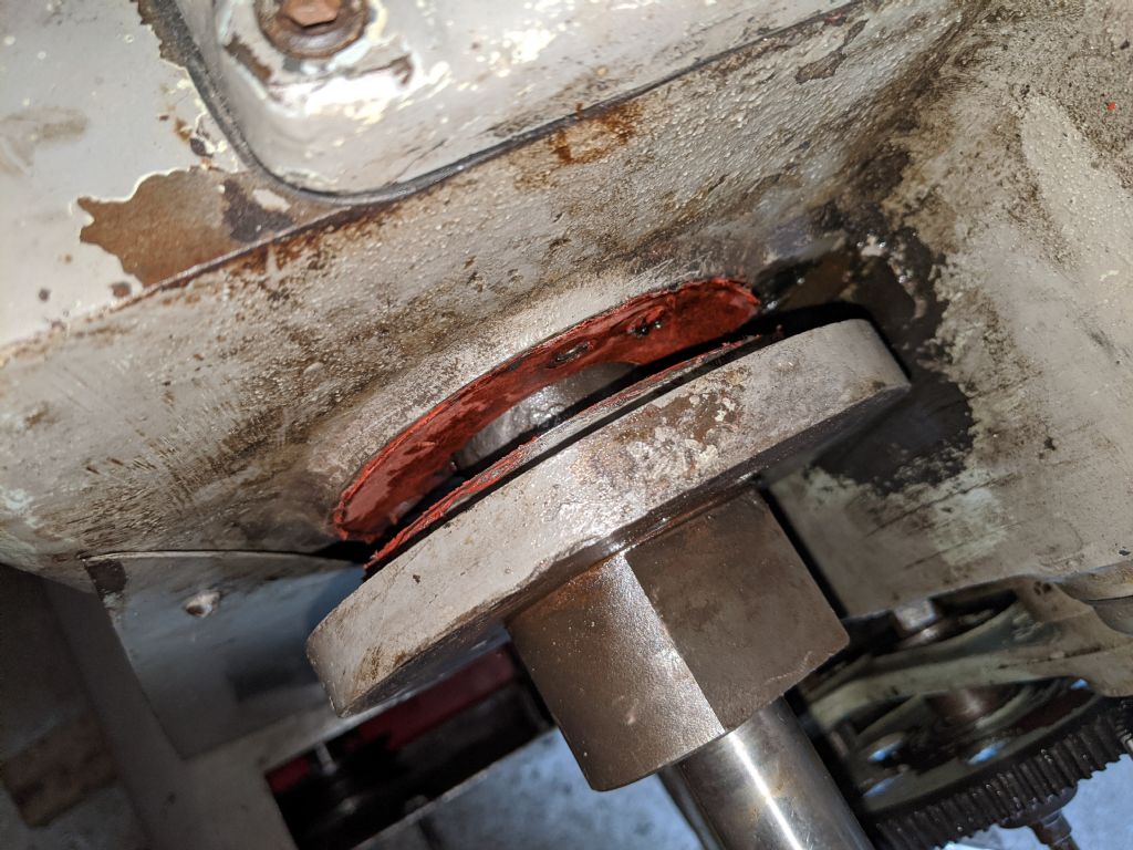

                    A few more pictures to Illustrate.

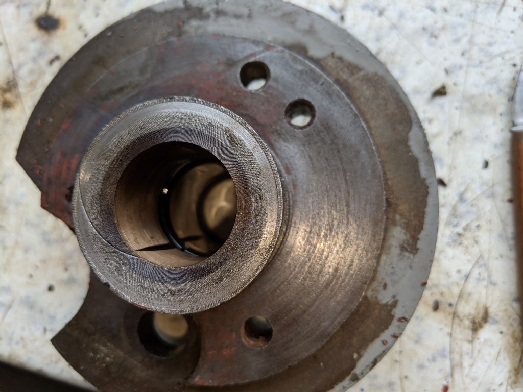

                    There seems to be some red stuff which I presume is the gasket material. I think the bolts had some red on them too
                    Red stuff doesn't scratch away easily. Someone could have added glue to stop it leaking at some point?

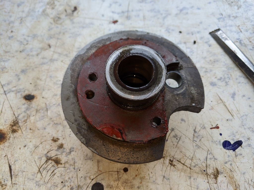

                      My lathe has the cap screws located in the smaller diameter collar that stands out from the larger flange.
                      This is how mine came out.

                        The red stuff is gasket maker. You need to heat it up with a hot air gun and then stick two putty knives in there to wedge it apart while the gasket stuff is hot and soft. Only way to get the red gasket stuff off is to wire brush it with a brass wire cup.
                        You can also make three hard wood wedges and drive these in between the flange you want to remove and the headstock body.

                          Red hermatite gasket cement, thats why it wont come off, it sets, not mega hard like Osotite, but hard enough to need wedges or an extractor to give it a straight pull. Hermatite is non standard on Colchesters, so I think we can guess it has been off before! Can you use a longer bolt in the threaded hole to push against the headstock and gently break the seal?

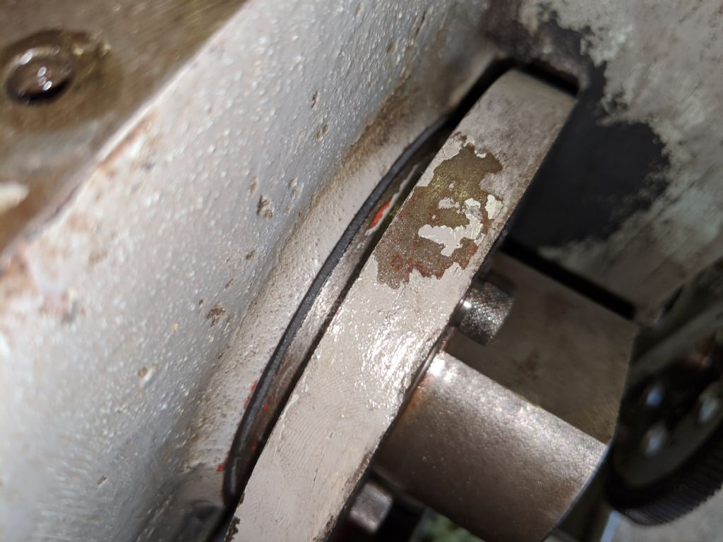

                            Notice the wood bits left over on my last photo. I used three hard wood wedges. Came of easily. In your case, you need heat and patience.

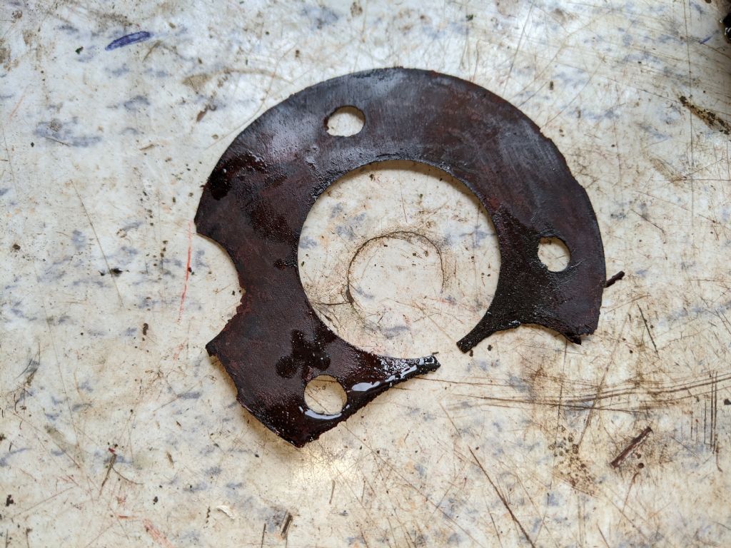

                              We have success!
                              Heated with a heat gun till it was almost too hot to comfortably hold, then just gave it a little pull and it went pop! Very easy. Unfortunately, as I pulled a little further, the inevitable happened, oil gushed out of the hole. So I quickly plugged it back in and drained the headstock. Not something I wanted to do for this, but necessary.
                              The smell is back, so that must be the smell of the gasket cement. Definitely recognizable for the future.
                              I even found the original gasket in there too. It was stuck on very well so I had to use a box cutter blade to slowly get it off, but now I have a template for the next one.

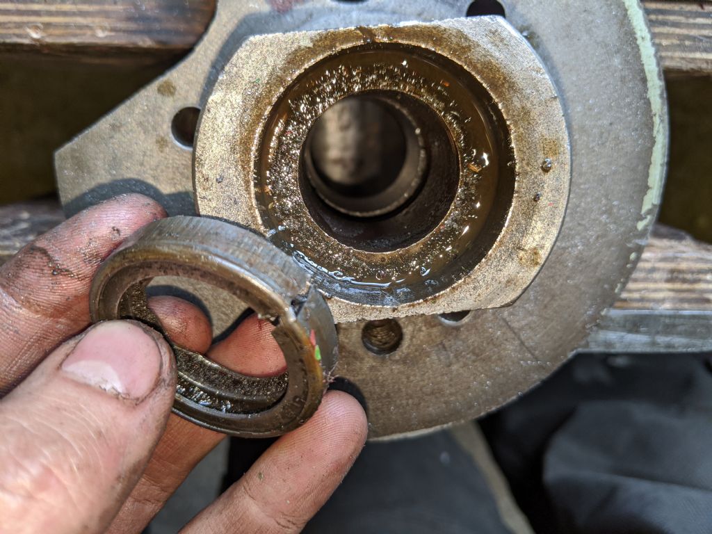

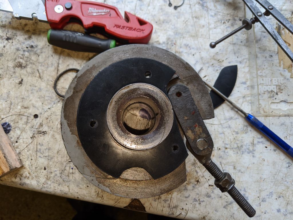

                              So, onto the main problem. The leaking seal. It has a set of numbers on it, but I can't seem to get it out easily.
                              The seal looks pretty shot. Looks like a leather one like the other one I replaced, but thicker.
                              I'll get the numbers from the seal

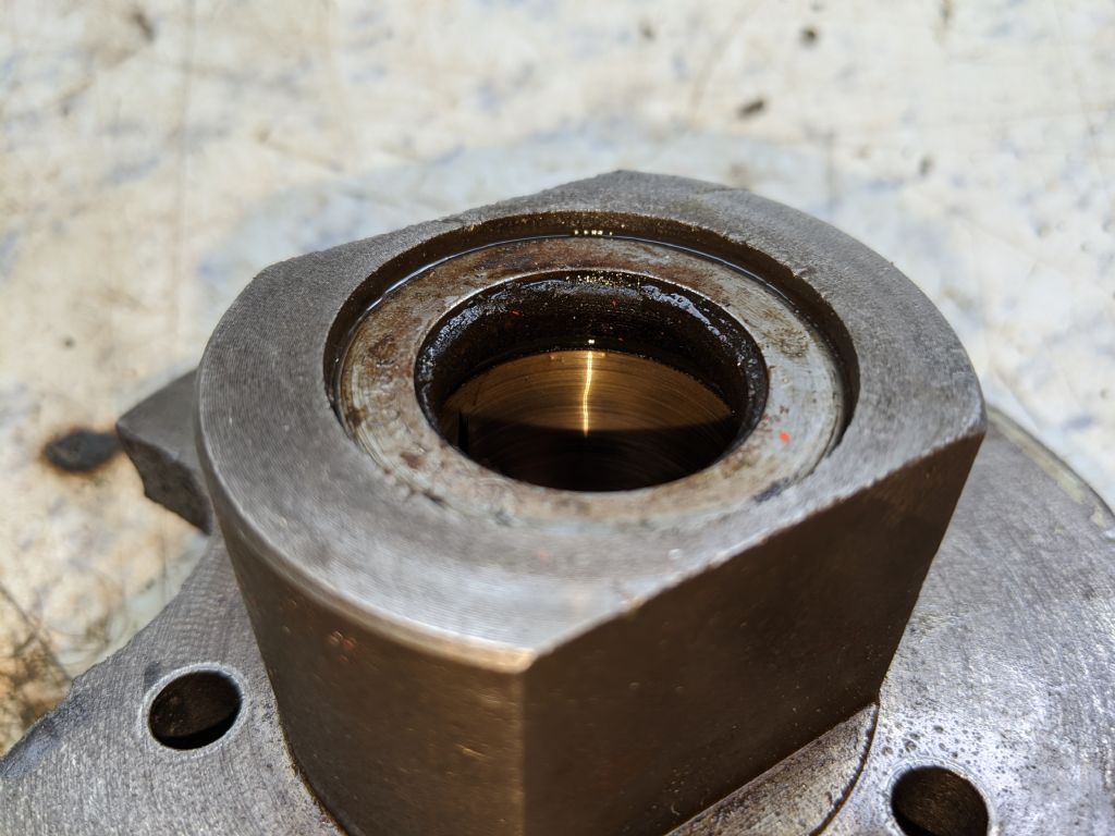

                                  I would recommend you go that route. Take the ID of the hole it fits into (in other words the OD of the seal) then the OD of the shaft it fits over and then the depth of the recess it fits in (in other words the thickness of the seal) then use the Timken oil seal selector to find what you need.
                                  You might have to look at the various types of seals listed as the D-d difference is quite a small value.

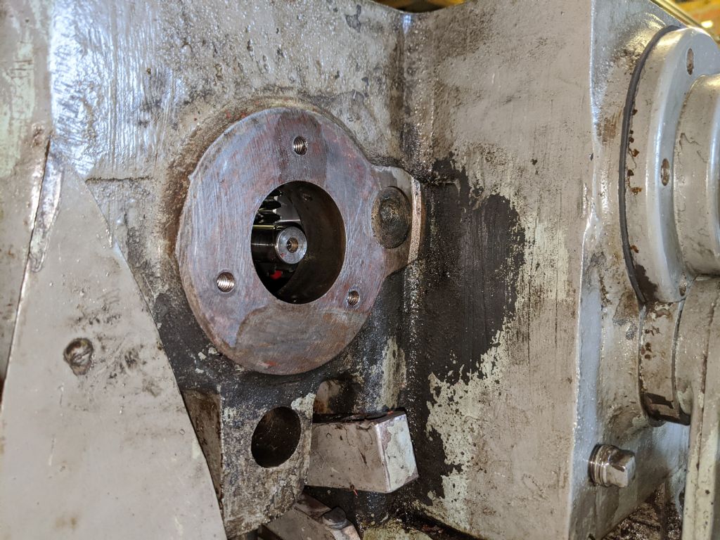

                                    For reference and possible assistance here are two photos of the seal in my lathe. It has the number 1621 stamped on it.

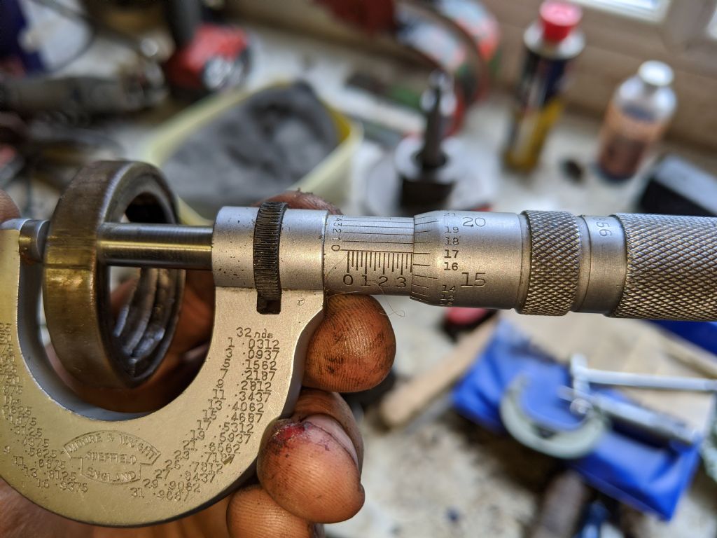

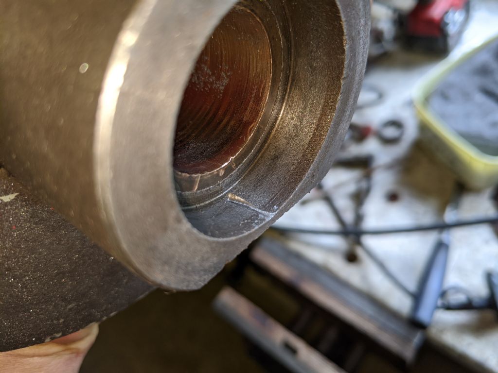

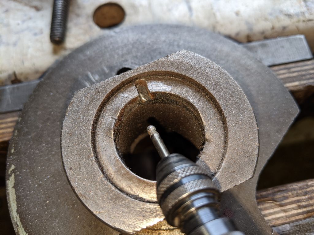

                                      I got the numbers from the old seal, 16210037. I'll just find a new one with the measurements I took

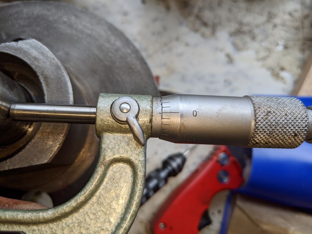

                                      Anyway. I started by trying to use a socket to push it out from the inside. This didn't work well as it just pushed out the leather and messed it up. Not a good start.
                                      Immediately that stumped me as I couldn't get any grip on it any way or tap it out from the inside as it wasnt working. Too tight in there. So I resorted to using my rotary tool to cut away one section of the seal to release the pressure and allow it to come out
                                      This worked quite well but I went a little too deep and took a lttle out of the bore, but that shouldn't make a difference really.

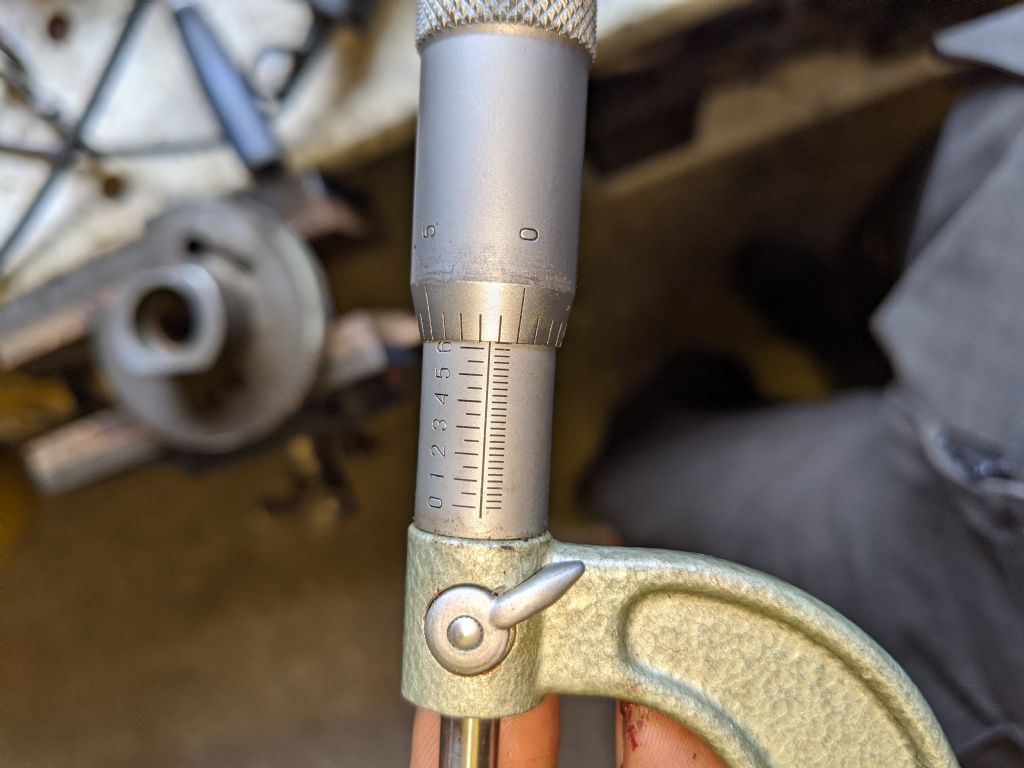

                                      Then I measured
                                      So we have
                                      OD=1625 1 5/8ths
                                      ID=1000 1 inch
                                      T=a bit more than 350, probably 3/8ths
                                      So, I'll find a standard size closest to that 1 5/8×1 5/8×3/8
                                      Like This
                                      Question is, do I want double lip or single lip? And whats the difference

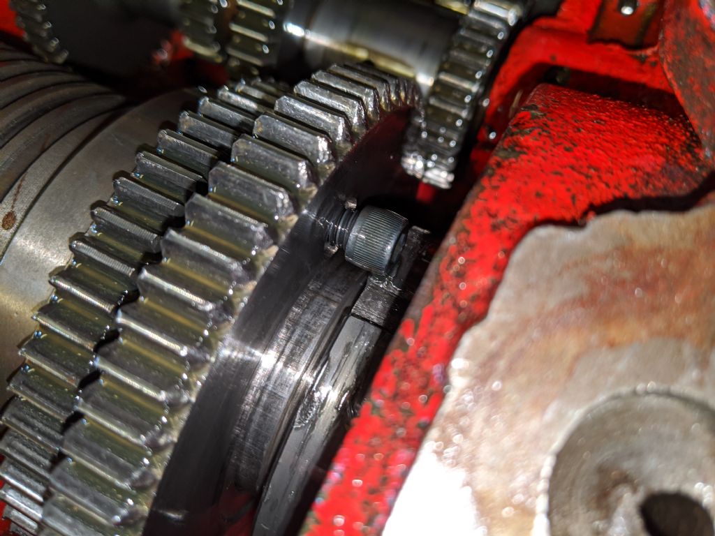

                                        I've remade the gasket and it fits perfectly. Undersized holes in the gasket to make it stick to the bolts and be easier to install

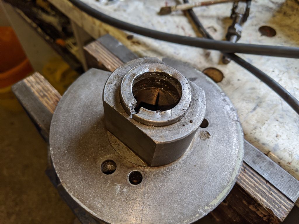

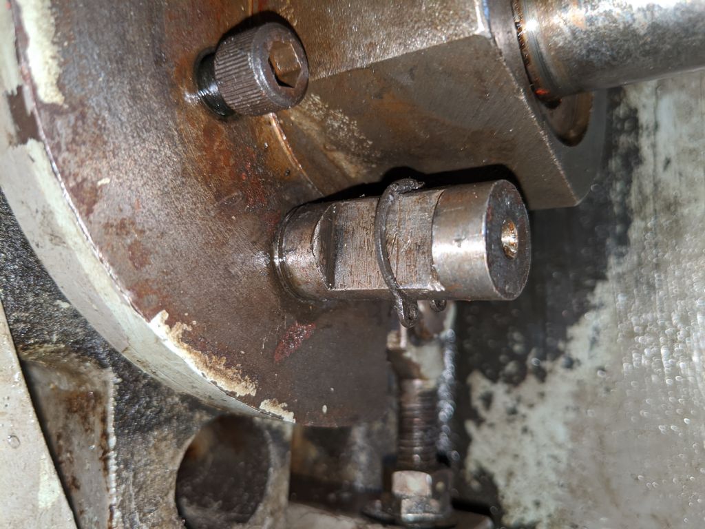

                                        Then I was playing in the headstock just moving the gear selector back and forth. I noticed it wouldn't move all the way. Turns out one of the bolts had come very loose! Very bad news. I must have not done them up tight enough when I put them back in. I've tightened them all very tight now, but its worried me quite a bit.

                                          You will have to get some RTV silicone gasket maker and fill the new cut and then hammer the seal in while the silicon is still wet. Next time use a oil seal removing tool or an old tack nail remover.
                                          Go for the double lip seal. One lip keeps the oil in and the other keeps the external grime out and away from the internal seal.
                                          When you install the seal do not smear the silicone around the circumference of the seal. Get some glycerine and smear the oil seal and then use a socket that just fits into the "hole" where the seal must go. You want to hit the seal on the lip that forms the OD of the seal. Anything less in diameter and you are going to bent the flat surface of the seal, destroying it. If you do not have such a socket, you will need to take a wood dowel and carefully punch around and around and around the circumference of the seal until it is seated. Seated is when it is about a hair's breath lower than the housing's flat external face surface. In addition oil the shaft very well before sliding the seal on. Otherwise the edge of the oil lip will bent over and will not seal.
                                                I would recommend you undo these again and use Locktite on the threads. Just get the correct number Locktite that can work in oil submerged conditions. Torque it to wet conditons specifications for mild steel bolts of the cap screw diameter. Your weakest material here is the gear with material strength which should be in the range of mild steel. You are doing engineering studies so you should know about material strengths by now! wink

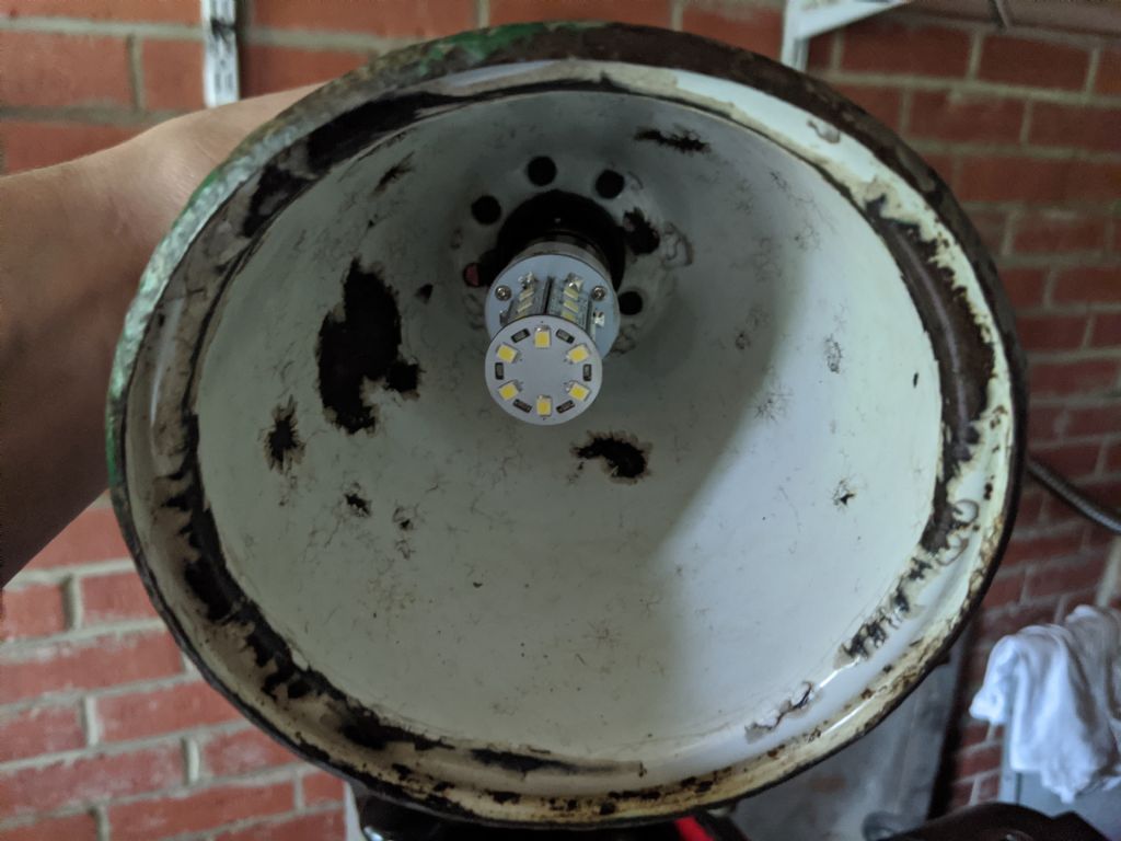

                                                    The second lightbulb arrived today, first one is definitely never showing up. So I went out and plugged it in and tried it. Nothing happened, no light, no flicker. How can I start to troubleshoot it? Wiring all seems right, but i'm getting nothing. It's a very cool little bulb with lots of LEDS
