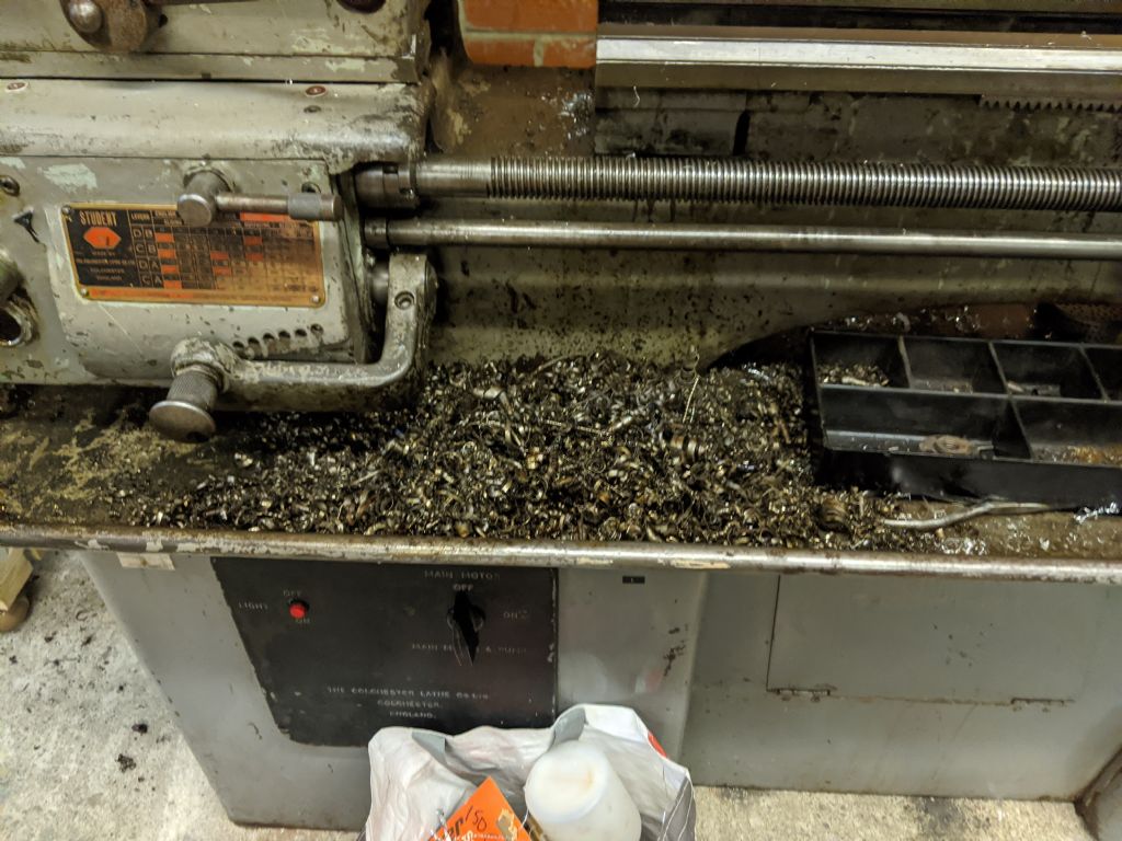

        On another note, it's 3 weeks since the light bulb was posted so I've emailed asking them to send another one out.

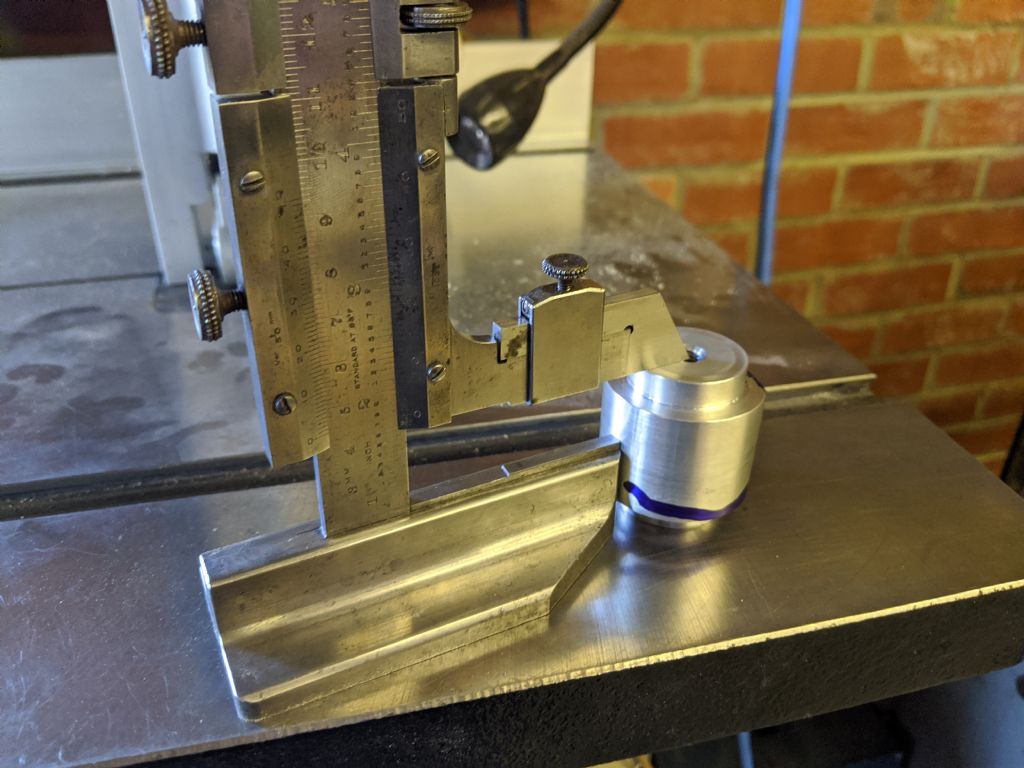

        Meanwhile, I've been enjoying putting the lathe to use. I'm definitely getting more comfortable using the machine and I'm trying to consider my accuracy.

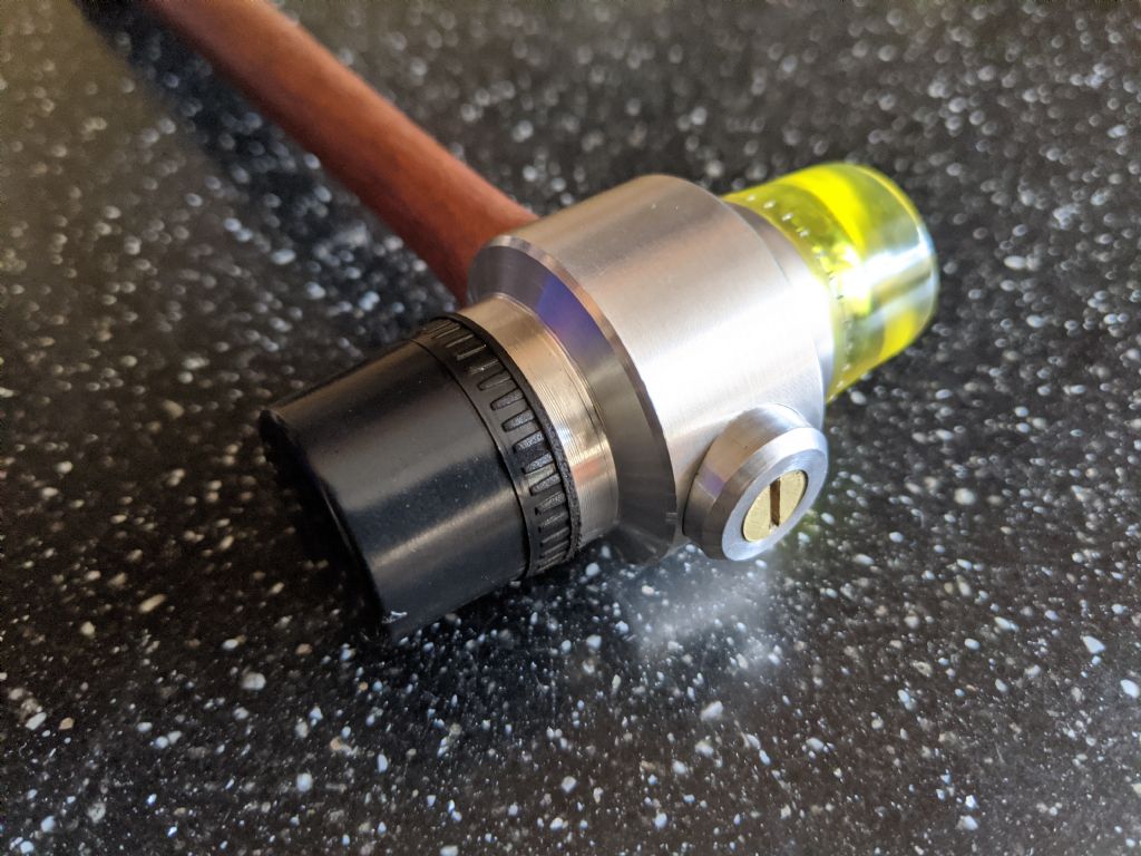

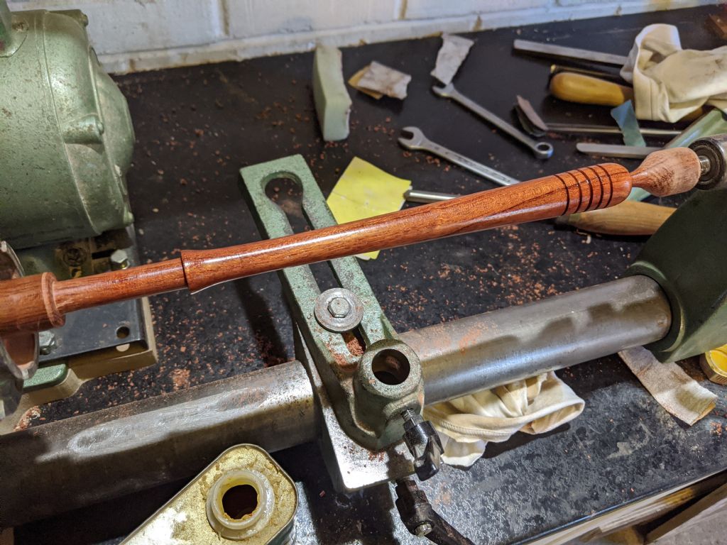

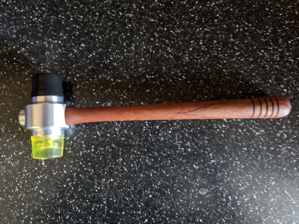

        I had two hammer ends lying around, so I thought I would put them to use and make myself a small mallet from some scrap aluminium I had. I think It turned out quite nicely, even with a wood turned Bubinga handle. Not a typical mallet but interesting for me to try some setups.
        When I was tidying up the machine after, I decided to stick my hand in one of the holes under the headstock. Turned out it was absolutely full of old swarf and grime. It's made me really want to take the headstock off and clean in there, but it seems a bit excessive. Anyway, it's interesting to see all the old chips, completely steel, no aluminium, and some of the swarf must have been at least 10mm depth of cut on the radius. So more clues that the machine has been used plenty. Surprisingly I didn't find any bolts in the hole, but I did pull out loads of shavings, I can't quite reach the bottom, but the machine is probably 1kg lighterlaugh

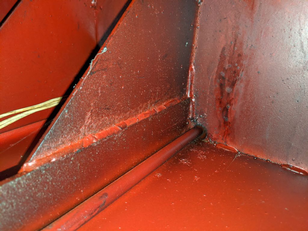

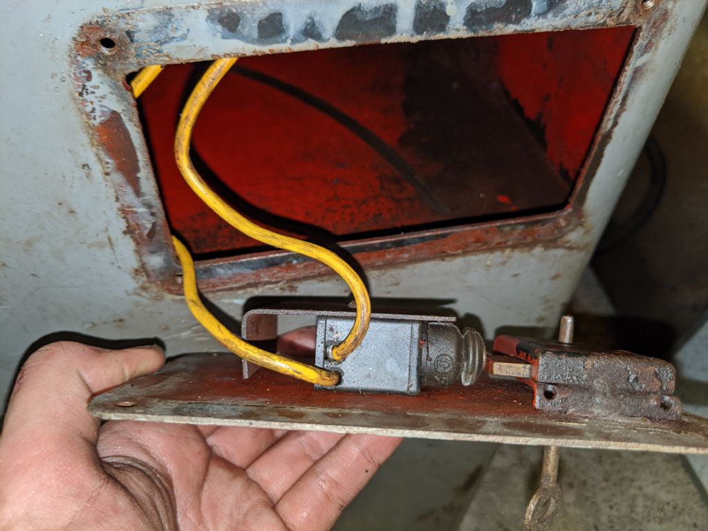

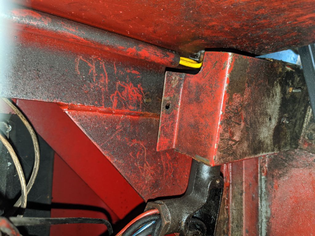

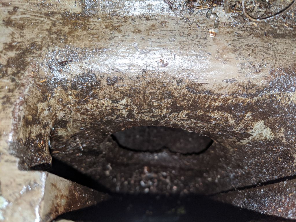

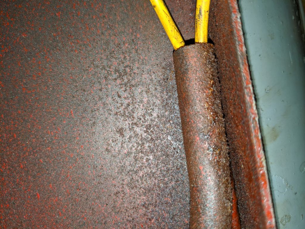

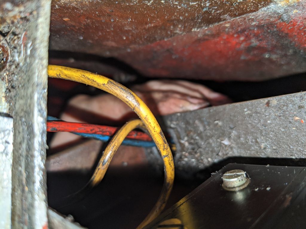

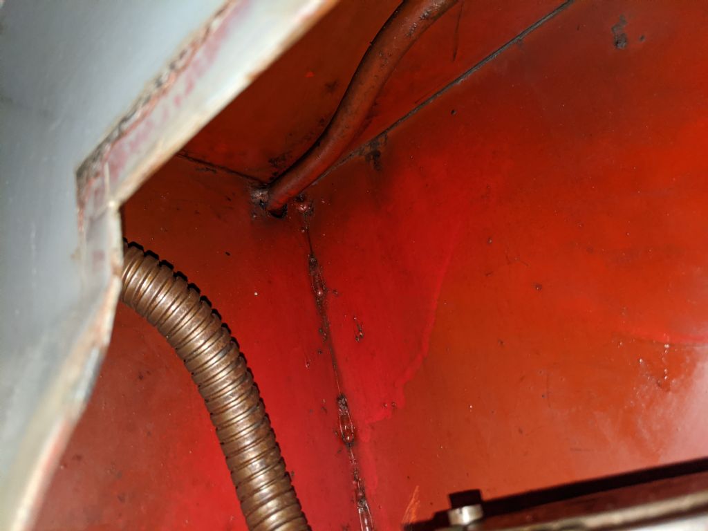

          Couldn't really get enough access for a video
          My wiring is exactly as Phil directed, so that diagram explains it all
          The red blue and yellow come from the contactor and overloads in their specified place, then all 3 wires head out the back and up to where the cover switch is. At this point, the yellow goes into and comes out of the cover safety switch

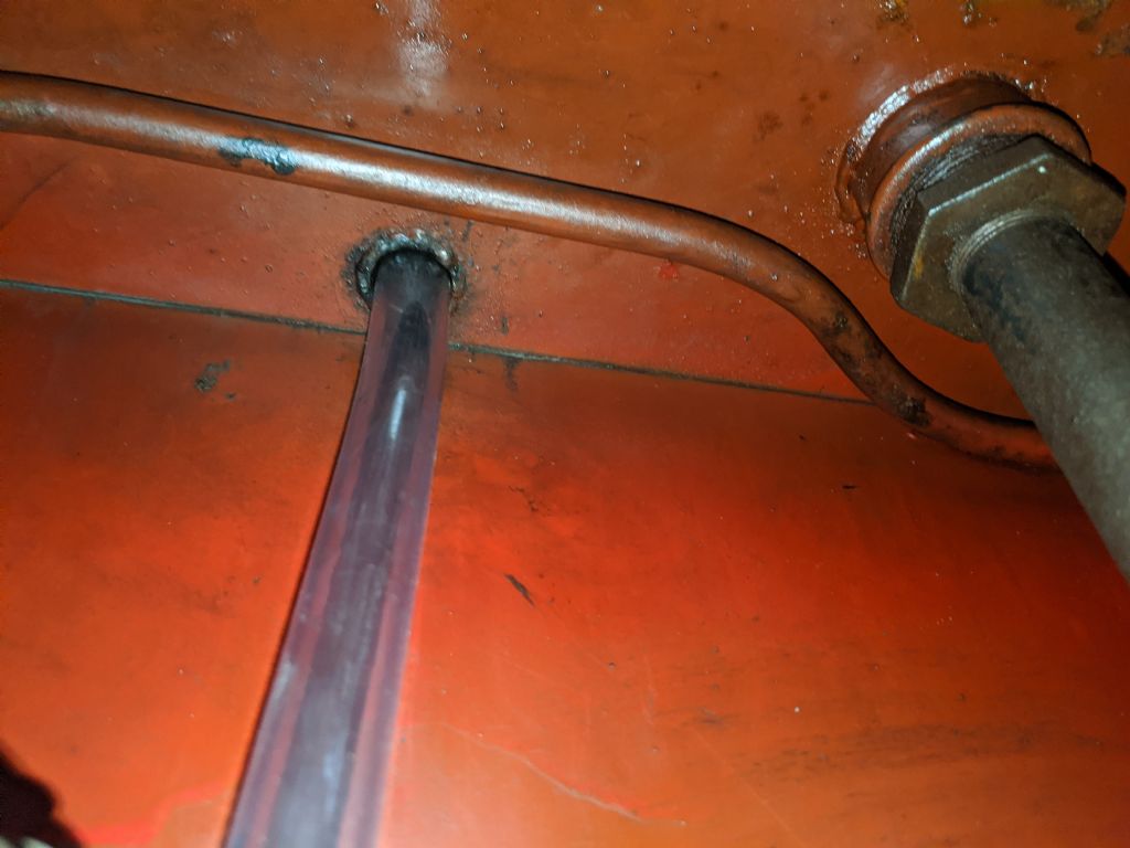

          The yellow then goes out of the switch and down the tube going through the lathe body
          Then it heads through into the coolant tank
          Orientation might be messed up, but i'm sure you can figure it out

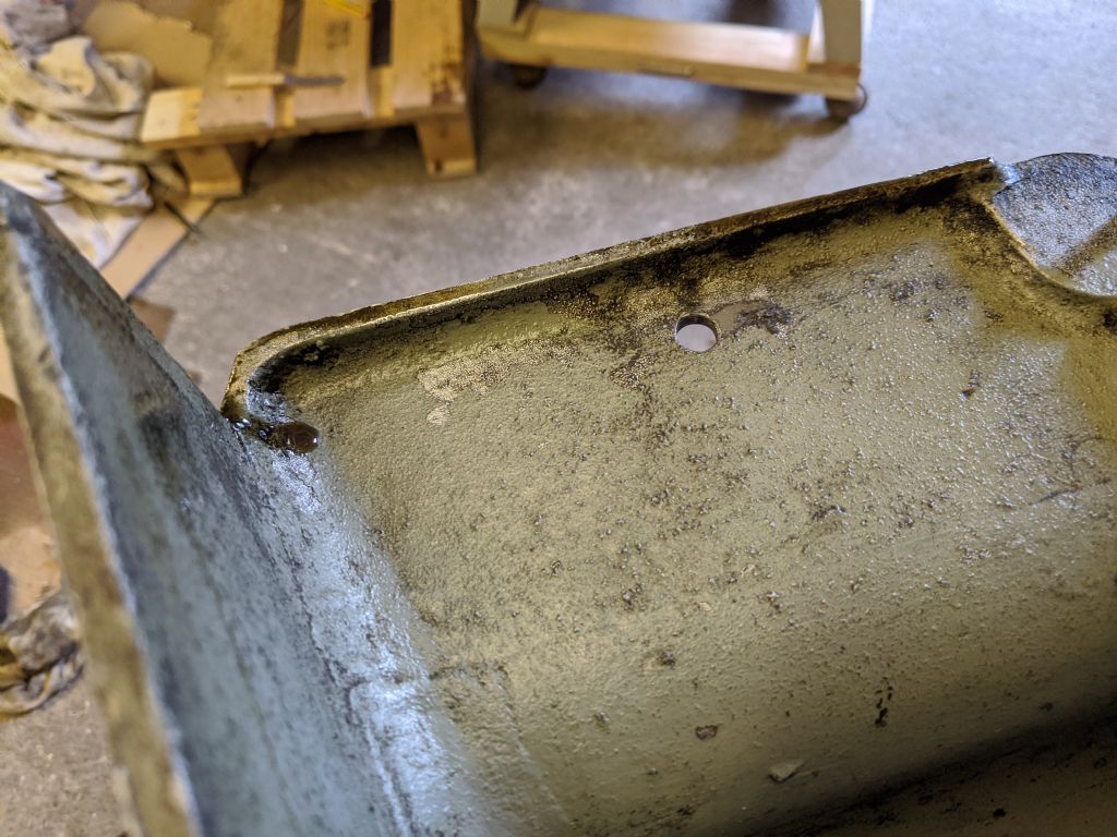

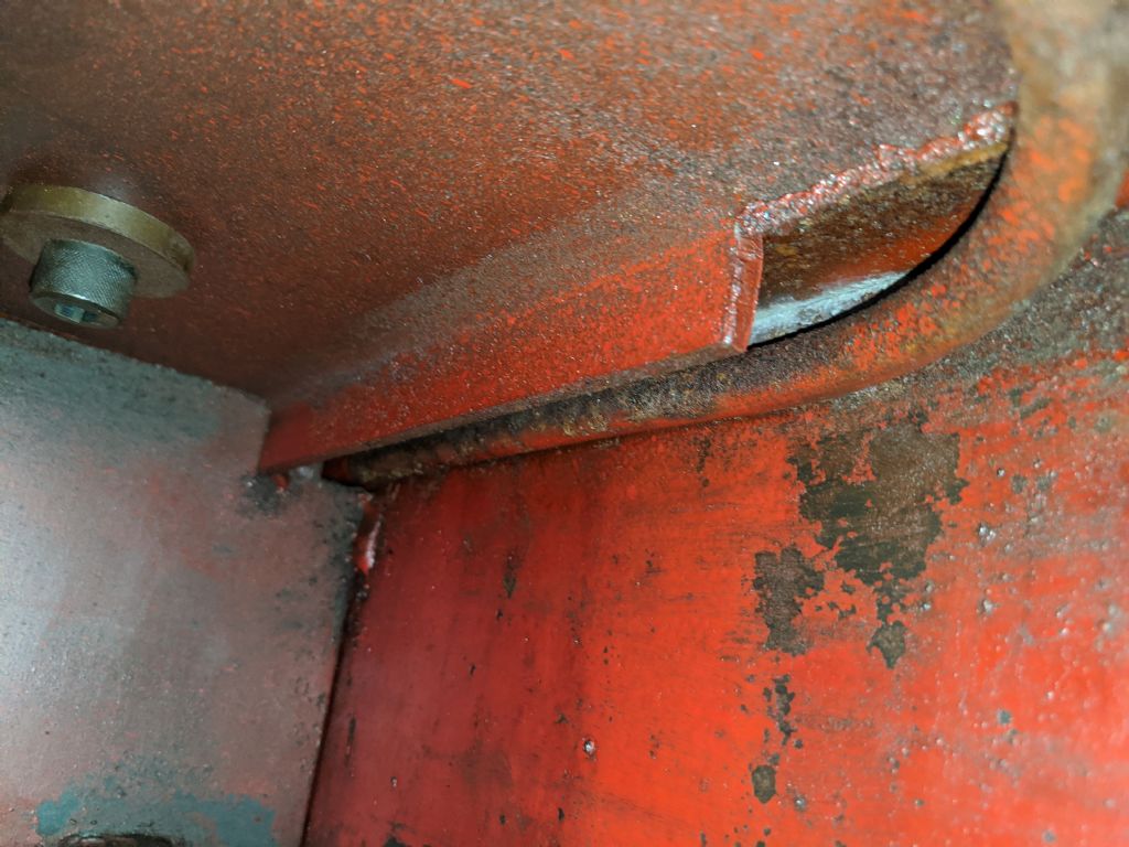

          In the coolant tank
          Then out into where the drawer is
          So the wire coming from the cover switch comes into the key switch, then heads straight back up along the tube, then up and into the limit switch.
          I hope that helps a bit, happy to answer any questions or get pictures for anything. Just ask. I'm very interested to see how you will wire yours up.

            I love your hammer. You are going to use that a lot when you are doing aluminium and copper work.

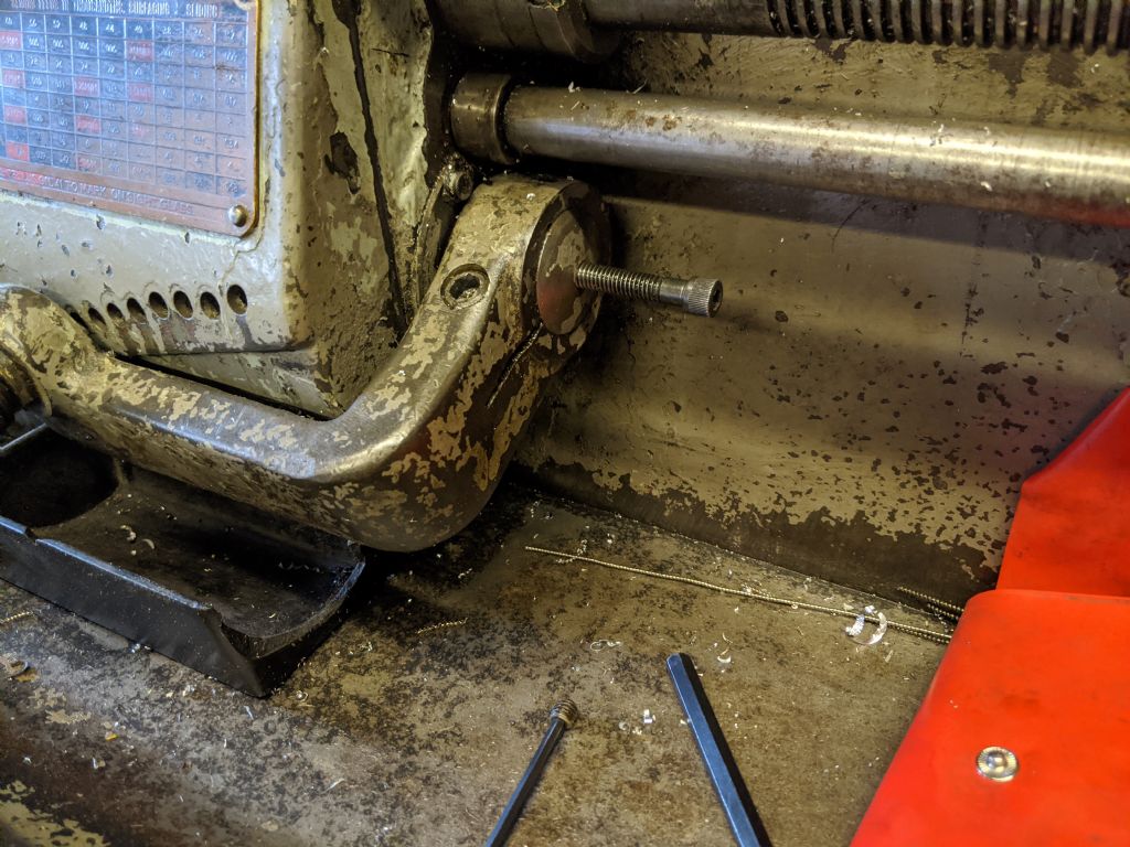

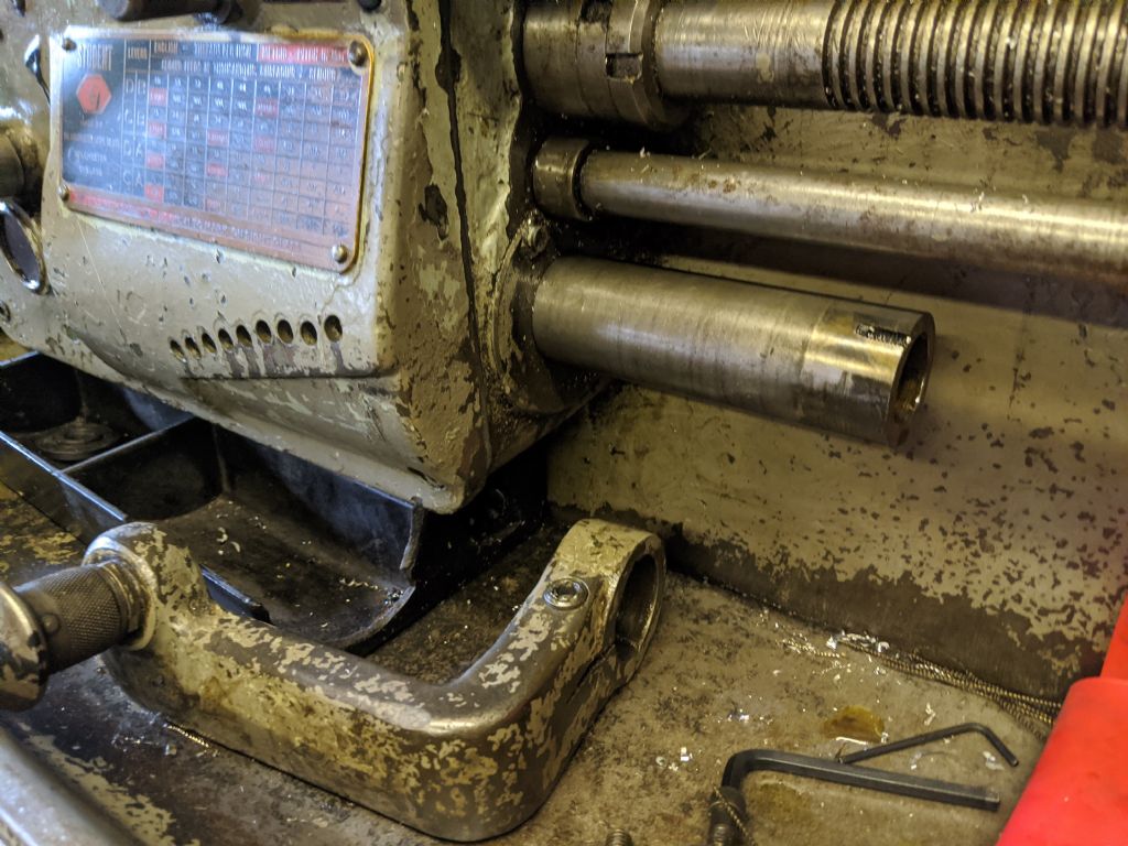

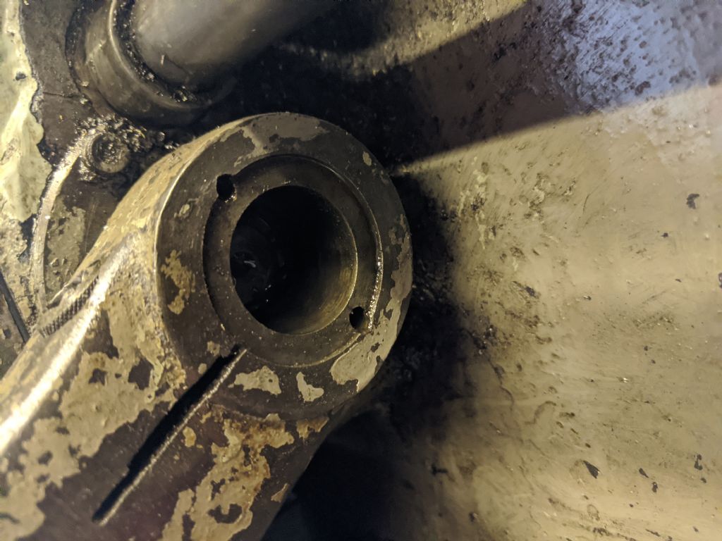

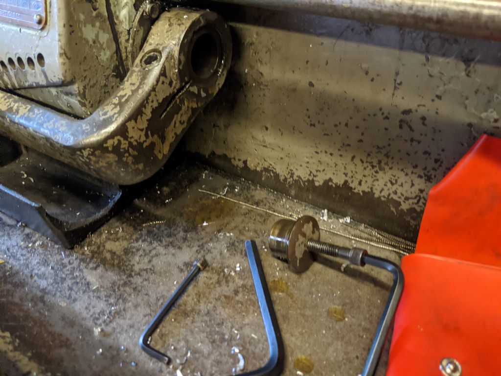

                                        Posted by Richard Kirkman 1 on 28/03/2020 16:21:38:
                                        As for the tumbler arm mystery, you tell me if I'm being blind, I can't see a dutch key!
                                        Looks like there's the starts of the threads on one the actual tumbler arm, but the shaft doesn't seem to have anything?
                                        Edited By Richard Kirkman 1 on 28/03/2020 16:28:10
                                        Richard, I figured this one out.
                                        You need to remove the grub screw in the cap. Then screw in one of the longer gearbox cover cap screws and then either use a puller or a slide hammer slide the cap of. It is almost a press fit but does slide out. In my case the entry to the hole was damaged, so I countersunk it a bit and retapped the thread.
                                        Then you remove the two revealed grub screws and the main big mamma of a cap screw in the arm and the arm slides off.
                                        #472003
                                        Phil Whitley
                                          @philwhitley94135
                                          A solution!! That explains a lot Richard!!
                                          Phil
                                          #472179
                                          Richard Kirkman 1
                                            @richardkirkman1

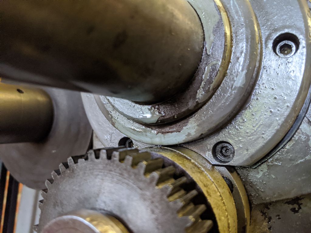

                                            Solution played out perfectly, except from the oil that leaked out of the end. It was much easier to dismantle than to reassemble, but still not too difficult. It would have been much easier if I had drained the change gear box first!
                                            Still, thanks a lot Herman, very helpful. The more info that's around, the more that it can help others too.
                                            I took it off, cleaned a little, then put it back together.. I didn't want to lose too much oil. But it did make me want to paint it.
                                            Still no LED bulb, 4 weeks since it was posted. I emailed and they've sent another one out last Monday, but now that's already late too! Looks like i'm going to be waiting a while.
                                            I need to replace the gasket at the back of the lathe where the brake is, since that's getting oil in and becoming ineffective.
                                            I also need to look at the other seals again, since i'm getting a bit of a leak out of the end of the main spindle. When I took this to pieces, it seemed like there were rings for a gasket of some sort and a space in the end cover for one too. Any thoughts on that?

                                              You can just see a drip below the spindle. It's not anything to worry about, I know, but if possible I'd like to sort it. Especially if there is a place for a gasket/seal

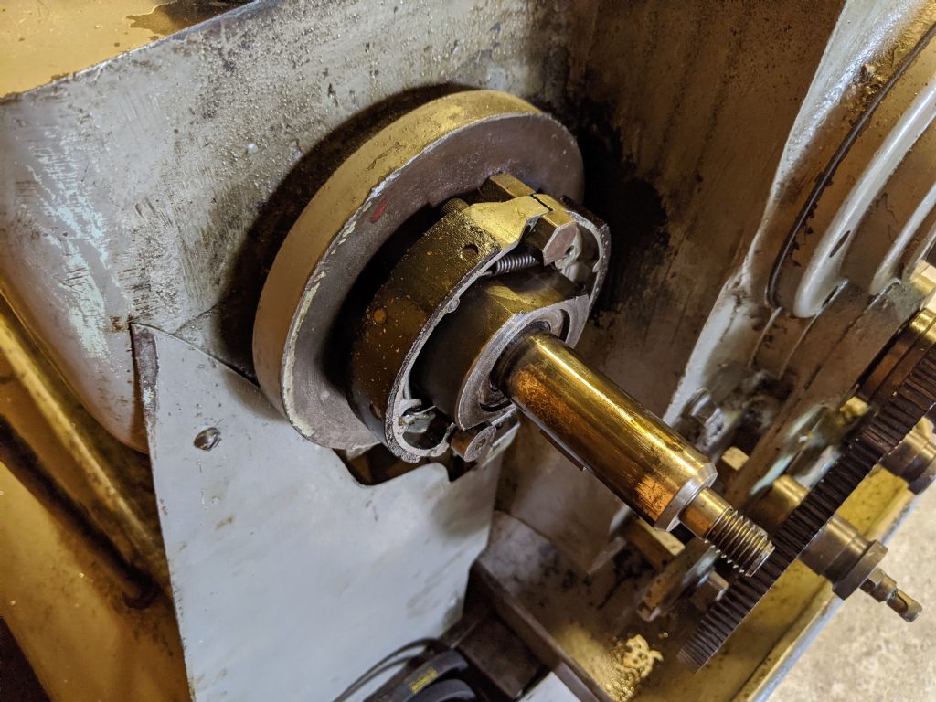

                                                Richard, does yours have the same type of all metal brake as Hermans does?
                                                Phil.
                                                #472202

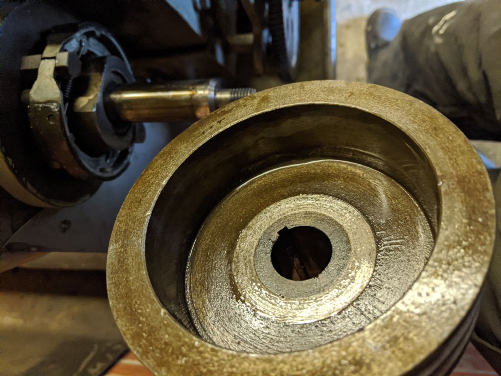

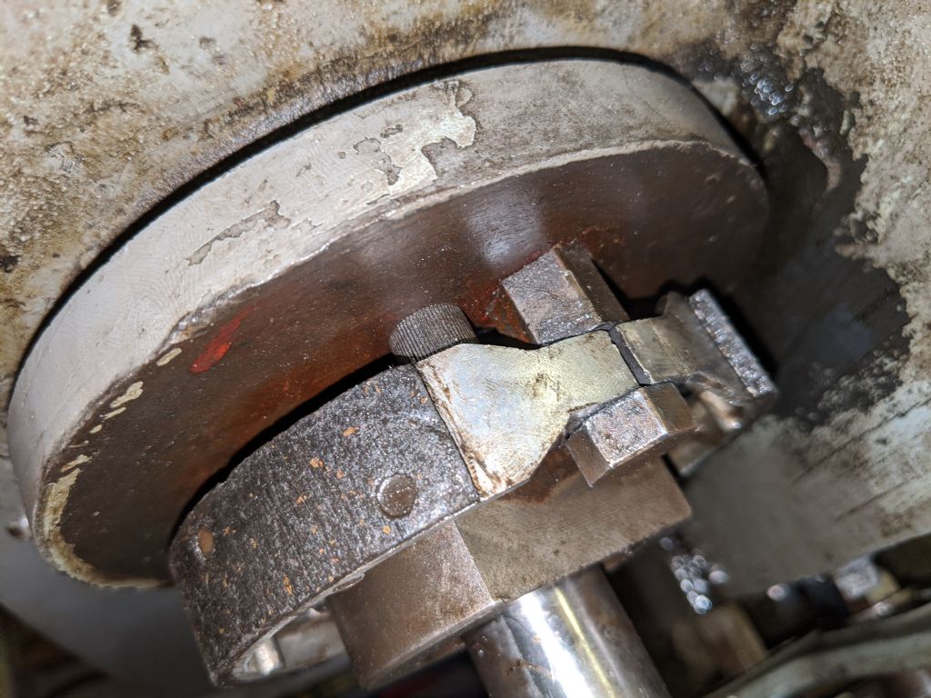

                                                Richard Kirkman 1
                                                  @richardkirkman1

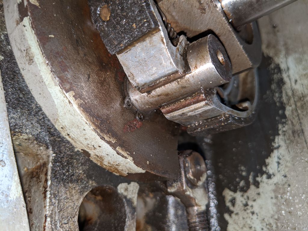

                                                  Phil, it is not the same as Hermans, I have material on mine.

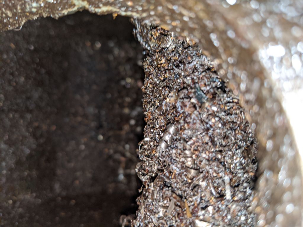

                                                  The leak is trickling down the lathe and pooling over time in the tray. You can just see a slight bit in here since I cleaned it the other day.
                                                  Leak is definitely coming from the inside of the brake
                                                  Covered in oil inside. Doesn't make for an effective brake, and makes my lathe messy!
                                                  This is where I get stuck. I need to remove the sprung bit, but I cannot seem to get it off. I tried taking out the bolt, but it doesn't feel quite right. There's a circlip on the shaft below that turns to push the brake out, but I don't see that helping disassembly yet. Any Ideas?

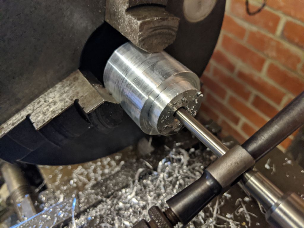

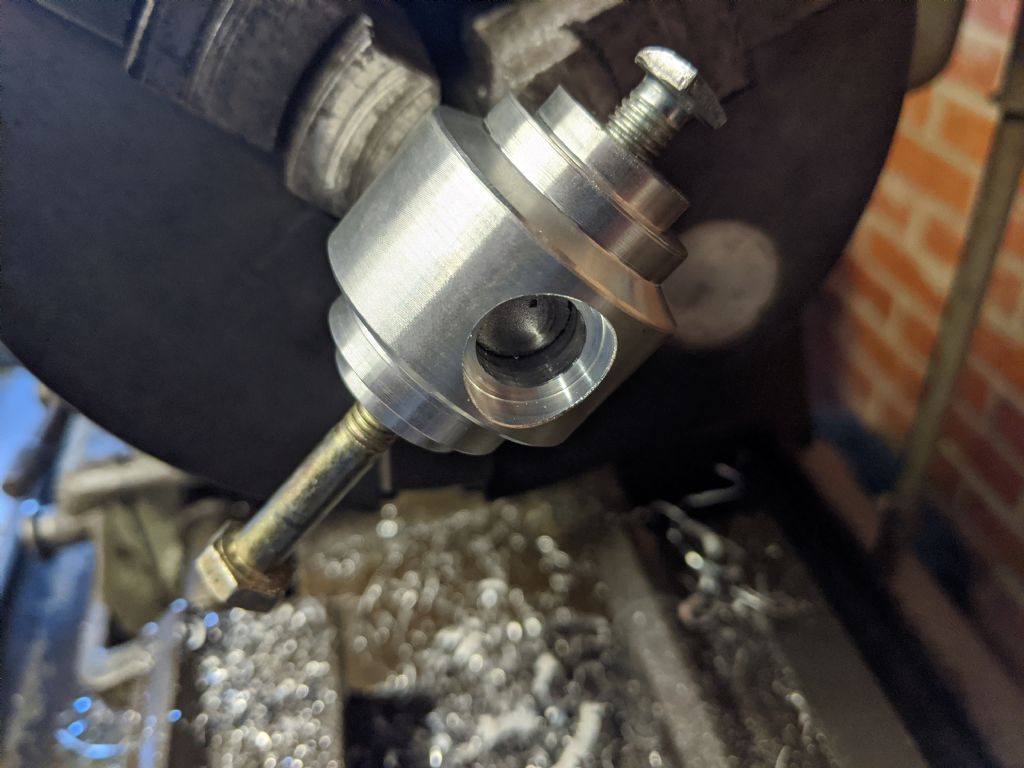

                                                  I've been working on making a tailstock die holder the past day or so. I've run out of material so I've ordered some steel from my local steel place. So I have a few days to stop this leaking
                                                  I also got myself a knurling tool, which arrived today, I tried it out and I'm very impressed, you get so much more grip on knurled parts. I think I'll have to knurl everything nowlaugh

                                                    I am glad you got the arm loose.
                                                    Took me two days to get the speed change gear off the handle selector shaft and then another three hours to fix it up. I ended up making a puller.
                                                    The gear was knocked oval, the shaft had hammer dings on it that created edges standing out from the shaft and the Woodruff key was knocked about so badly that it was stuck solid. The key took about an hour to flatten on a diamond plate.
                                                    All fixed, sliding and fitting as it should.

                                                    Phil Whitley
                                                      @philwhitley94135
                                                      Richard, you cant do with oil leaking into the brake drum like that, there is a seal in the flanged bearing (which is actually a bush), take of the brake shoes, and remove the allen screw or screws, depending on which it is, seems like on the early, there is one, but three on the later, and the flange should come off. there appears to be a cork gasket behind it.  the circlip only hold the pivoting cam for the brake into the backplate. Have a look on the parts diagrams on the manuals, that makes it easier to see.
                                                      Phil
